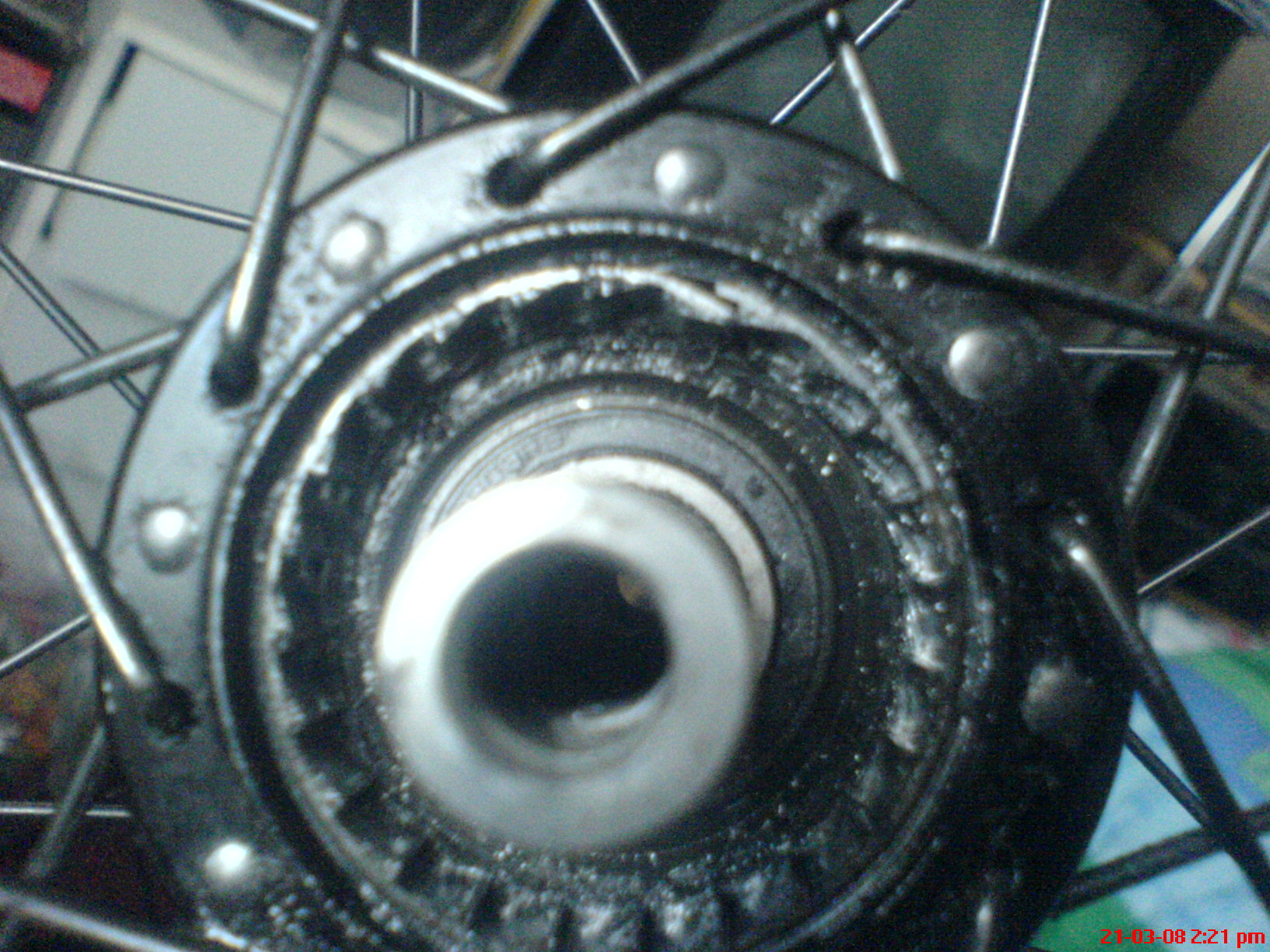

I'm not to sure what is wrong with my hub, i think the free hub body has gone but am still not sure. There was a huge bang when i kicked to do a gap and there was no engagement, now it has turned in to a fixed hub, i can pedal backwards and forwards but it wont roll and when it does it makes a strange noise and jams up. Is it my free hub body?
Is it an '06? I guess theres no obvious massive crack in the hub?
My '07 ratchet ring stripped recently, meaning it just spun inside the hubshell. There was no bang though.
And Hope's warrenty is still amazing, i've sent both my cracked '06 and stripped '07 back and they've replaced them no problems.
Take the non driveside little end cap thing off and wack the axel that should work.
it cant be a the rachet ring strippedbecause then it would just spin not stay locked like it is. ANd im guessing he would have noticed a big crack if it was the hubshell. So it can only be the internals.

The same thing happend to mine on wednesday night! I havnt had a look at mine yet to see whats up with it yet but i sure hope that the rachets havnt broke like yours!
Ive had mine less then 6 months, surly the rachets are ment to last longer than that? (if mine are the rachets) could I get a new one from hope? whats the warranty like with hope?

The warranty should be quite good im guessing. But I think they do replacements and services for a small fee or even free, but you would have to pay for postage. I've had my hub about 6 months and I have the receipt to prove it somewhere lol.
The ratchet rings are screwed in.
I managed to put so much force on it it stripped itself which is nice.
If you just send it back to them with a note explaining whats happened, how old the hub is and your address, they should send a new one back to you.
