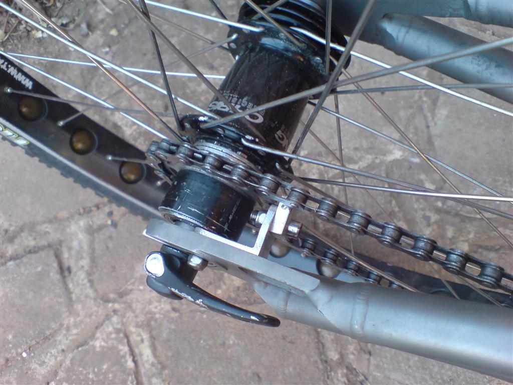

My home made tensioner is bolted directly to the frame through the mech hanger bolt (using an M4 countersunk allen screw so it doesnt rub on the freehub), it never moves and stays on the frame when you take the wheel out.
No reason why you shouldnt be able to put a 74k one in the same place with a bit of fiddling with washers :)
Looks something like this....
edit1: the actual spring bit isnt a spoke anymore, now got half a hacksaw blade bolted either side of the square aluminium block and a tyre lever taped between the 2 to make a leaf spring.
edit2: oh yeah, chris king hub with shimano QR.
Edited by forteh
