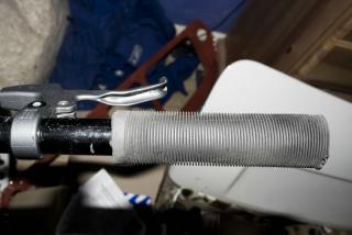

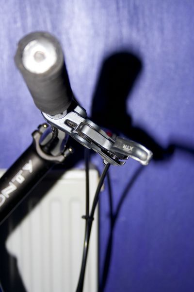

Anyway, I took a quick picture of my front brake lever from a side profile, so you can see the angle I like best.
I have to have both levers at the same angle, otherwise it feels too weird for me! The angle I have them at usually makes them sit flat (90degrees..ish) when I'm on the backwheel, which feels most comfortable for me.
I have them sat quite far away from the ends of the grips, as I have large hands, plus I only ever use my index fingers on the end of the levers, so I get the best leverage this way.
I took a picture to show you the gap between the lever and the grip:
I don't have much pull on the levers until the brakes lock, if they pull back too far, then it doesn't feel right to me? Which can be a pain as my brakes are always close to rubbing! So a slight buckle and my pads rub!
I think that's everything you need? Feel free to ask me if you need more info'!
