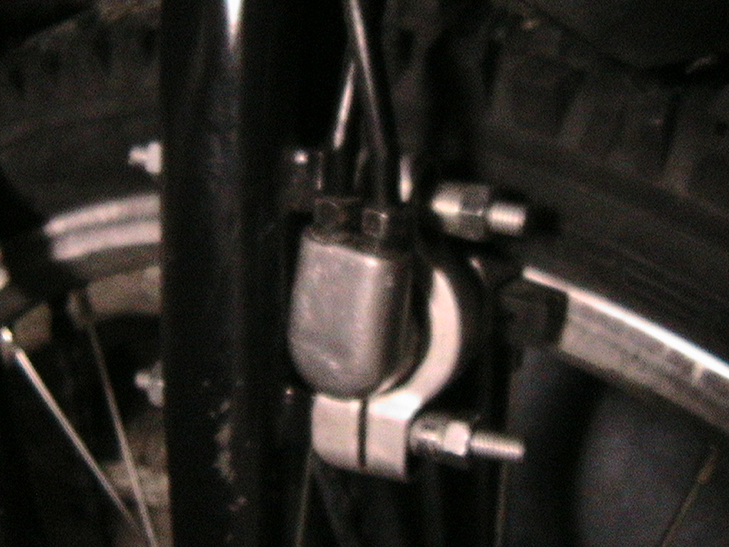

As said helicoil :), but as for a tempory bodge - one of the bolts stripped on my mates bike, so he went and got a cable tye and then he fastened it around the mount where it was loose it worked quite well for the day :) Remember my mates was only one bolt that had stripped.
Adam (Y)
Trialschallenger how did you do that? Looks interesting... Just drilled right through the frame and then threaded?
