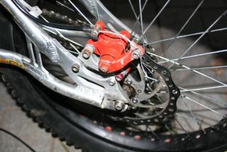

If you look at the brake currently on the bike, you will see that it the bolts go 90 degrees to the actual brake pads (or where the brake disk goes). On the BB5's the adapter/fixing thing goes inline with the brake pads (or where the brake disk goes).

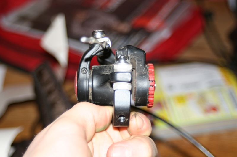

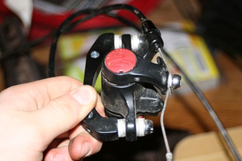

I didn't explain it very well so here are some photos :
Picture 1) I am holding it as it would be mounted onto the frame. As you can see the gap for the disk brake doesn't line up.
Picture 2) This is how it should look when fitted to the bike (or similar). It is like I need a 90 degree adapter?

use the adapter from the old caliper ....
I'm sure that the adapter goes the same was as the frame, so it doesn't turn it 90 degrees, I will take the old brake off and have a look.
Thanks!
Thanks!

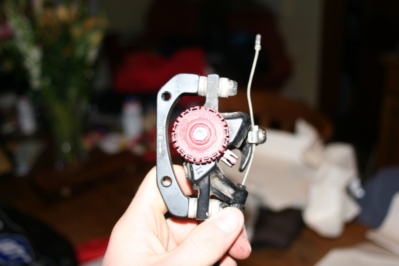

Look at the 1st picture on Post 19!
Thanks
Avid brakes are Post mount, but come with adapters that change it to IS mount. - Which is what's on the brake now!
So the caliper is different to your old one, but with the adapter in place, it should just bolt straight onto the frame as it is now? - Can't quite get my head around what the problem is?
