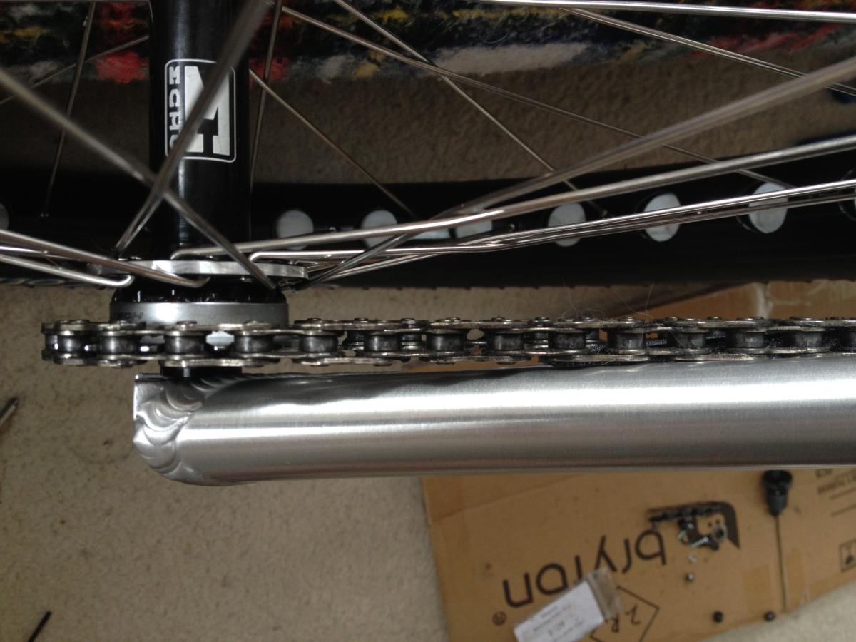

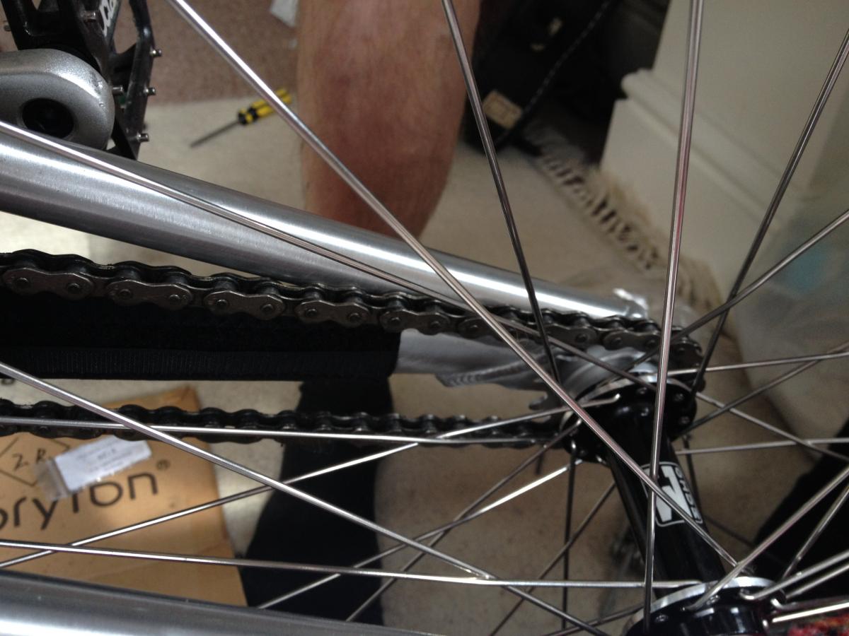

Hi all,
Have a look at the pics attached. Just finished building my Echo 24 and noticed the chain is brushing up against the inside of the chainstay. Echo Hub with TT 14t sprocket rear, TT forged cranks with Tarty bashring and Try-all freewheel up front. Everything looks right, chain line is perfect but this is not!
Am I doing something wrong, do I need a thinner chain, does the chain need a bit of slack, has anyone else had this issue?
Ta!
Oli
post-4055-0-68997500-1367592243_thumb.jp
post-4055-0-41234500-1367592269_thumb.jp
buy a sprocket with teeth in the centre, or turn your sprocket around so the teeth are closer to the spokes#
looking at the picture though, if you turn the sprocket around the chain will rub on the spokes :(
Edited by stunt man t
I had this exact same problem when i built my echo a few weeks ago... looks like yu got all the same parts that i have aswell!
all i had to do in the end was turn my rear sprocket around and it worked perfectly, and i still have got a little bit of clearance between the spokes and the chain :-)
believe me i was so frustrated trying to work it out lol, ever since i turned the sprocket round i havent had a problem since
Thanks to everyone for the answers! Have ordered a centre-toothed sprocket and a 3/32 chain + Tarty are happy to the return of the sprocket. Gutted I can't ride my new set up for the bank holiday weekend but always a good to do it right rather than bodge it!
Ta
Oli
