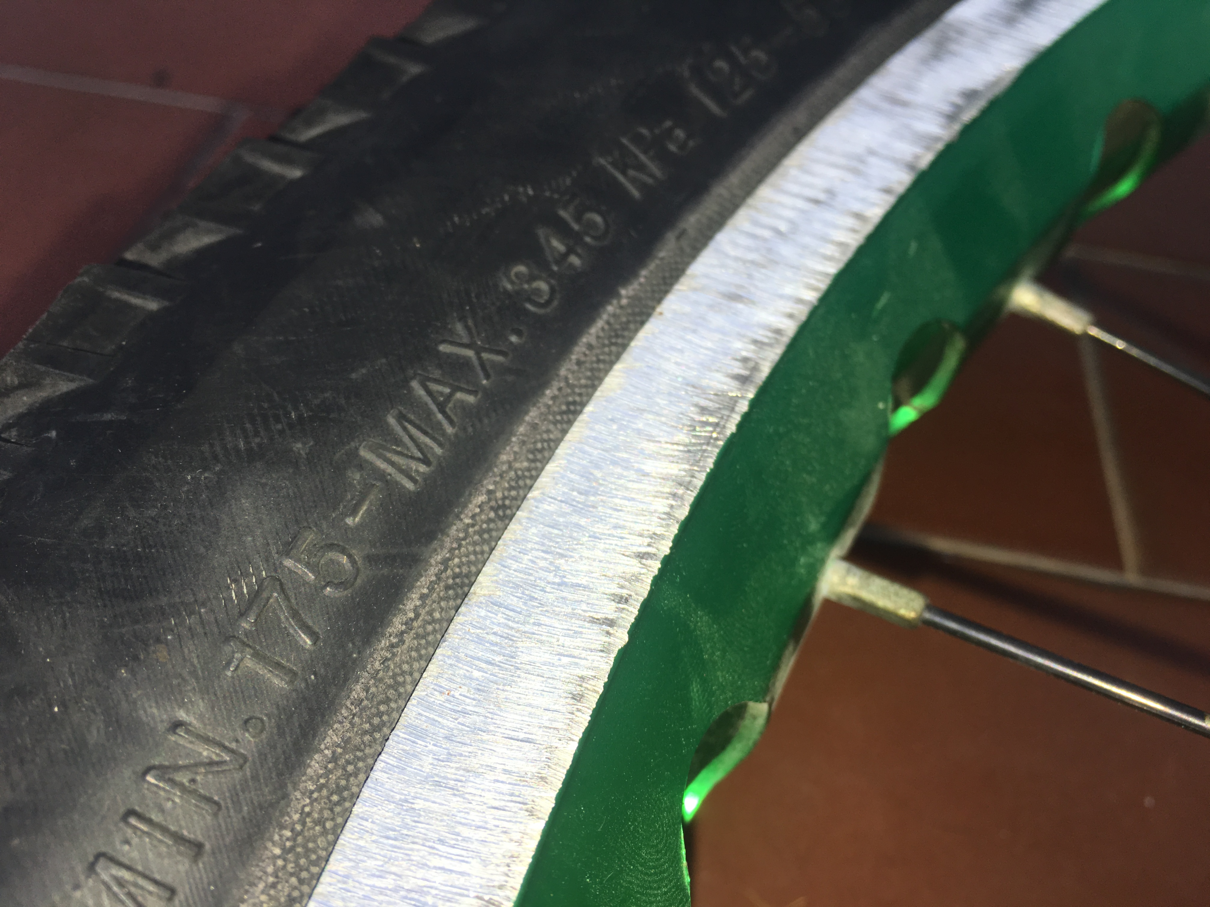

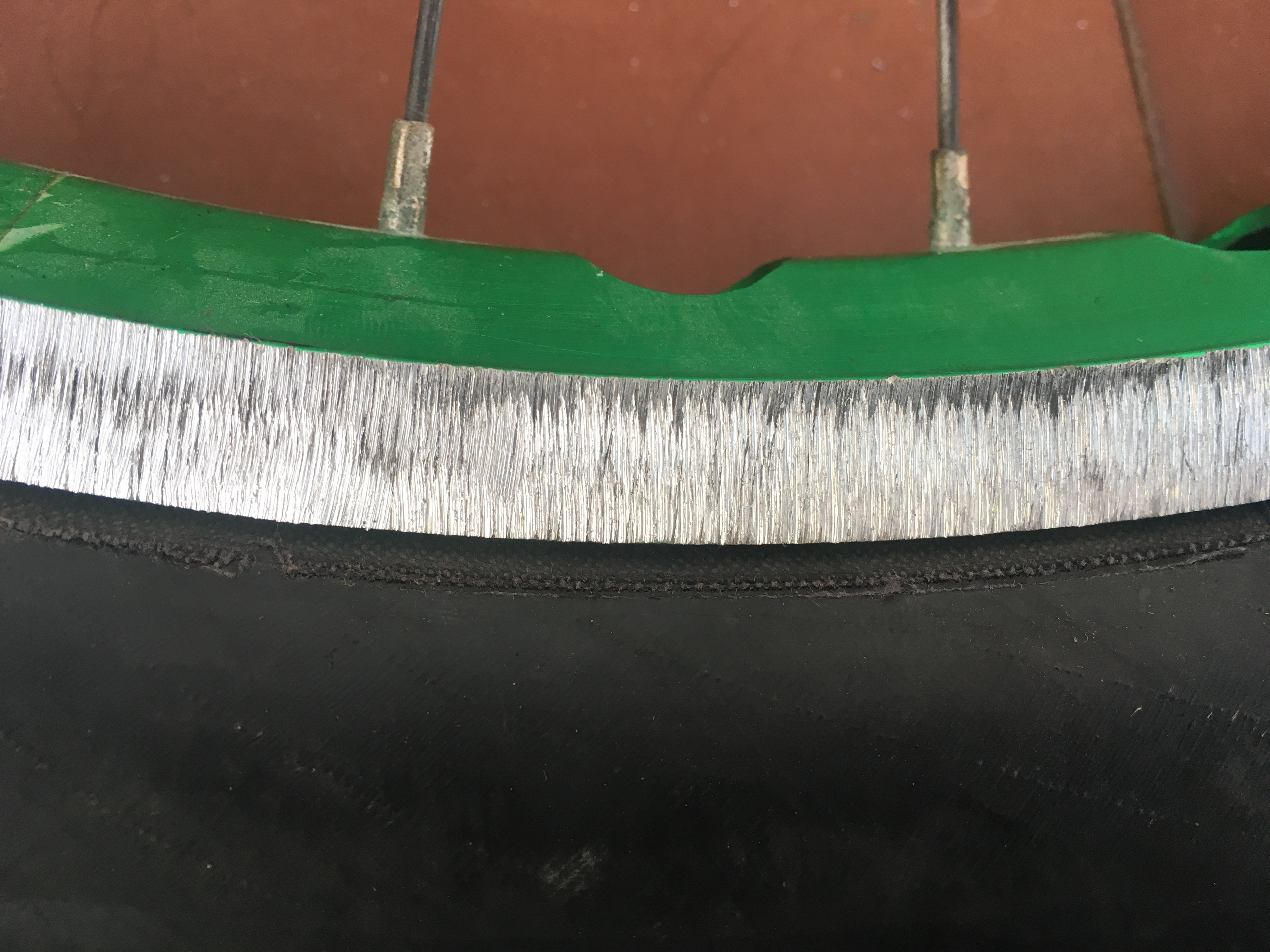

My first grind:
Some zones are fine, others not so great.
So from my experience:
Dont skip the numer 1 rule - use a brand new disk. Mine was a bit used, And since i was afraid of damaging the rim I used shallow angle resulting in shallow grind, in the beginning almost polishing the rim.
Seems harder to revive an old grind than doing it on a fresh rim.
