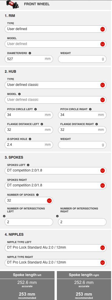

Doesn't seem to be right. My spokes for the front are way too long. I took a ruler and measured it. Came out around 527/520.

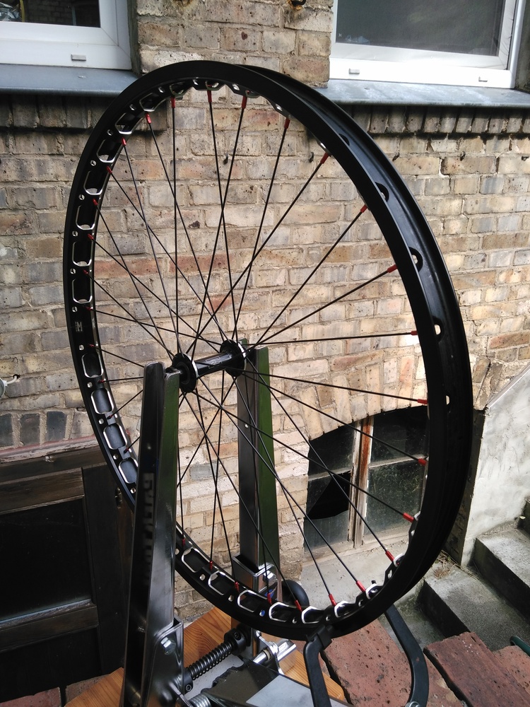

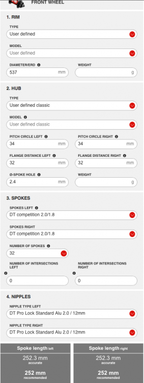

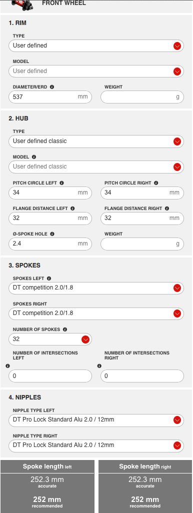

I've got the Echo TR Hub and said rim. Spokes are 253 for sure. I tried to lace it up radially and the spokes were way too long (not only 1mm). Laced the wheel differently now (2crosses) and it works perfectly. If it were 537 laced with 2 crosses the spokes should have 258mm. I think I'd notice the difference of 5mm.
Edit: I just measured the rims with a flexible tape measure. For the front I end up having 530mm (532mm using this method for the rear 522mm (524 using this method) mm.

Well... this is the front wheel and when calculating with an ERD of 532mm I have to take 255mm spokes (crossed twice). I did this and they fit perfectly. Even better than the 253mm spokes I used before. I think the rims are from 2009 though.
edit: If I put the front onto the rear rim there's about a 4mm difference the latter being narrower. This seems about right according to my measurements. I may have gotten a very rare batch.
