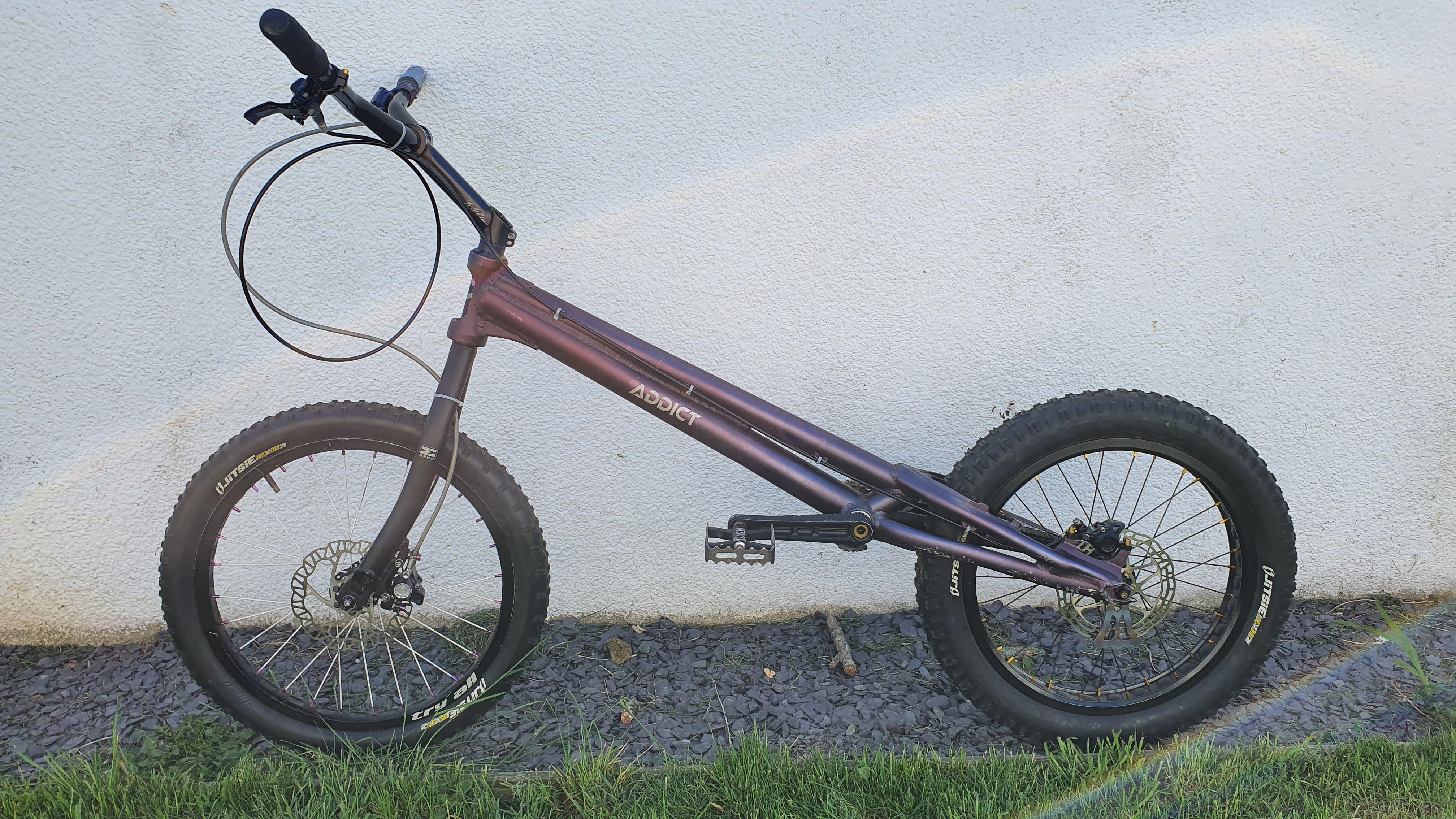

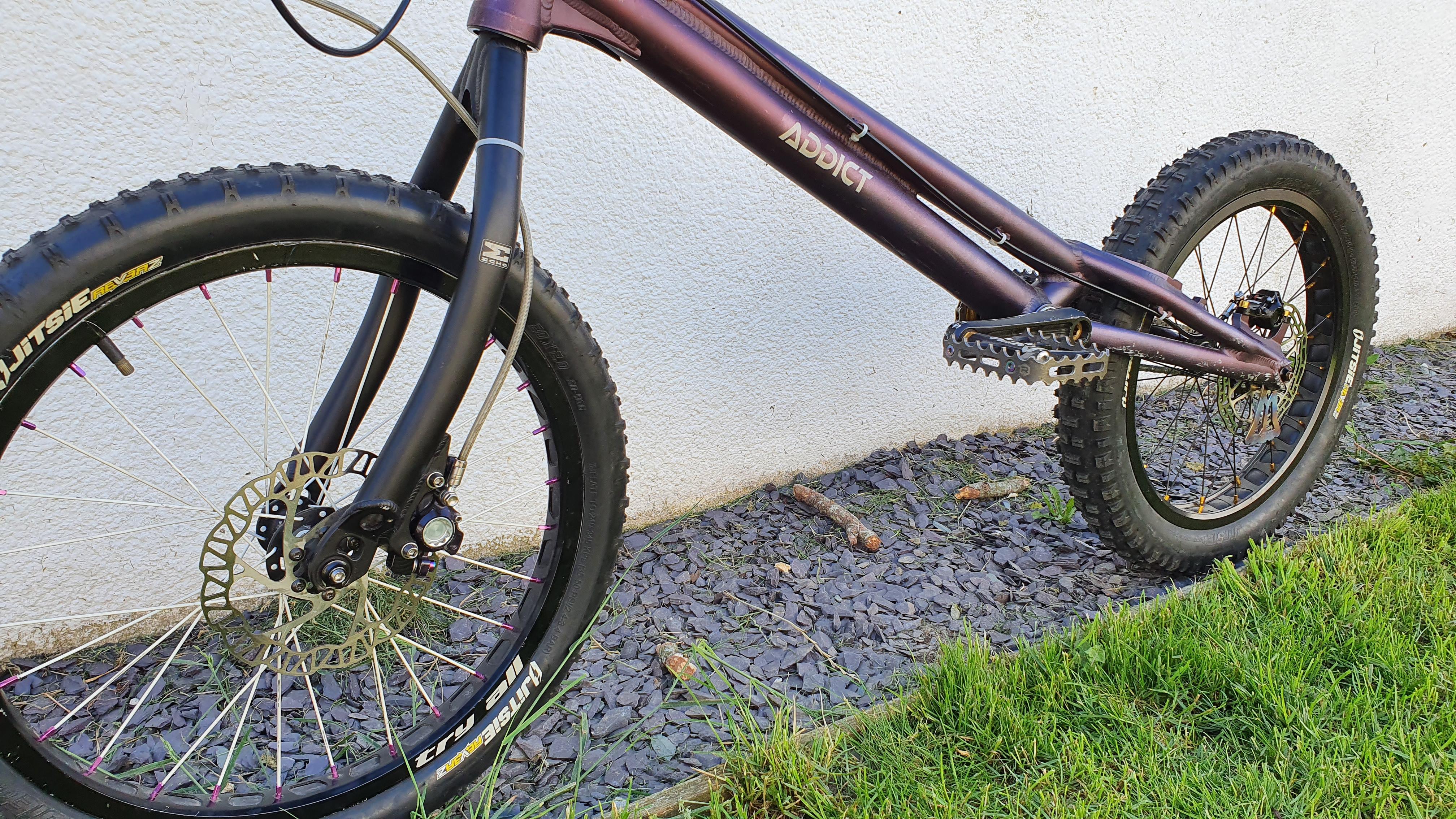

Dragged it out of the garage for the first time in 3 years, still rides lovely and doesn't weight alot... 7.3kgs ish
Addict custom 20" frame
Updated: Maestro carbon forks
Hope Trial Zone rear, Magura HS33 front brake
Every bolt is Ti, Echo SL Ti FW, Brother CNC stem, Jitsie carbon bars, Onza Tako pedals, ti axles and ti cages. Ti disc guard.

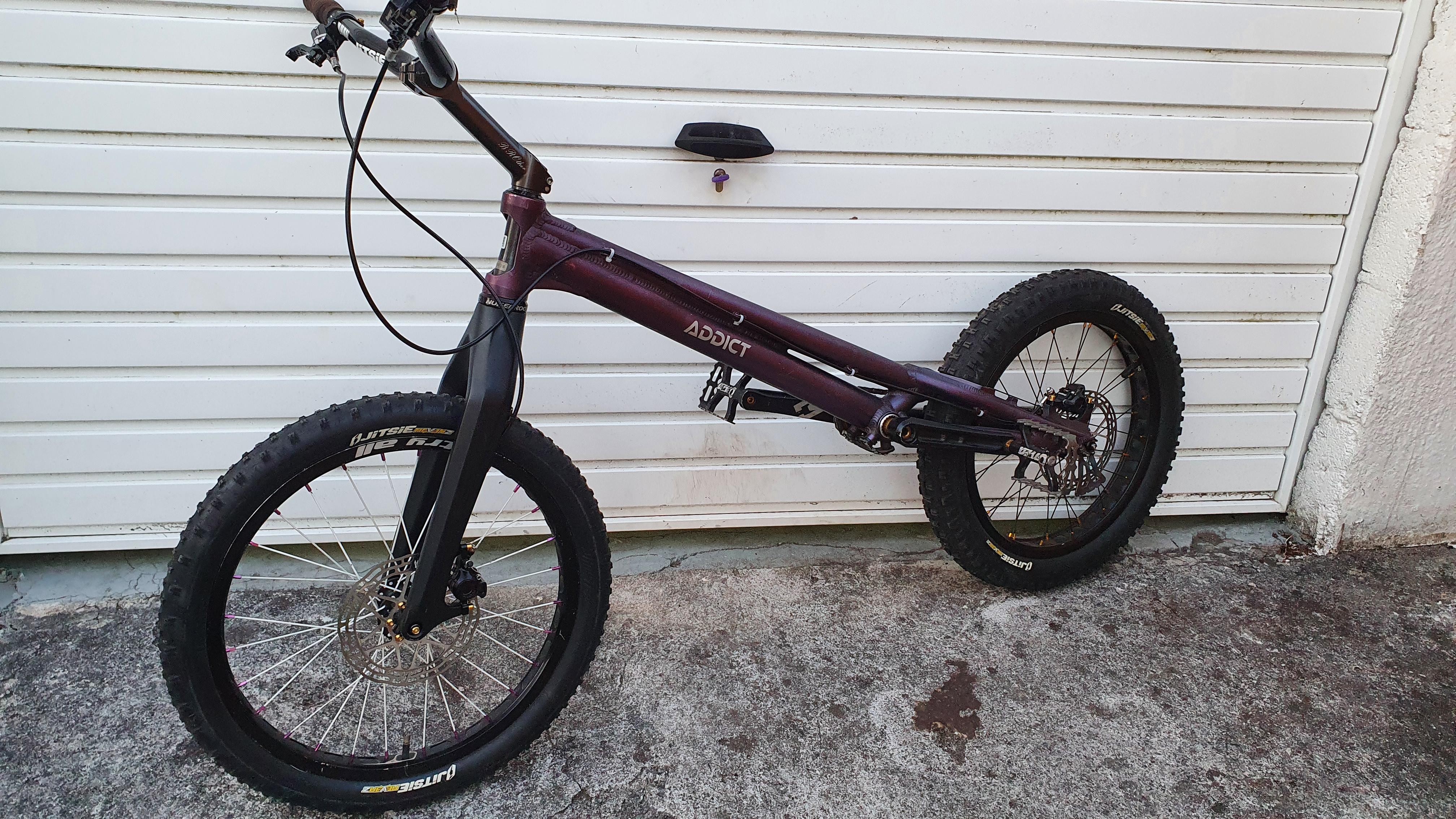

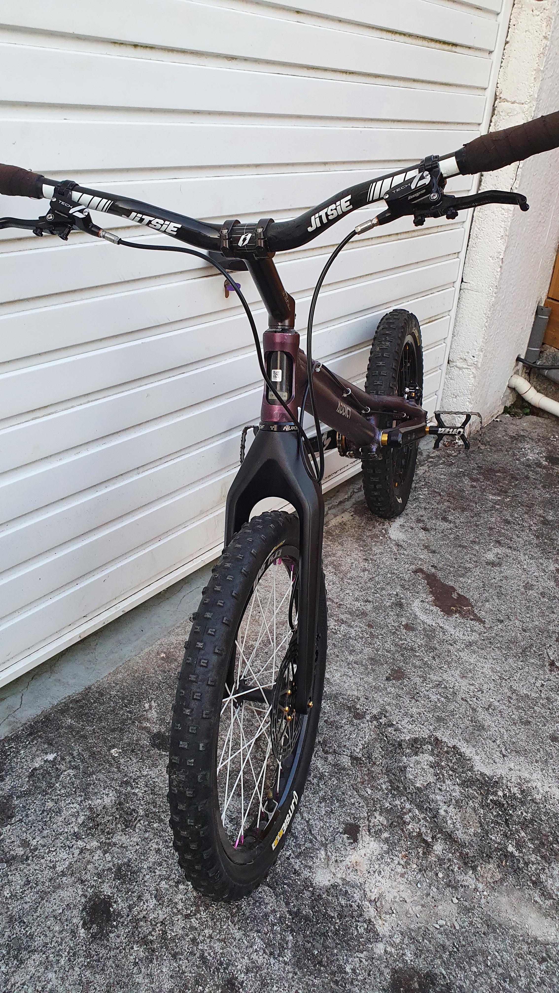

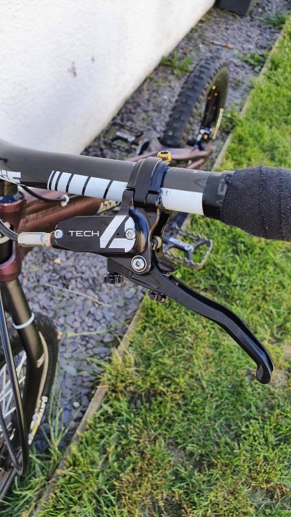

Mini update: bought Hope Tech 4 trials rear brake and a fitted the Trial Zone to the front. Just need to trim the rear hose and gove them a bleed. The Tech 4 looks top notch quality and has a nice light lever action.
Does mean no more carbon forks :(... for now!

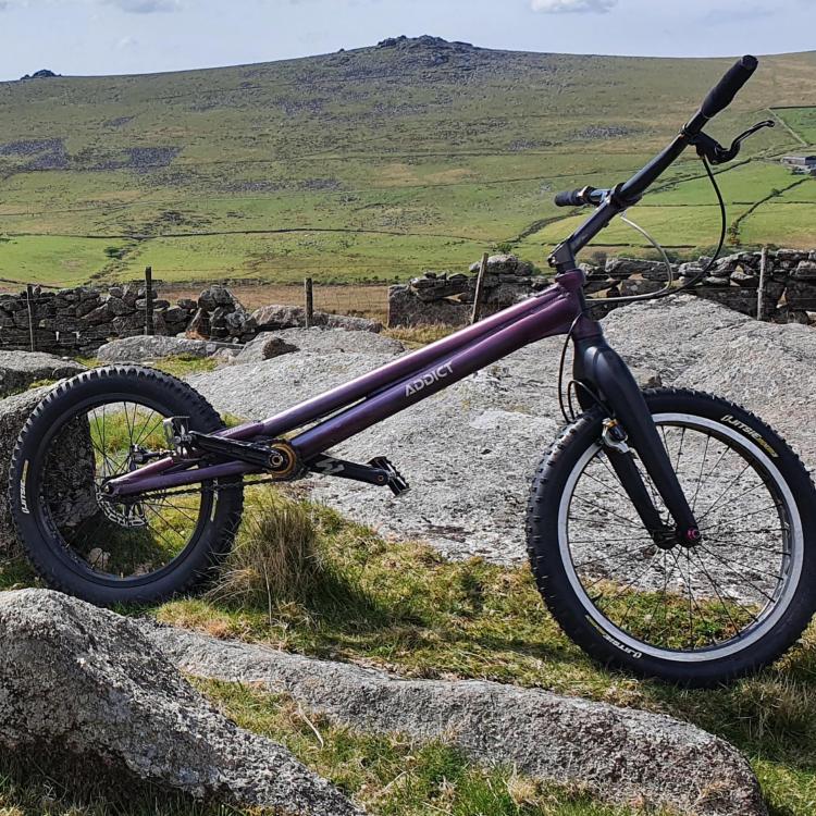

Mini update: Bought some Maestro carbon forks from Joe Seddon (thank you). They're tapered steerer so had to use a lower adapter headset, so the geometry has been altered. In my books a win as I was looking at a new frame anyway... higher BB, wb is the same, guess its a marginally slacker head angle.
