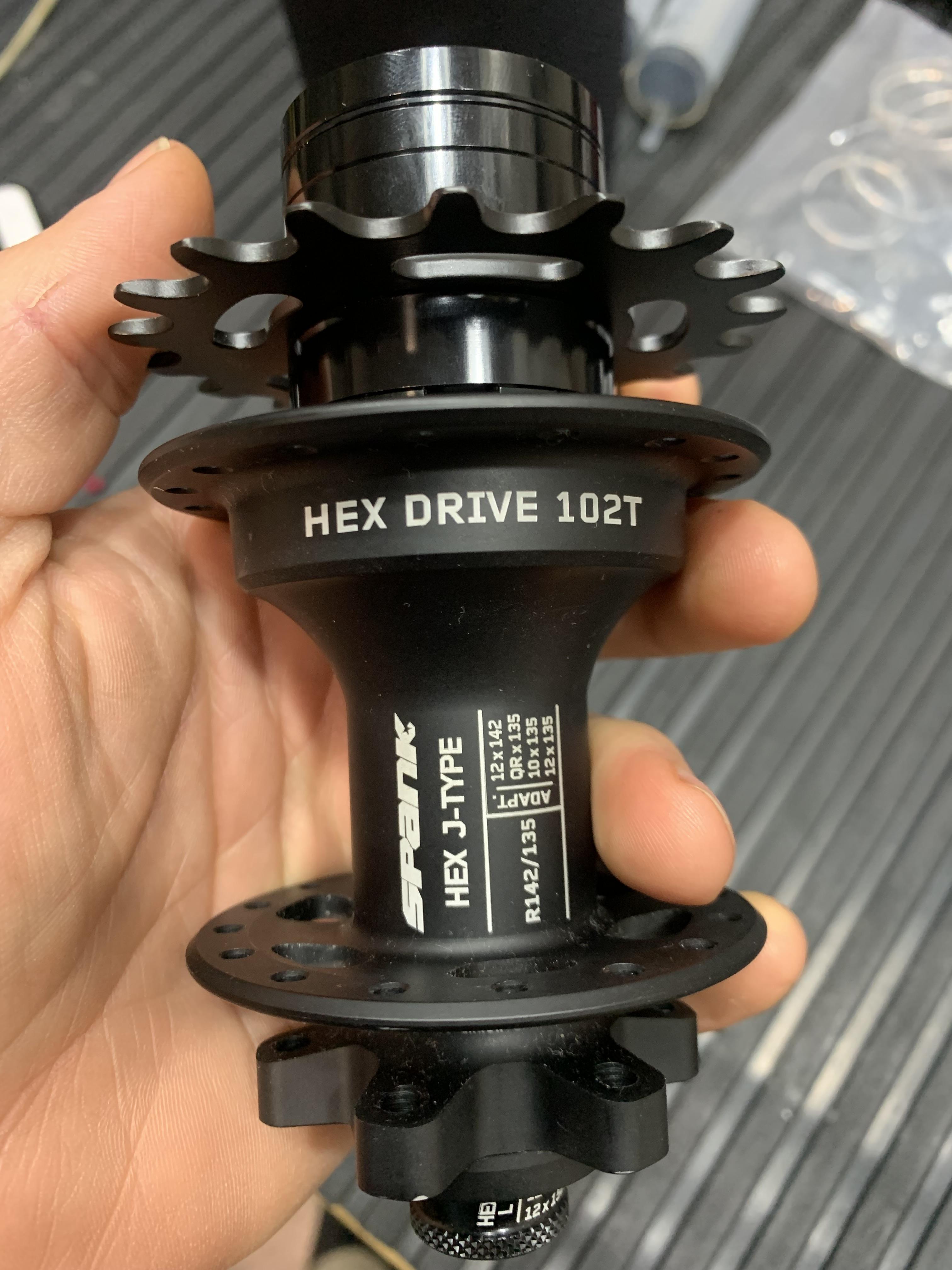

Thanks mate, I really appreciate it.  I was looking for less resistance and a better response.  But it seems like we can't have it all. Now that you mentioned the Spank hub, I have one of them (waiting for a better rim). I wrote to Yoham to get his review and told him the same thing.  The I9s are too much for my humble riding style.  Maybe when I'm older (I'm 46 😁 ).

Spank offering e-bike steel freewheel for j-type Hex which i guess it is stronger and it is good upgrade for trials and it is not so expensive.I run same hub but on my enduro bike and helps me a lot for trackstand,front wheel lift and so on.No problem so far(riding it about two years).
