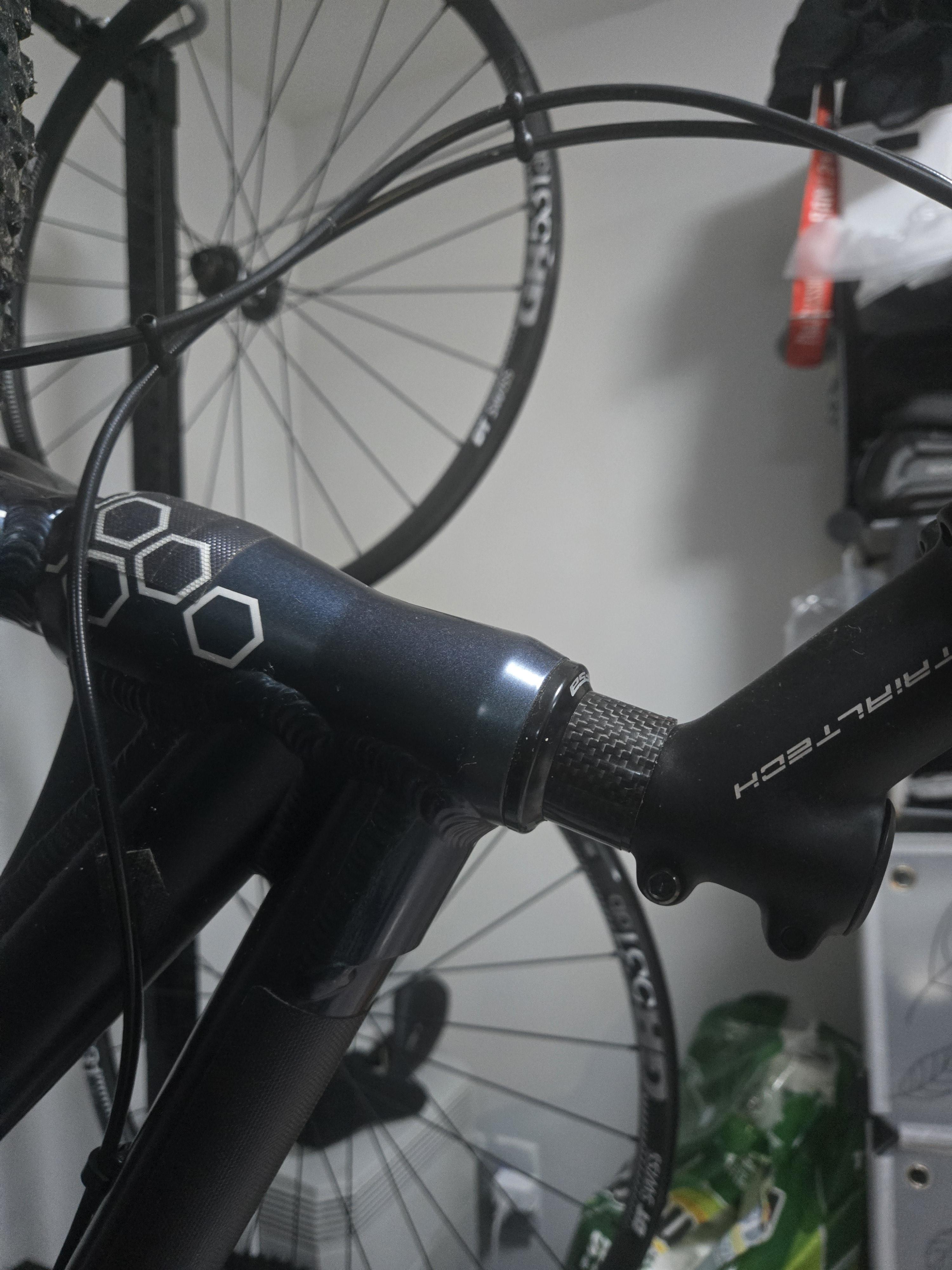

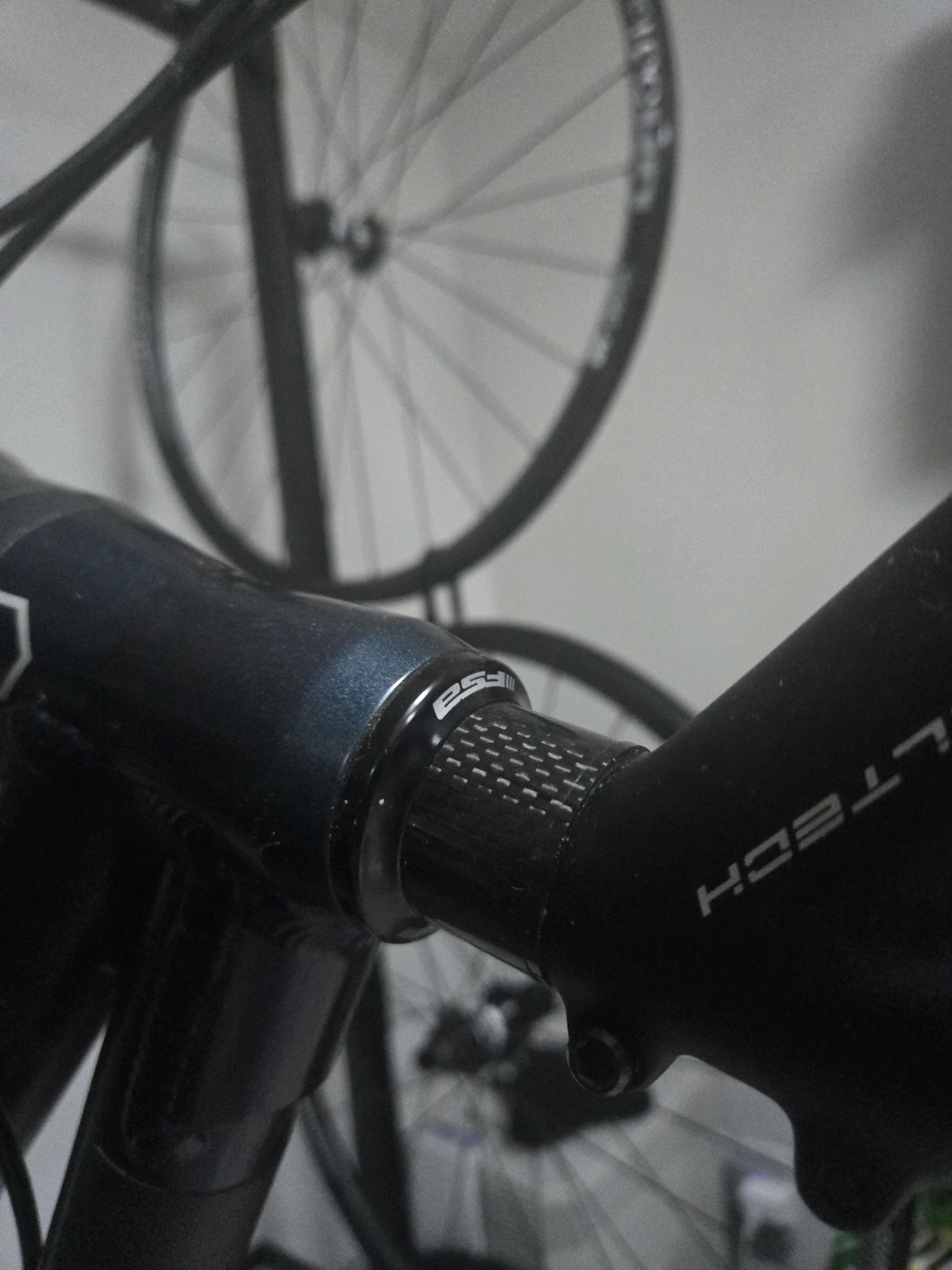

Inspired Hex features a integrated headset, so the top part below the stem is just the top spacer of the headset.
Inspired comes with a tall cone headset spacer from the factory. You should be able to find a short stack headset spacer like I have from your local bikeshop. They come in different internal designs for different headsets so you may have to try a few to make sure it fits the headset in the Hex without resistance. This will then allow you to run a shorter steertube.
Doing this and replacing with carbon spacers as pictured saves you free 20 grams at the stock Inspired fork steertube length 😄
