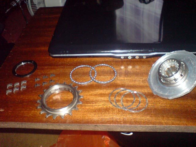

The lock ring came loose and got all gritty so I stripped it down, cleaned it with white spirit, lubed it with Finish Line and tightened it back up. Seems to have done the job nicely :D
Here's a pic of it in pieces:
It was damn fiddly getting the ratchet over the pawls/springs when it's still attached to the crank!
It feels like new now, quiet, and much sturdier :D
