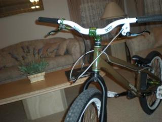

ok so out of 2 stems i got to try, both hope (1 is 110mm and the other is 90mm) i got a new diety twenty14 riser (2"rise) Hell, these bars are nice. Also running about 1" spacing and bars are pretty much tilted to highest point, brakes almost straight down. Soooooooo comfy, i can get on my front with less stress AND althouhg being slightly narrower than my trialtech risers, it feels awesome on the rear. Just standing up it does feal heeeeaps more diff and slightly narrower, but feels like ALOT of fun off the mark 9 degree and 5 degree sweeps make it uber comfortable. I swear i wouldnt own anything under 2" rise again The 90mm will be too short I reckon and ill end up tipping the bars forward and losing height.....This is perfect now woohoo. Might be selling a hope cnc 90mm 10deg if anyone interested? and/or trialtech 110 17deg rise. -

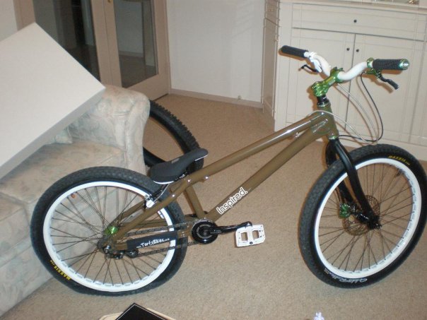

Rear brake is a hs33 with tnn pads. Rear break is nuts with the tnn pads, best brake ive used and there isnt even a grind on my rims! Ive also put a white mcneil seat on since (might go back to my black one) and changed the headset and front brake to same but hope green ones....cost me no diff in the end -

yeh i changed mysetup to a system ex 100mm X37deg rise with my trialtech risers. im about 168cm so short. Found bunnyhops to be waaaay cool, but it felt real cramped once i was hopping on the rear. Changed the bars position, brake position...still didnt feel too right. Now the trialtech 11oX17deg seems nice with an inch of spacers and my trialtech bar, it feels nice and comfie on the rear but ur going to be pushing harder to get your weight over the front wheel. Until u get to that point, the momentum is easy to flich forward, just need a little more umph. Thats why im now going to experiment with my trialtech, 1x 90mmX10deg hope, 1x 110X10deg hope and azonic b52 bars with 2" rise and about 1.5" of headset spacers lol. Gonna pick n choose combos this next 2 weeks n see what works best. If anyone needs a system ex and possibly a trialtech riser soon and trialtech stem, let me know (like next 2 weeks) -

Im running 22-16 again (went to 17 rear but just feels so spot on with a 16) Ive also gone back to my trialtech stem after playing around with the system ex stem (just felt too short) but probably going to a 110 hope stem and getting azonic b52bars 2" rise. Also inspired pedals and tnn pads. Also yep, its a rohloff tensioner on there -
