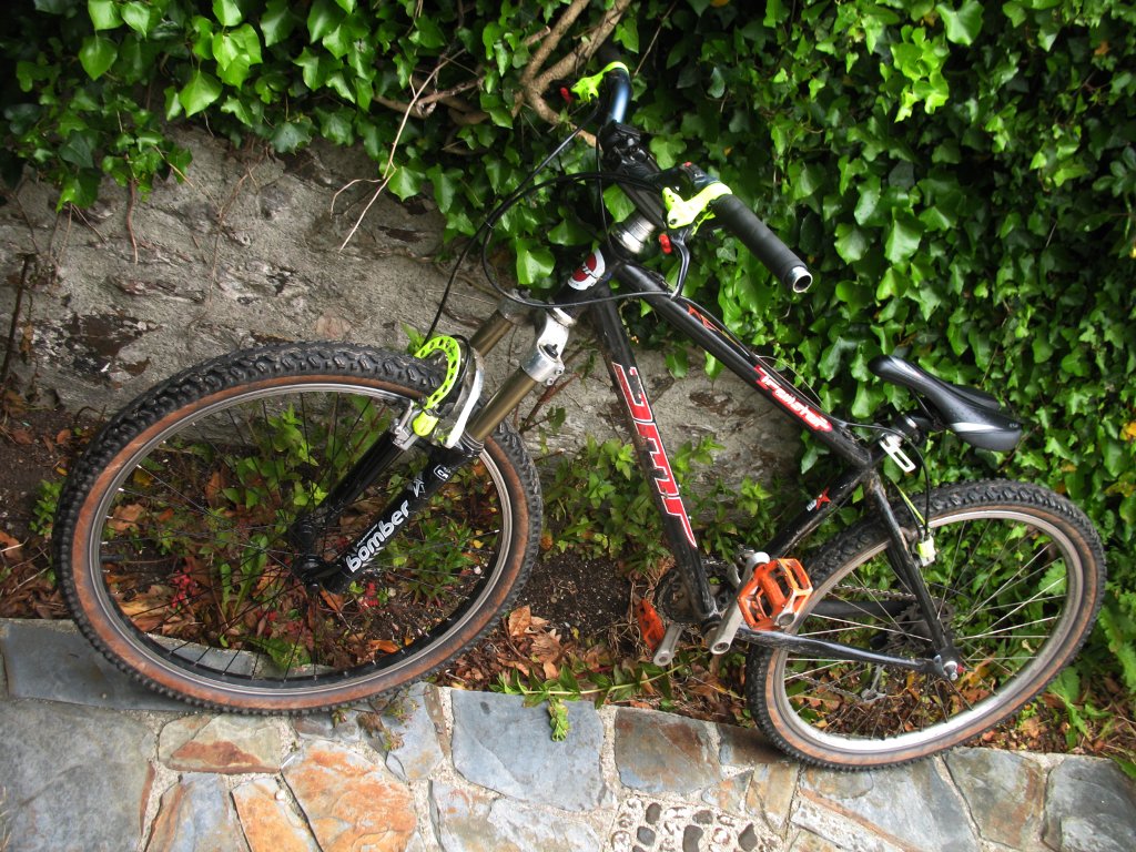

Is My Non-trials-specific Bike Holding Me Back?
scary_jeff replied to scary_jeff's topic in Trials Chat
Hah, no it's not that bad! That was just some random picture I found on google to show nichols_sam what the forks were. I included a picture of my bike this time, although I've accepted now that a trials bike will help me... I've just sort of hijacked my own thread to ask questions about learning new stuff. I have actually had a go on a mod a few years ago, but it just feels too weird for me, and at 6'2" I felt a bit stupid on it (no offence to any tall mod riders intended! ). Thanks for the reply though. btw, those noname V8 copies have lasted over 10 years now -

Excellent, thanks for the advice! The forks aren't the drop offs, they were more expensive I think (back in 2000)... they are Z1 CR. Not my bike but I found a picture here: http://www.bikenews.it/mercatino/FSR1.jpg . Hah, that bike looks SO old! I couldn't really try the sidehop wall today because there were 30mph+ winds in that spot (well I did try but I got blown over). However, someone put a pallet in these ww2 ruins I go to, so I tried putting the pallet against a wall to try and get up the wall. I managed it after about 50 tries, really pretty rewarding learning the weight transfer and ending up being flung into the air If I want to eventually get up the same wall without the pallet, I guess I need to make the pallet steeper and steeper? I would say I had it at about 15 degrees from vertical, and the ground slopes up towards the wall at about 15 degrees as well. Next question, when I get a trials bike, will the rigid forks make this sort of thing easier or harder? I couldn't tell if my forks were just absorbing energy, wasting it, or if they were recoiling and helping me out. Also, I'm definitely taking some chain links out. My chain either came off at the front, went up a few gears at the back, or (usually) both, pretty much every time I tried the wall :/ The rear mech is a bit stiff as well, so I'll try and sort that out to. -

So, anyone got any tips for me? What can I try to not end up leaning too far over once I'm up the wall? Could the problem be caused by me not starting by hopping on the back wheel, and instead trying to do the whole thing on one movement? -

Hi. I did a forum search for this, and only found something from 2 years ago that I thought best not to resurrect. Anyway, My current bike (DMR Trailstar, Z1 forks) is the only bike I've really tried any 'trials' on. I would say I can do most tricks on a micro scale.. anything over 18 inches high/wide is too big for me to get up/across. The forks weigh 5.5 pounds, the frame weighs 6 pounds (according to google, it's not one of the newer lighter ones), and I weigh less than 12 stone at 6'2". I just had a go on it for the first time in a few weeks to try and copy some techniques I saw on youtube, and it all feels like so much effort. I probably haven't got any better at trials for at least two years. OK I only ride it once every few weeks, but that's mainly because trying to do any trials on it doesn't end up being that much fun. I'll happily keep trying the same obstacle for 10-15 minutes, but all I end up with is aching arms from yanking on the bars, having failed to do whatever I was trying So I was thinking of getting either a stock or 24" trials bike. I'm just really wondering if I can expect to be able to improve that much. I plan to ride it a few times a week as an after work activity making the most of the sun. I don't know anyone with a trials bike to have a go on. Basically, does getting a proper bike sound like a giant waste of time for me given that I don't seem to be able to improve on my current bike? Or is my current bike such a complete disaster for trials that it is clearly holding me back?
