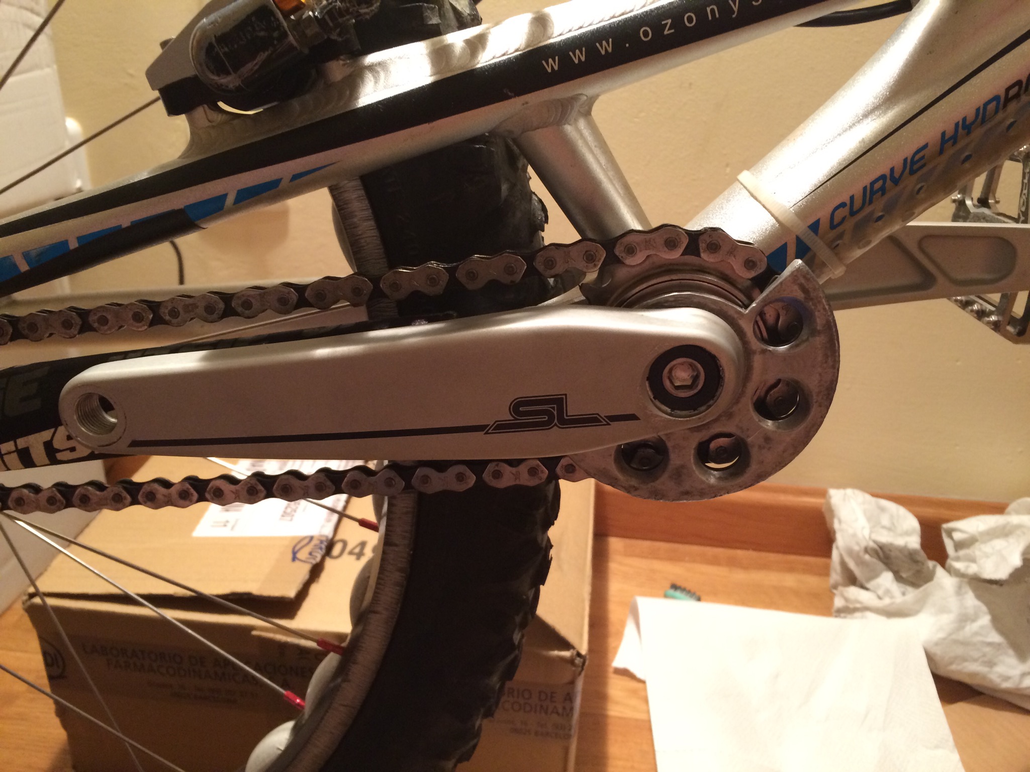

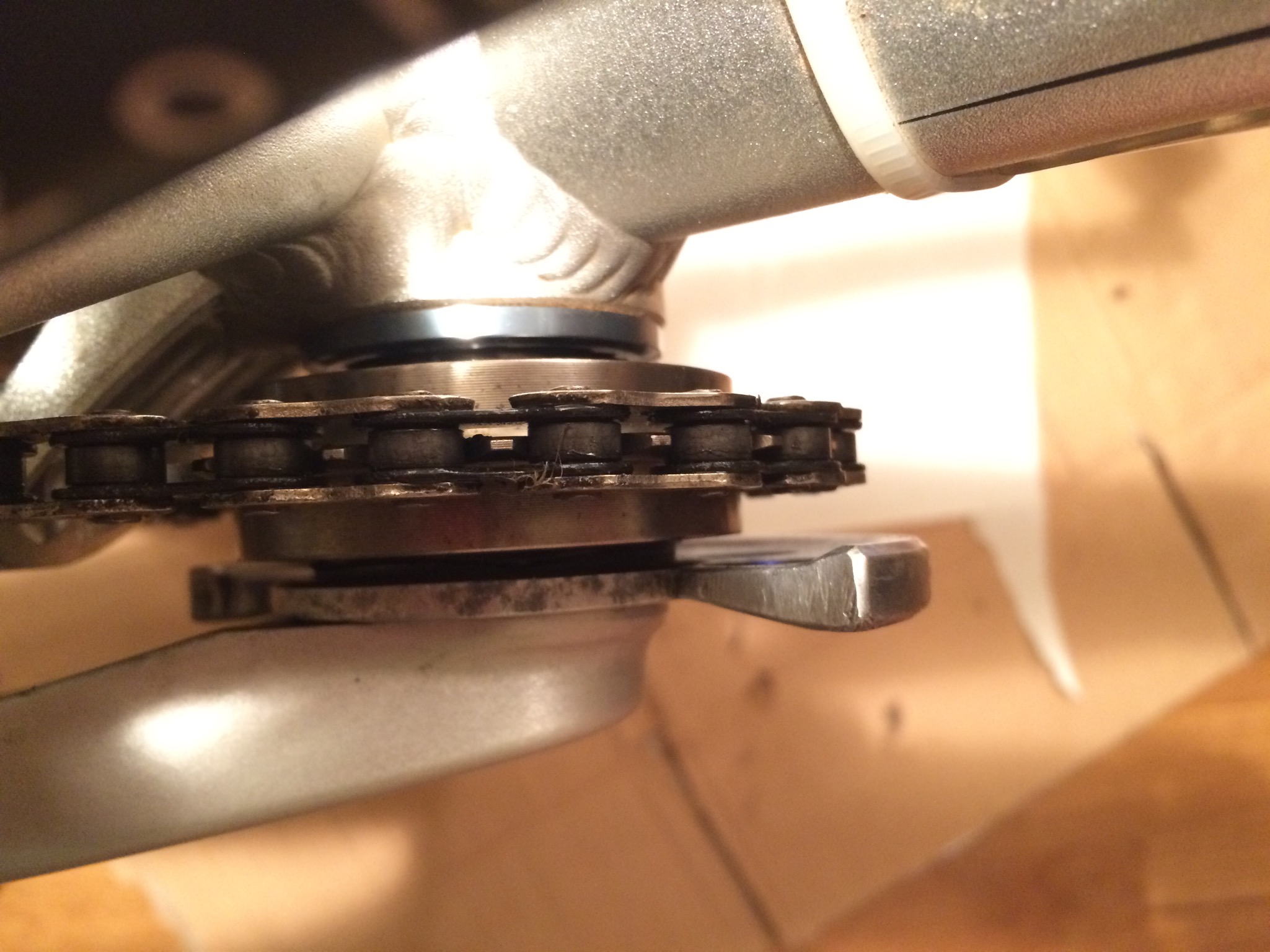

	Done! I think that It's ok, with 8,5mm of free tread for freewheel. I put a lot of grease and tight and untight strongly in different crank possitions 3 or 4 times and the crank end really close to the position of the old one, but not exactly the same. Try-all and Bonz cracks fits perfect and no need and extra washer of 2mm for a perfect chain alignment. Maybe in the next rides I can tight it a little bit more... Thanks for your Help!!!! Here attach some promised pictures where you can see the alignment, free tread, extra washer and final look.

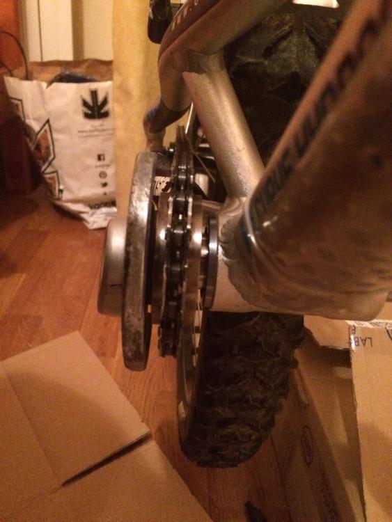

	Hello! I have a problem with chain alignment after change my old Bonz cranks for a new Trialtech SL . With no problems in the past with my old Bonz and much more old Try-All ones . Now, with my new ones the chain it's much more outside and the alignment is so poor. Today I install a GU ring and extra washer of 2mm and is not enought to achieve the correct alignment. (In Trialtech web claims That at least 7 mm of tread must be cover by the freeweel) Which could be the next step? Maybe a displaced sprocket? Thanks for your help.
