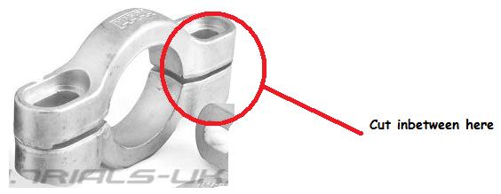

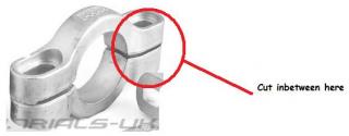

mole grips are similar to pliers,pliers will do the job too these are mole grips if you cut were the picture shows it should get you outa trouble
think you hit the nail on the head there,thats the best way to do it without damaging anythng although you may have to cut the mounts a little,next time you wont round them off though!
