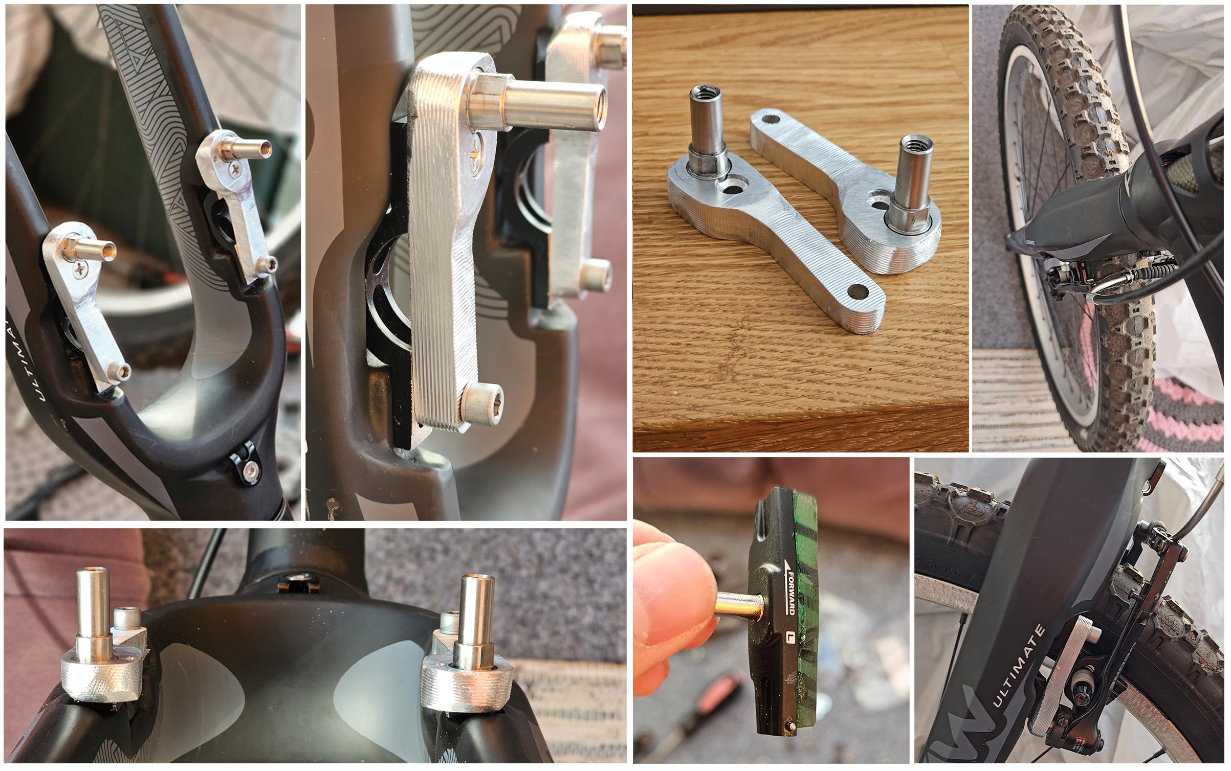

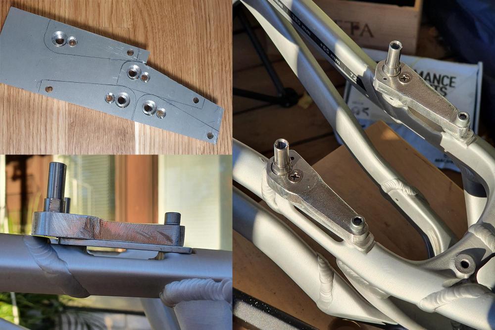

  7. No I absolutely hated the HS33 and had to finally do something to get permanently rid of it. Kind of forgot to post here but here we go: I made another pair for the front last summer and now the bike is complete. The result is super stiff and works well. This time put a lot more effort to shape the blocks with a better set of new files. Still very unfinished in my opinion but honestly I don't care that much, they're kind of hiding there behind the brakes anyway. These are now much lighter/smaller too and close to what I originally planned with this material. The WAW fork is definitely a difficult one, there is a lump of carbon in a place where I couldn't make the adapter any slimmer, close to where the brake boss is attached (would have to shorten the thread even more which is not a good idea). I had to use my old HS33 clamps as an adapter for the adapters, just filed them down a bit to keep the thing as low profile as possible (I could still get a few mm off of them but was too eager to get riding at the moment). I was a bit worried but the result is not bad at all, the brakes are not protruding too much from the forks. With some careful CAD design, CNC machining and a pair of deeper sitting V-brake arms than Shimano, it would be possible to make the whole thing a lot sleeker though. But this is enough for me. I made the pads using cheap Shimano v-brake backings shortened. These are a bit spongy though, could work better with a set of TNN v-brake pads for sure. But it's good enough and so far I like it. Time to throw the Maguras out of window.

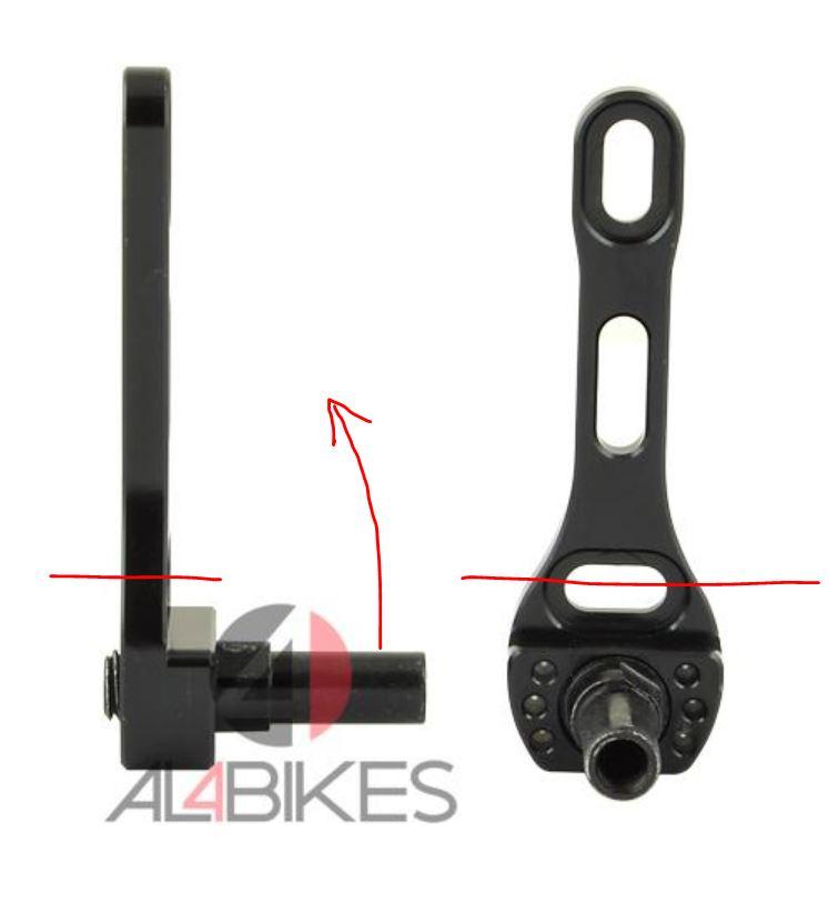

  11. If going DIY, it's good to remember that the most critical part is going to be around the rear mount screw, which needs way more material than it looks. The forces are trying to rotate the boss and bend the adapter. Monty and many others failed it there, making it very thin and fragile right in the most critical point. It will always fail at the weakest link of the chain, so it doesn't help if you put tons of material around the V-brake boss and completely weight weeny the spot where it joins the frame. It's the overall volume and quality of the material together with the bolts tightened up that matters. So around the M8 or M10 V-brake boss it doesn't need to be that thick actually, but the rear mount screw is just M5 so it needs a lot more material around there to be equally as strong. The front screw is further away so there will be significant leverage that takes stress away, so we don't need that much material there. Also it's good to avoid any sharp corners as always, round shapes are stronger. My adapters are definitely very overbuilt (considering the quality of the material), but that's mostly because they are work in progress.

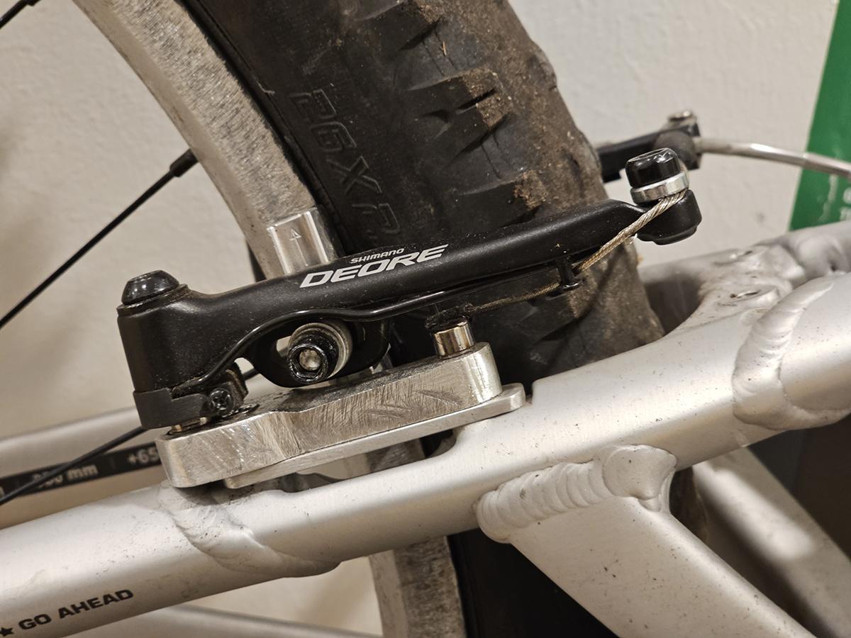

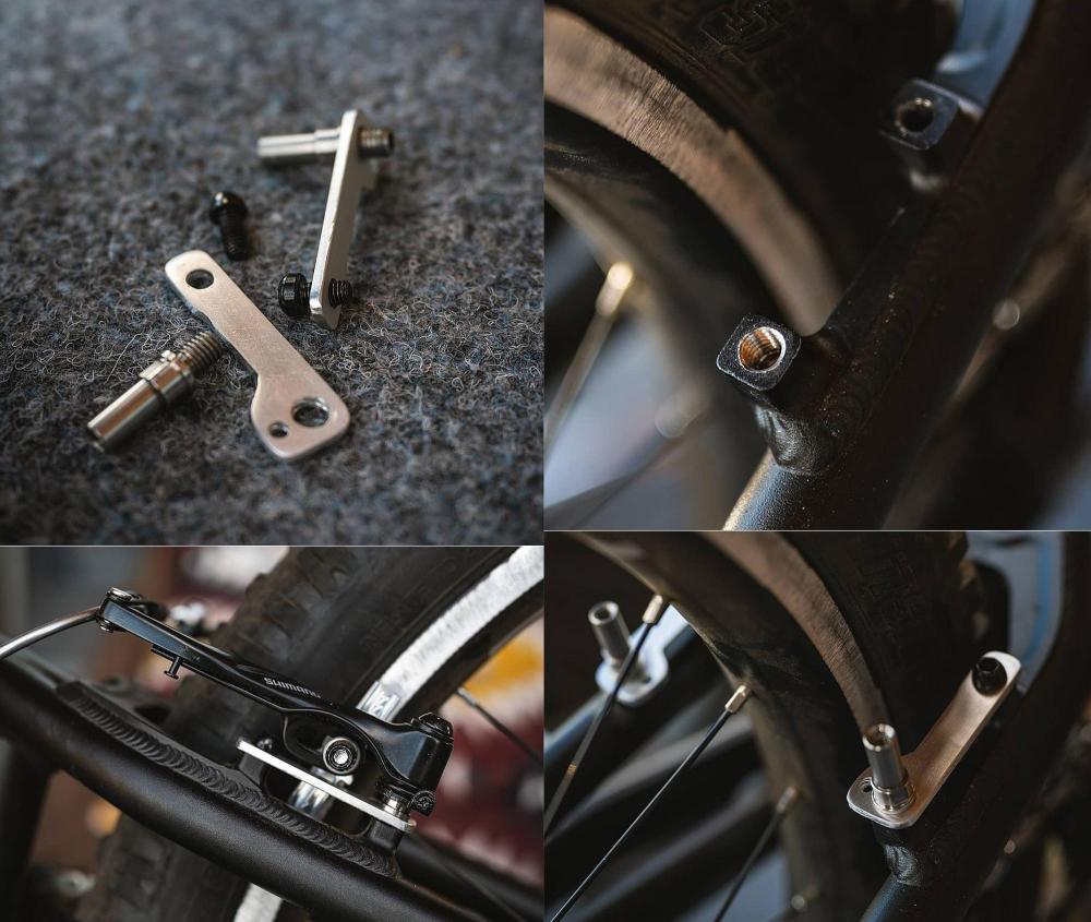

  12. Here's some DIY: I actually drilled and tapped the lower hs33 mounts of my Echo mk5 and later the mk6+ frames (and forks) to accept M8 stainless V-brake studs (ordered from brake-stuff.de) and that was the best idea ever. After the initial tests I was completely sold to V-brakes, just better and easier than hs33 in so many ways. Echos are nice and easy frames for that modification, especially the mk6+ due to its beefier construction. The studs were a bit too tall for the mounts so I ended up making an "adapter" that acts as a spring preload plate but also (in theory) taking some stress away from the rear mount. Last summer I switched to a Crewkerz Jealousy frame and things got a lot more difficult. The frame is a real pain in the ass to setup V-brakes. The CNC machined construction of the lower mount seemed a bit too thin for a M8 stud (the CNC piece is most likely hollow so I couldn't just take a drill and hope that there is going to be enough material). Also the placement of the mounts didn't quite match the rim for V-brake use as they were placed way too high on the seatstays. So I had no choice but to make my own adapters (Monty, Neon etc. I didn't even consider because they are just too flimsy and I highly value my spine). Actually the hardest part of the whole project for me was to find a consumer friendly workshop that is willing to sell me a small chunk of 7075-T6 aluminum for a reasonable price. I didn't want to make any compromises with reliability so these adapters are probably tougher than the frame itself. Now working with 7075 is definitely not too easy, so it took a fair bit of dedication to make this happen with shitty tools and lack of proper workspace. At least we got a column drill, would have been a nightmare without one. At that point winter was coming soon, so I ended up just roughly shaping the blocks to somewhat tolerable looking just to get back to riding as soon as possible. I had plans to actually finish them to look pretty and "professional", but knowing myself it will probably never happen. Works well, looks ok, weights a ton, but at least I got a V-brake on my Crewkerz! At the front I'm still using the old hs33, just because I'm lazy to "finish" another pair of adapters, but also because the mount design there is going to be a bit more challenging. For the V-brakes I've been successfully using plain cheap Deores for 3 years now with TNN pads and backings. They're pretty good although there is some slight play between the stud, but it's barely noticeable when riding and absolutely nothing compared to that of Maguras. Avids or Lykketrials would be nice but impossible to find. This setup has been a proper set and forget, just works fine and feels consistent everytime.

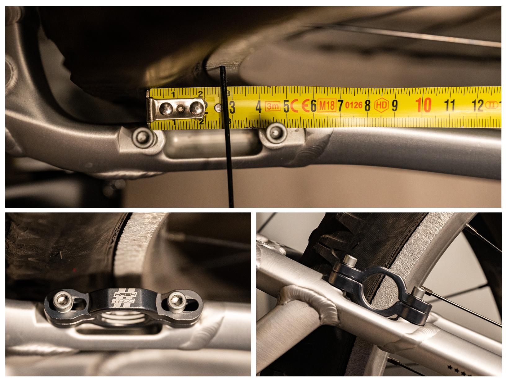

  15. Thanks for mentioning, didn't even realize to check this out on my frame because I'm fully committed to using V-brake setup with my custom adapters. But decided to take a look and guess what.. (The gap between the bolts is 46mm) Here the clamps are pushed all the way back towards the weld. Looks like the brake pads would touch the tire even with max setting, with these particular clamps at least. Honestly the whole thing looks pretty unacceptable to me, but it is what it is and pretty sure that every 2022 frame has this flaw, more or less. Have to say I'm glad that I will never ever use Maguras anyway! Any chance Onzatpro09 if you could measure the wheelbase of your 2022 medium? I decided to send my large frame back and get the medium, because if the WB is consistently approx. 10mm off through the whole lineup of sizes, the M should be exactly what I prefer around 1080-1085mm. However, I'm starting to suspect that they might just have some really loose tolerances and labeling the frames based on what size option fits closest to the final measurements of each frame. This is why they are the only trials brand with multiple sizes to offer

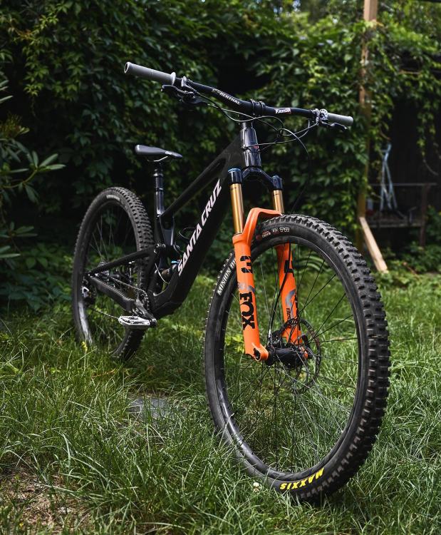

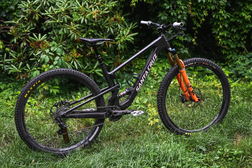

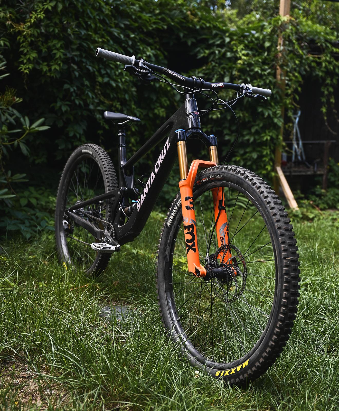

  20. Last year's bargain build now updated with second hand 2021 Fox 34 factory Grip2 forks at 140mm, over the previous RS Pike that never seemed to work well (sticky bushings on every RS fork I've ever had, got enough). - Heavily discounted Tallboy 4 CC 2021 frameset with Fox factory dps shock. - Raceface ARC30 rims because the shop sent me these instead of the cheaper AR that I paid for... - Dartmoor Reel V2 hubs, 102poe, seems to work fine so far. Pretty much everything else was out of stock at that time. - Then some other boring parts from the previous build such as my 5 year old Magura Trail Sports still kicking like new. - Renthal bars for life, because of my moto background and most importantly their mild backsweep works better for a trials rider. Some would think that my drivetrain choice is pretty interesting on this level of bike. Yes it's the cheapest little Sram cassette there, with 10 speed shimano Zee groupset that has seen over 5 years of riding and still going strong. People raving about Sram Eagles and other "must have" bling, but honestly I don't value drivetrain luxury that much (I don't race though). I rather use my calves to get up the hills anyway (seat down of course) and 10spd has proven to be enough for everything so far. It could be faster and more reliable to shift, but other than that I don't really see a reason to update. Lighter gear means more pedal strikes and difficult timing on techy stuff, and loss of momentum. Weight roughly 13,5kg (I'm not a weight weenie though).
