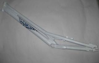

Another hot off the press picture. The prototype 24" Ice frame. Here on Tuesday. Subject to change of course as it is the first stab. Requires some extensive riding.
