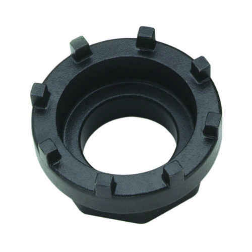

Would this tool work for tightening the lock ring?
Edited by toyota200x
Yep, that tool tightens the lockring that hold the bashring to the crank.
