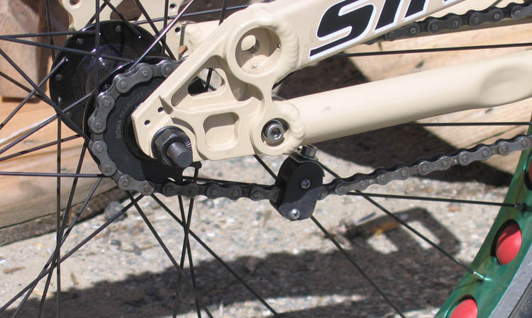

I have no mech on my 135mm hifi, singlespeed with a home bodged tensioner (an old dmr simple tension seeker and exhaust spring off my supermoto with a bit of fiddling about). The tensioner is inboard of the frame and mounted inside the dropout so it can never be hit even if I land on it :)
Meant drilling a hole in the dropout but its not in a highly stressed area so no cause for concern :)
116mm frames have horizontal dropouts like a mod, so you need no mech hanger to hold a tensioner/mech to keep the chain tight. Instead you would use snail cams or something similar.
In my opinion, 135mm is better, wider range of hubs, the wheelbuilds tend to be a bit stronger, and if you didn't want a mech hanger, get a 74kingz tensioner (Y)

I'm hoping Deng will be looking at what koxx are doing right, and making 135mm spacing with horizontal dropouts, IMO its the way forward. Koxx have got something right, but the price begs to differ!!!
Bent two 74 king tenisoners in the last 2 weeks. mech are too bulky. with no tensioner, the chains either too tight or too loose!
It does make sense and allows people to run what they want and allows for the flanges on the hub to be further apart which should give a stronger wheel (unless you do what Giacomo did at Koxx days).
I much prefur the vertical drop outs (135) on my stock compared with the horizontal drop outs (116) of a mod/mod-stock, due to the simplicity of setting up the rear wheel and brakes. But those pesky mech hangers keep dying! So chain tension is then an issue.
Horizontal is much more reliable when it comes to chain tension!

Snail cams are by far the easiest way to set up a wheel. Just turn them against the bolt till your chains at a nice tension, make sure it's central in between your pads and tighten the bolts...Done :)

With vertical dropouts, there's one position for the wheel to be in, therefore, it can't move.
