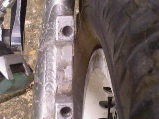

:o How did you manage that, there sh*gged! But yeah they should be able to, just tap it to m6 then helicoil back down to m5? Thats how its done is it not?
I'm not too sure if a bike shop will do it for you though, you might have to look into a local engineering place or something.

Its not that i cant do it because i would buy the kit but the holes are sh**ged and i didnt think m5 helicoil would fit into it.
I think its been taped to m6 but cross treaded will that be ok ?
Not if you want it back to M5. It will have to go to M6, which will be dodgy as there's not a lot of meat around the hole (which will have to go out to 7mm now).
I was thinking about drilling a hole in the side of the mount and puting a little grub screw in there would that work ?

The only thing I can suggest is grinding those mounts flat and trying to attatch steel 4 bolt mounts one way or another...
Looking at them you could probably grind each side of the mounts to make them thinner then sit the brase on mount over it and glue it on with some alderite or something like that maybe even screw through the side.
Edit: here's a pic on paint to show what I mean.
