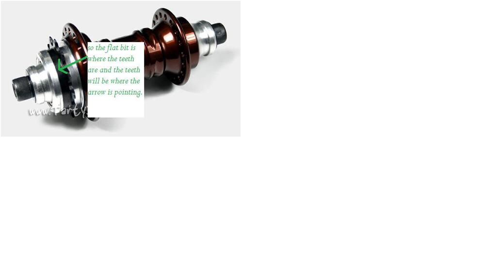

Hey,
My front chain ring and my rear cog on my profile aren’t in line with each other making my chain not go on straight. Therefore making the chain creak when it goes round the chain is brand new and I am running gearing 18, 12. I was thinking can I swap the cog round so the teeth are on the outside and the smooth part is on the inside. Its hard to explain so I will draw a picture.
So do you think i should try it and do u think it would work?
Thanks,
John

I can't remember the Profile sprocket setup, but if changing the cog round doesn't interfere with the lock ring then you should be okay. But unless your change is pretty much straight your going to get issues.
It's been days since you encountered the problem, why haven't you tried it? It only requires removing the lock ring...
Then go from there.
Long story, I ordered the frame, bb, headset, chain and forks from trials-uk a couple of days before i went on a week’s holiday expecting them to be there when I got back. They weren’t, so looked at my e-mails and there wasn’t one...so I sent an e-mail wondering where my order was and they said it was on its way and should be there for tomorrow. it also said the forks where out of stock but there hadn’t been an e-mail telling me this before I e-mailed them when i got back :(. So I sorted it all that out with them and the forks still haven’t arrived so can’t build my bike up fully or ride it so just wanted to see what people had to say about my problem, before the forks arrived and according to Mike D you can’t actually change the cog around because of a lip on the cog itself so I wanted to see what other options I had.
