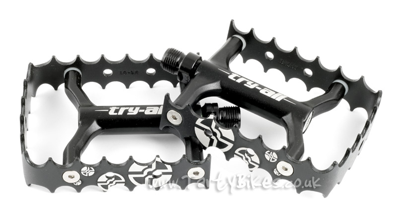

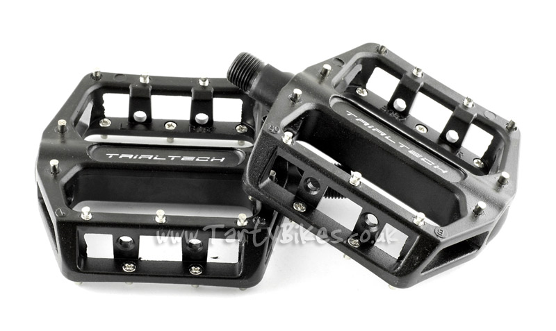

Try-All Cage and below Trial Tech Race Platform.
Cage:
Cons: You can bend the cages fairly easy.
Pro's: still fairly grippy (assuming the cages arn't bent), and there cheep
Platform:
Cons: Cant think of any off the top of my head.. apart from maybe a bit more expensive.
Pro's: They last longer than cage and i find they are a fair bit grippyer than caged pedals.

Ive got 'Platform' on mine. They seem ok. They have really big 'Screws' in. So grip well.

I found cages are far grippier, the platforms I used to have were naff and I was constantly slipping so now I have like double walled cages which have amazing grip, but if you do slip... You feel it.
Personally I've found cages better, but as been said if you slip make sure you have a claw hammer to take the teeth out of your shins :S

I started out on the standard crappy onza caged pedals and i smashed them to peices and had half of it embedded in the back of my leg within a couple of weeks, they weren't grippy either. Most of the cages look very grippy now though, but still look easy to smash.

Wellgo plat forms mate. If you're just starting out you're gonna scrape your pedals on stuff and they will take a beating, cages, allthough lighter will bend straight away. The pins in wellgo's will wear fast too, but u can get a massive bag of grub screws from most d.i.y shops for pennys. The body will last ages! Just keep replacing the grub screws.
Caged pedals aren't generally used in Dh and freeride because they don't support the foot as well as a platform. Personally i much perfer the feel underfoot of a platform and the grip is more than enough; i use Wellgo MG-1 pedals on all of my bikes, light strong and good levels of grip.
Just to second whats already been said really - I've always strayed away from cages as I much prefer the feel of platform pedals, plus as soon as the cage is bent, they're next to useless, whereas platforms are easily serviceable and you can replace the pins/bearings/axles easliy to get them back to as-new condition.
