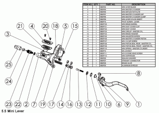

hi there,
my rear hope trial brake is pissing me off! When i pull the lever it is about 3cm from the handlebar, then i can pump it out so its about 7-8cm from the handlebar. Then i can leave it for about 5sec and the lever is close to the bar again. i was told that it was that i is number 16/17 on the picture i need to replace? i am going to try it out, but can it be something else?
cheers.
by the way, it's a new style lever, not the one at the picture.
post-24548-0-69128200-1302032763_thumb.g
Edited by monty221ti
If I were you I'd leave the fluid in and just take the lever off to replace the seals. Use a zip tie or something to keep the hose from flapping around. Once sorted, put the lever back on and bleed normally. By leaving the majority of the fluid in there's less chance of you trapping air in unwanted places.
