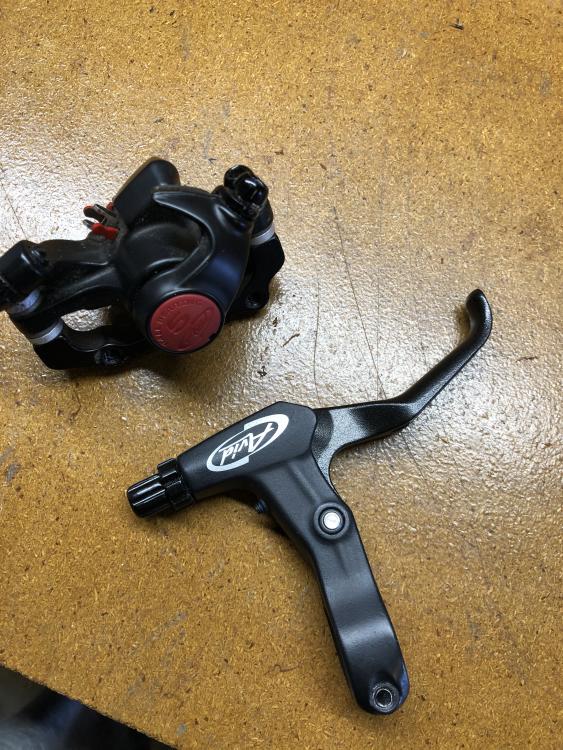

I have a MTB avid BB5 calliper up front with a MTB avid lever. Works exactly as I want it to, good modulation and just the right amount of bite. Pictures below to show the versions I have:

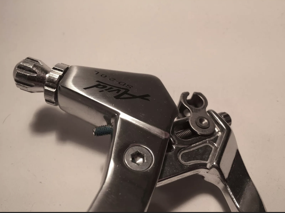

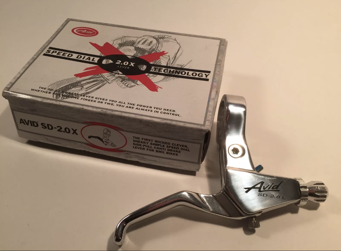

However in a quest to make the bike look a bit more like a mid 90s BMX I’ve began polishing the bare metal rear magura and thought I would do the same for the front lever, when I stumbled across this which would save an awful lot of time and effort:
My question (due to concerns raised on other forums) - will the BMX lever have enough movement to operate the calliper effectively?
I’ve read that some BMX levers are only suited to cantilever brakes etc that don’t require as much cable actuation as a V-brake or a cable disc (with the exception of roadie versions).
Thank you in advance for any advice offered up.
That looks pretty much the same as their regular SD-series levers. Think when people are talking about BMX levers not having the right kind of leverage/cable pull they usually mean this kind of thing that you'd typically use with a U-Brake:
tektro_TK-XL750-K-comp.jpg?w=1100%26h=11
The pivots are usually in a different place to a V-Brake style lever, whereas if you check that SD2 compared to your FR5 (?) lever, they appear to be a similar configuration so it should be all good.
Thanks Mark, that makes perfect sense and offers me reassurance as I’ve already ordered the lever from America haha.
