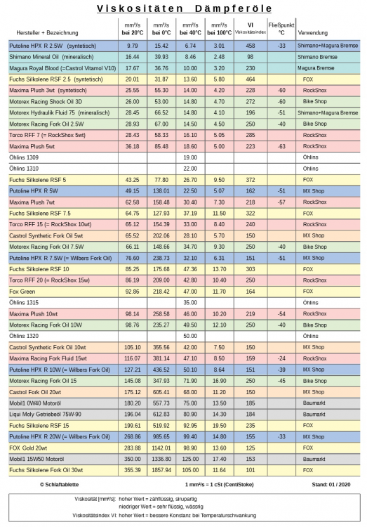

As far as I know the trialtech fluid is a mixture of antifreeze and distilled water and at one point I must have been interested in making my own fluid as I’ve saved this diagram on my phone:

It is a synthetic oil, used in fork suspension. 2.5 means here the "viscosity" of the oil, it is its SAE value (SAE=Society of Automotive Engineers). The lower the value, the less viscosity. But this value is not really a reliable metric, it is better to know the cSt (kinematic viscosity in centistokes) at 40° for example, which is really low for this oil (can't find the chart I saw).
