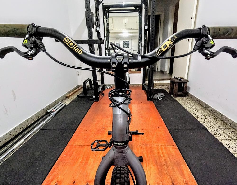

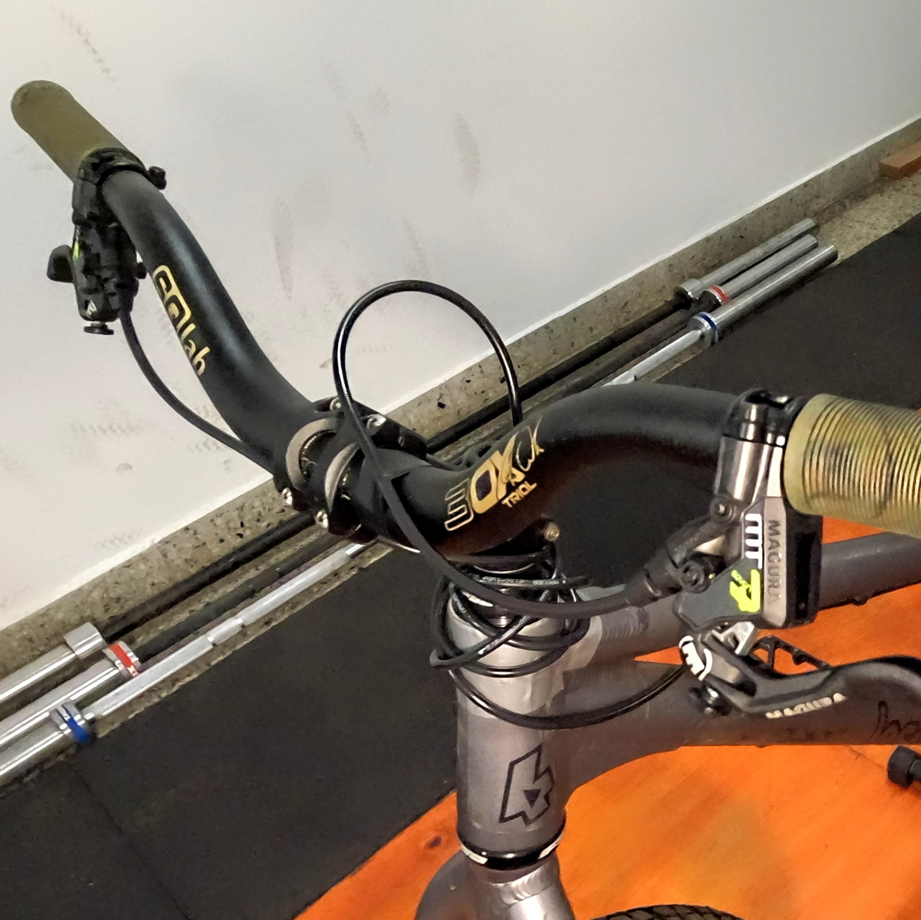

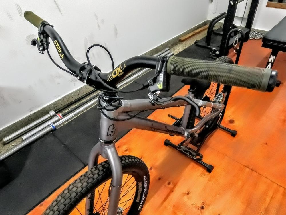

Hi everyone. :)
I wanted to share my feelings and details about the Sqlab 30X Trial handlebar. Fabio's signature. Main emotion: I feel it stiffer than the Arcade riser bar and  was a nice impression (personal opinion)... It comes with  "Montagepaste" (friction increasing assembly paste) to not exceed the tightening torque of 8 Nm. Technical details: It's 84 mm total rise (Arcade Bar, 102 mm), 5* upsweep (Arcade bar 4*) y 9 backsweep. Length 730 mm. Weight: 330 g (Arcade 368g). Made in Taiwan. Clamp diameter 31.8 mm and 22.2 mm diameter grips. This is a theme for the bar ends but if we put some duck tape inside goes ok. I recommend Odissey BMX Par Ends (5€), they are the best I've founded. For the "stem marriage" Sqlab recommends a clamping width of 46 to 58 mm. My Trialtech Sport is 45 mm but I will install it anyway. The Sqlab 30X stem has a clamp of 55 mm...  According with Sqlab User Manual is ASTM F2043 Category 5 – The functional range of bicycles and parts of this category, in addition to those specified in categories 1, 2, 3 and 4, can also be used for extreme jumps and downhills in rough terrain at speeds above 40 km/h. The functional ranges are also colloquially called gravity, freeride, North shore, slopestyle and downhill. Also with a maximum system weight (rider + bike + luggage) of 120 kg. Finally the finished and the aesthetic is awesome.
12 hours ago, javimic said:
Main emotion: I feel it stiffer than the Arcade riser bar... It's 84 mm total rise (Arcade Bar, 102 mm)
That will probably be a result of that. Interesting to hear they're that much lower though, I thought they were more of a clone.
Glad you like them either way (Y)
I thought the same. That was my first impression (nice). I need more rides to get a conclusion. The Arcade bar is hard to beat but I wanted to try an alternative before to order another brand new arcade b.
Thanks, mate.:cheers:

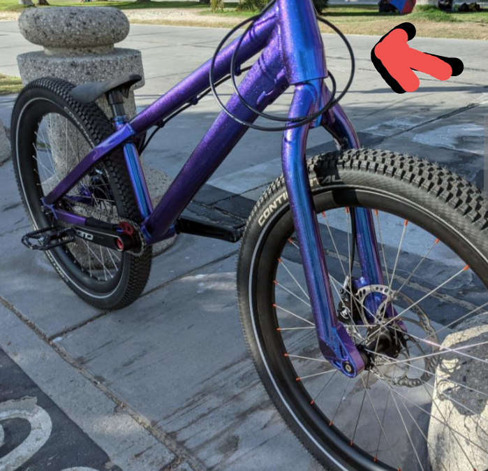

I can't even focus on the bar with the state of your rear brake hose. :blink:
Hey! let that detail slide.. lol. In order to cut the hose I would like to see u finding a Magura olive/insert in Argentina! Impossibile. Now, is on the way because I bleed my eyes when I see the tangled stem. :w00t:
9 hours ago, javimic said:
Now it's not a joke. I'm going to that thread to ask for more photos. I always liked that bike. (Y)
Perfect example ;-) Elegant, like a fine shawl worn loosely, not like a visit from the bike dominatrix.
Message me your address and I'll gladly send you some Magura olives and barbs and such.
