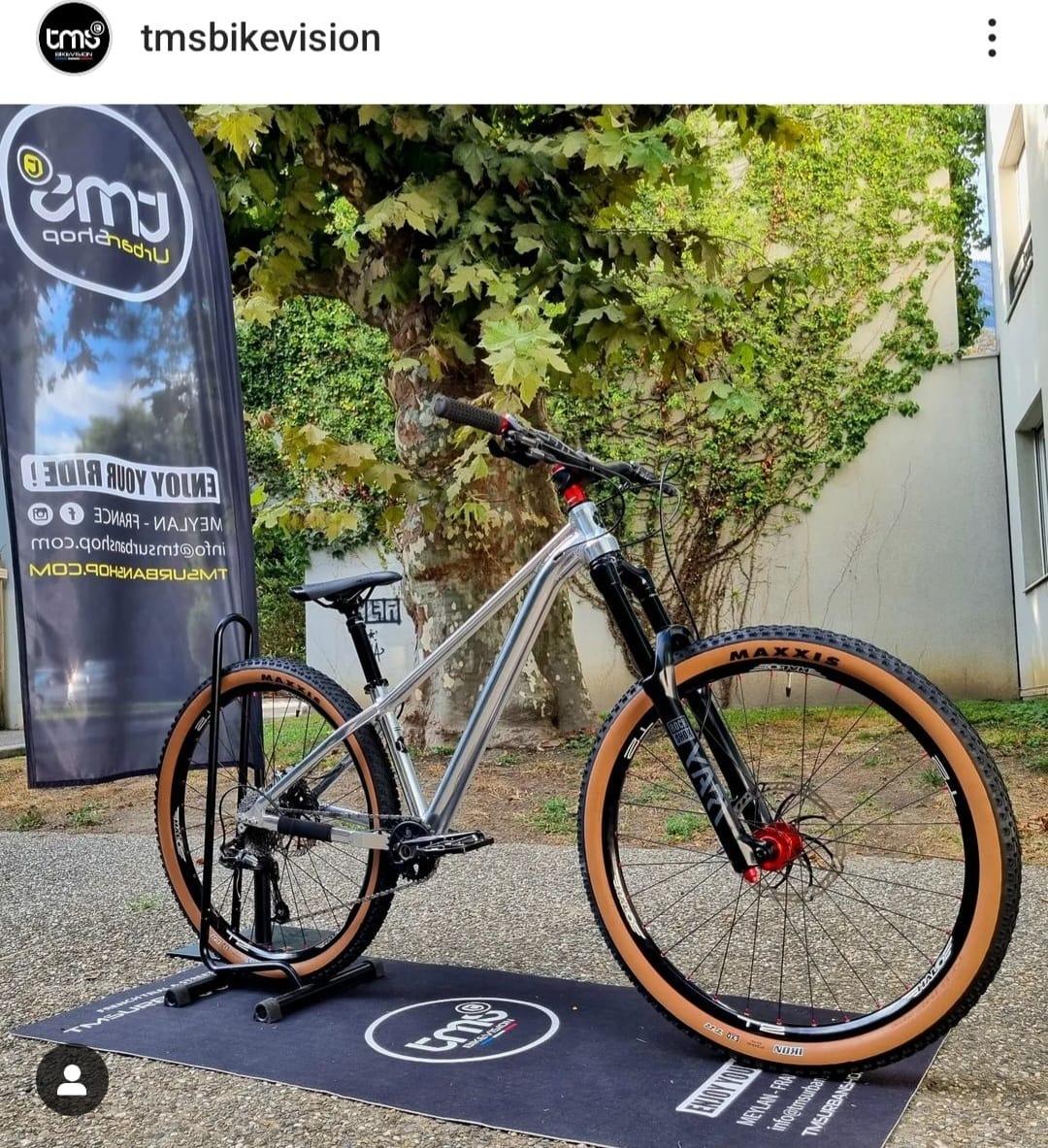

I'd really like to see a bike that's a bit more versatile generally. Something which can run a modern drivetrain and forks, but with a more trials focussed geo (steeper head angle than the current, super slack 64° variety - I had a Genesis hard tail with a 67° head angle that felt like a real sweet spot for trail and trialsy riding) and perhaps some features geared towards trials riding, like a much lower top tube, a grip shift to save bruised thighs and standard post mounts for 200mm rotors.
A hard tail would be the obvious candidate, and I believe TMS prototyped something along these lines, which is looking a bit more polished now:
I think bikes like this could be a hard sell to the target market of the MTB community but, like @Ali C says, something with a back end engineered for preloading, perhaps even using some clever, compact, suspension design borrowed from slope style or 4 cross to make it more appealing to the MTB community who pretty much expect full sus these days to take anything seriously, might just scratch the N+1 itch. Especially if you market it as the bike you need to really progress some new skills.
I get a lot of feedback, especially from older riders, that they want something akin to what they started off riding (converted MTB) but that actually works, and benefits from modern technology and engineering. Something that rides well at a pump track, and the local dirt jumps might just interest younger riders who could be drip fed trials riding with the influence of talented Pro riders showing what the bike is capable of beyond what they're initially going to use it for.
