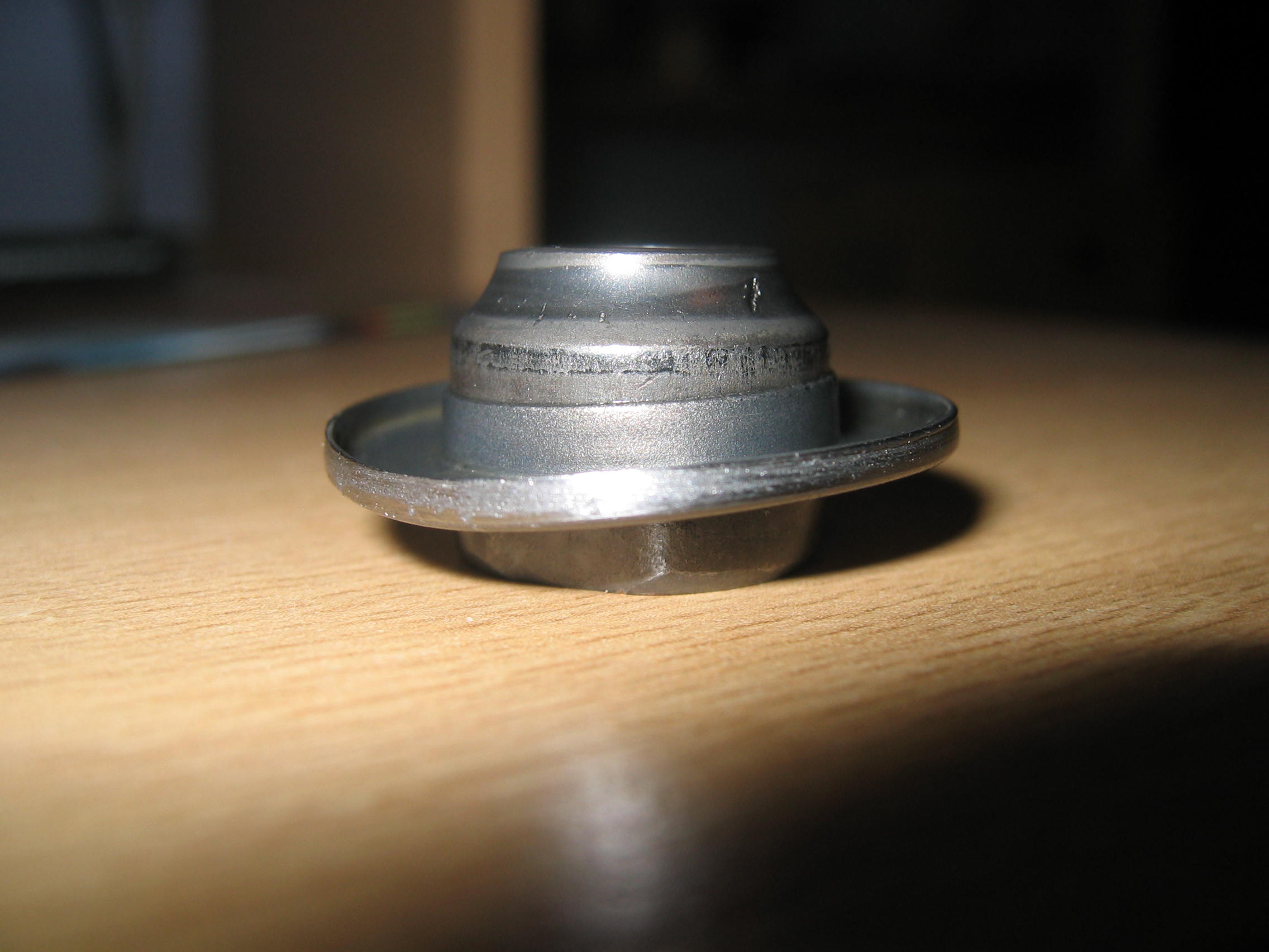

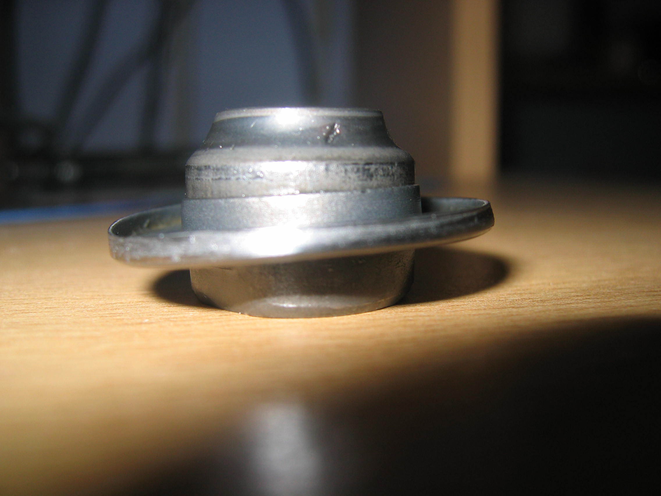

The Duck Posted January 25, 2007 Report Share Posted January 25, 2007 (edited) Pretty simple really, wheel was making a stupid clunky noise with my cheep-arse hub, took it apart to find... Can i streighten it with pliers or something? I feel like crying with the bristol ride just round the corner... Any help very appreciated Edited January 25, 2007 by Quackers Quote Link to comment Share on other sites More sharing options...

nmt_oli Posted January 25, 2007 Report Share Posted January 25, 2007 right, the 'bent' bit is just a bearing cover, and pushes onto the cone. can easily be straightened. support the washer either side, and tap the cone lightly with a hammer to straighten.The cone looks in OK condition, but with some bad pits. make sure you use plenty of grease when you reassemble, and dont overtighten the axle. lock the cones off well too. Quote Link to comment Share on other sites More sharing options...
Dan6061 Posted January 25, 2007 Report Share Posted January 25, 2007 Pop the bent bit off, and gently clamp it in a vice.Just don't flatten it! Quote Link to comment Share on other sites More sharing options...
Ali C Posted January 25, 2007 Report Share Posted January 25, 2007 find a socket that fits in nicley and on a flat surface hammer it flat again. I have delt with this a lot at the bikeshop I work at, the socket trick works everytime. Quote Link to comment Share on other sites More sharing options...
PaRtZ Posted January 25, 2007 Report Share Posted January 25, 2007 find a socket that fits in nicley and on a flat surface hammer it flat again. I have delt with this a lot at the bikeshop I work at, the socket trick works everytime.or something equally bearing shaped and hard Quote Link to comment Share on other sites More sharing options...

abtrials Posted January 26, 2007 Report Share Posted January 26, 2007 yea max just bend them back it will be fine just make sure you grease that baby up nice and it will be fine also if you need a hand ask me mate i have rebuilt so many hubs, wheel's, freewheel's, etc and i can fix anything really mate also i can usualy think of a decent bodge if not Quote Link to comment Share on other sites More sharing options...
Walleee Posted January 26, 2007 Report Share Posted January 26, 2007 right, the 'bent' bit is just a bearing cover, and pushes onto the cone. can easily be straightened. support the washer either side, and tap the cone lightly with a hammer to straighten.The cone looks in OK condition, but with some bad pits. make sure you use plenty of grease when you reassemble, and dont overtighten the axle. lock the cones off well too.+1 Quote Link to comment Share on other sites More sharing options...
