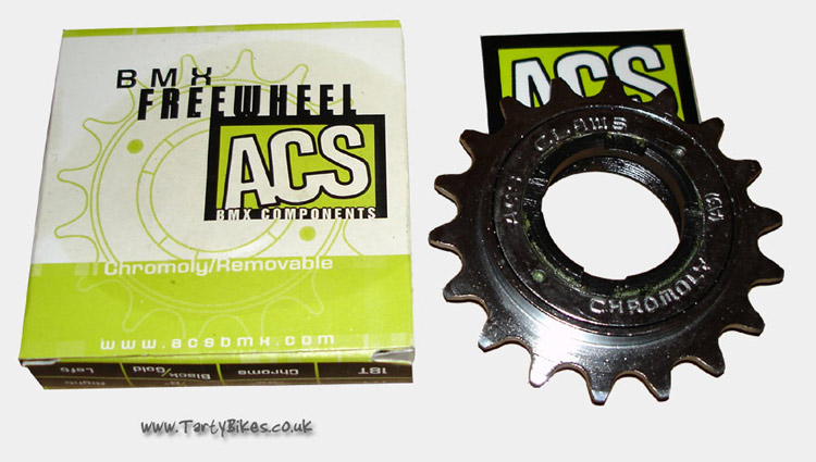

berfore you go off and do any of the complicated stuff though - are you running an ACS freewheel? is the lockring tight? are you sure?
No idea. I don't know what any of those bits are. How would I tell?
- the bit where it says CLAWS and CHROMOLY is the lockring. If the lockring is loose your freewheel will make stupid noises, bearings will fall out and generally bad things will happen. You can solve the problem by tightening it up using some sort of metal stick. There are a lot of threads about tightening lockrings on ACS claw freewheels so have a search and check the FAQ section for a decent guide. You dont need to remove anything from the bike so its easy to tighten it but it will continually come loose until you either weld it shut or decide to buy an expensive freewheel.
I do have an ACS freewheel. I'll have a look for those threads and tighten it. I think I still need to tighten the bottom bracket though; I can see it move slightly on the side opposite the drivetrain.

it's a good idea to take some sort of stick out with you when you ride to tighten the lockring (a big nail or something will do fine - you just wedge it against the frame and spin your cranks to tighten)
It seems to depend a lot on the specific freewheel but my ACS lockring would undo itself every half mile or so of normal riding. When I was actually bouncing about and climbing stuff it was fine so I think it was coasting along that caused it. I got pissed off enough to buy an eno just to avoid the loosening in the end.
