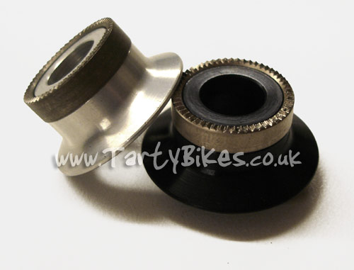

i dont think this has ever been asked before, but would i be possible to cut down the pro 2 trials end caps so it would fit in a mod/ mod stock frame?
is it possible? help me...
also, if i cut 10mm off each one, would i need a serrated edge that comes standard in a modstock frame? or will i just use chain tugs/snail camms?
Edited by ash-kennard
You can't cut 10mm off the driveside. It will rub on the freehub body.
A normal Pro II hub shell + the shorter trials freehub might be a solution?!
As felix says, but you will also have to modify the axle, turn it down some how, making sure that the threads for the axle bolts go in far enough....
