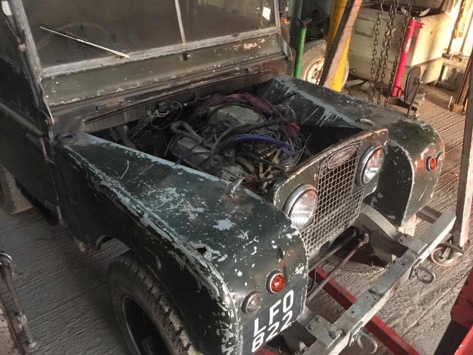

Loving your work Dan! Really been enjoying following this from LurkTown. Dunno if I ever posted this, but it's about to be showtime on the Landy. Capri went last weekend so get some cash to play with, i'm getting very excited... 3.9 Rover putting out a WHOPPING 180-ish bhp, running megajolt and EFI, not masses of power but it should be quite fun in something that weighs just over a tonne and had 50bhp new. Bought a reconditioned gearbox which will probably last about two weeks, picked up an overdrive so it's geared to a real-world 140mph (not that I think i'd be able to hold on til that), and building up a stronger rear axle with hardened shafts and an LSD for skids and wheelies. Might convert the 10" single line drums to front discs, or just plumb the remote servo back in, might be sensible. It's going to be interesting for sure.

Anyone got a link to a "How to fit a stereo to something that's never had one before ever" guide? Thinking of either doing it 'properly' with a shallow sub and some 6x9s or making use of the fairly decent speakers I have that are about to become redundant; @CurtisRiderdo i remember you doing something with a set of computer speakers ages a go? Just wanna build a box with some shit in it to sit behind the rear bulkhead in the Landy, just simple to plug my phone/ ipod into. Fleet update; Capri's gonna go in the new year as it's starting to really suffer from my lack of interest/ garage/ money and needs a better owner. I also need to progress with my life and having two money pits isn't really conducive to that. I've also got some motivation back for the Landy, just gonna build it up to be what it should've always been. TDI's sold and gone, got a 3.9 Rover V8 running EFI and Megajolt going in next month, then gotta stick a fresh box behind it and beef up the axle a bit. Hardened shafts and an LSD for doing skids. Just need to work out the best way to get the fuel to it and re-drill the flywheel to take a Series clutch.
