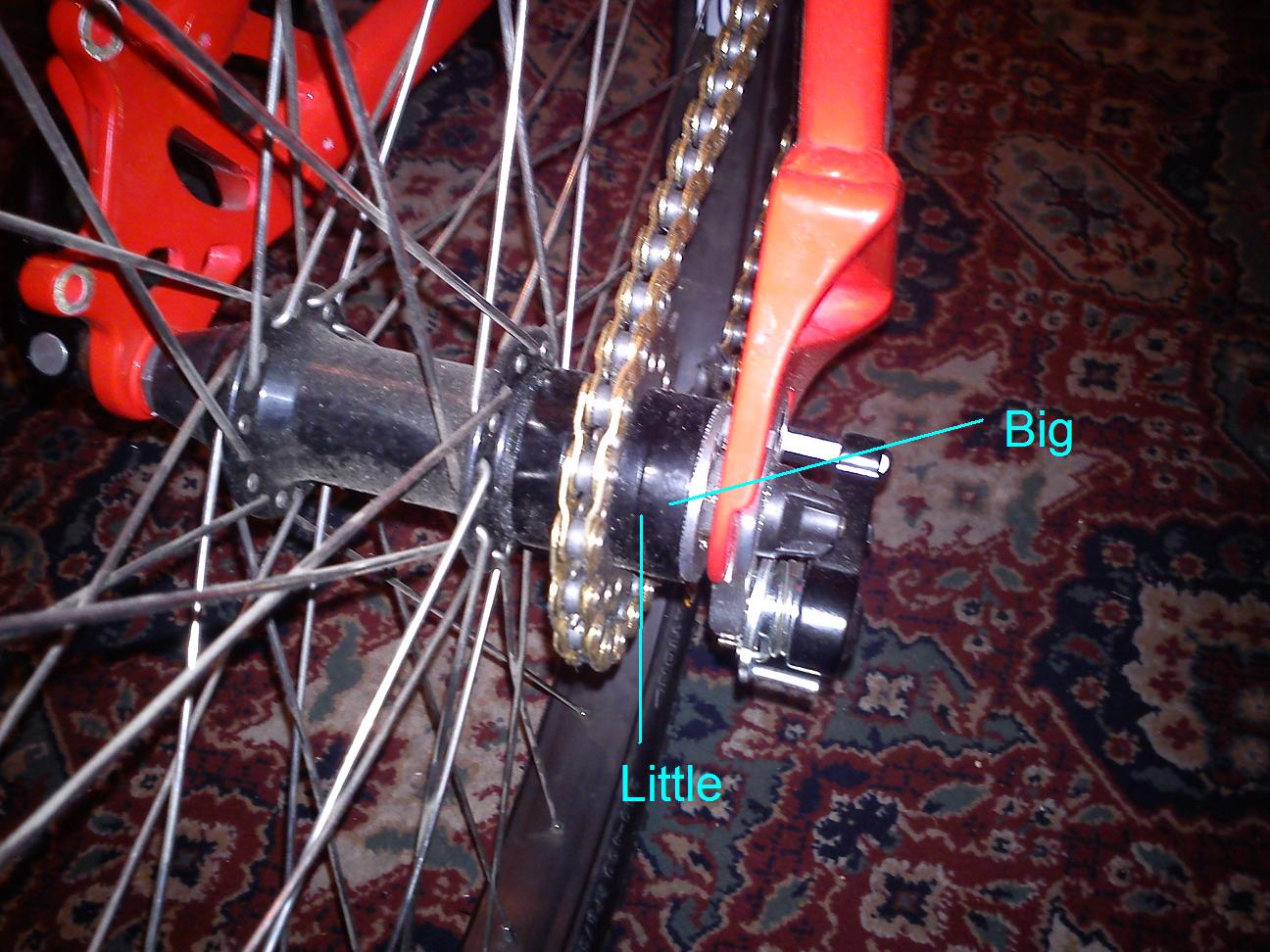

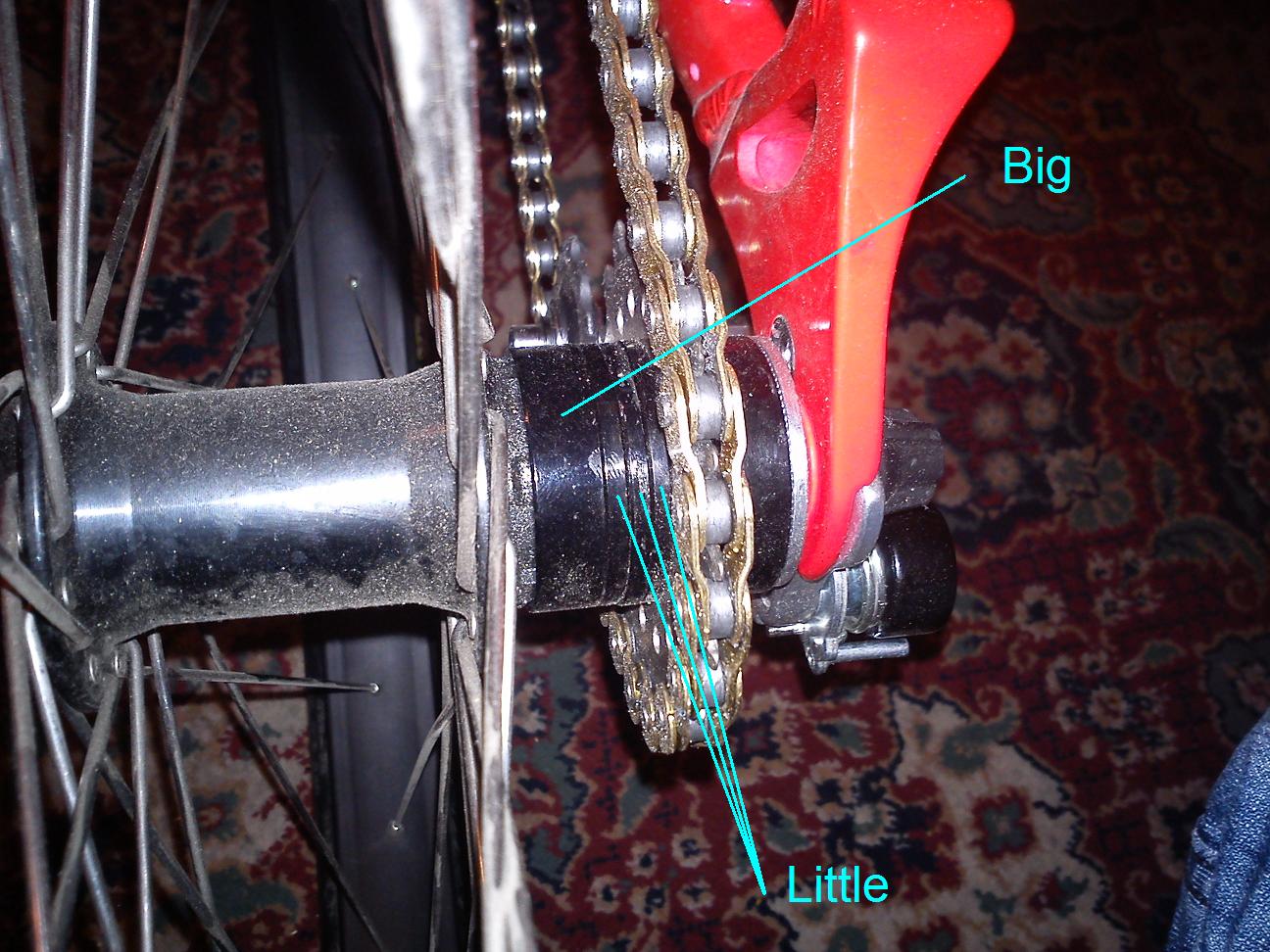

	Looks very nice!! I'm just looking at the spacers on your setup!! It looks like the sprocket is going to be very far inwards towards the hub.. I had the same thing when I did mine!! When you put the chain on, it hits the loop on the tensioner where the cahin goes through!! I'm putting some pictures of how I did mine and its running pretty much central and the rear sprocket sits pretty much perfectly in line with the front sprocket allowing the tensioner to need little or no ajustment to get it to stop hitting the chain. The order the spacers are on mine are (going away from the hub) big, little x 3, sprocket, little, big then the lock ring. This should make the front and rear cogs roll perfectly in line with eachother, therefore putting no bend on the chain!! Let me know if this helps you!! Joosh Outside Inside Always wanted to try this!! Try this link and it should take you to my facebook album!! http://www.facebook.com/media/set/?set=a.228879953805341.78566.100000500155511&l=3dcff94659
