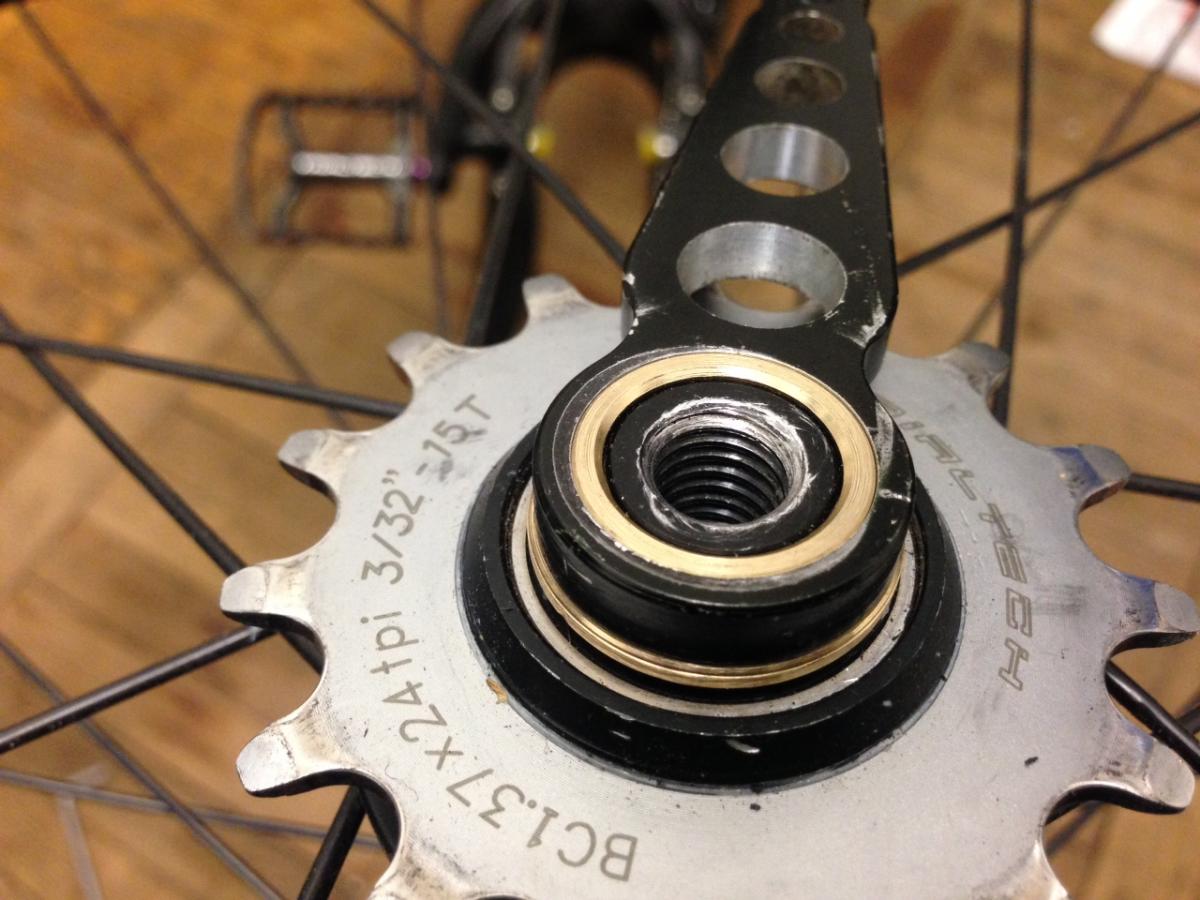

I wound up dissecting the chain tug and removing this bit. The trialtech hub uses pretty big washers so they hold them in pretty well. Interesting. The trialtech hub uses a huge m10 bolt but it doesn't seem to be able to resist the pedal forces. The heatsink tensioner was my final resort if this didn't work. I wanted a rolling instead of a rubbing solution. This is much lighter as well. -

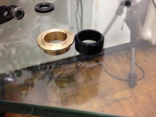

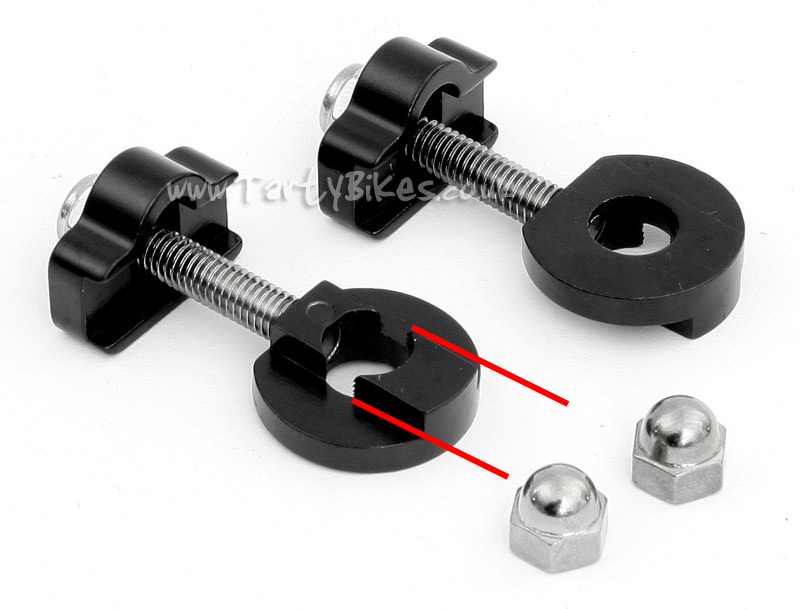

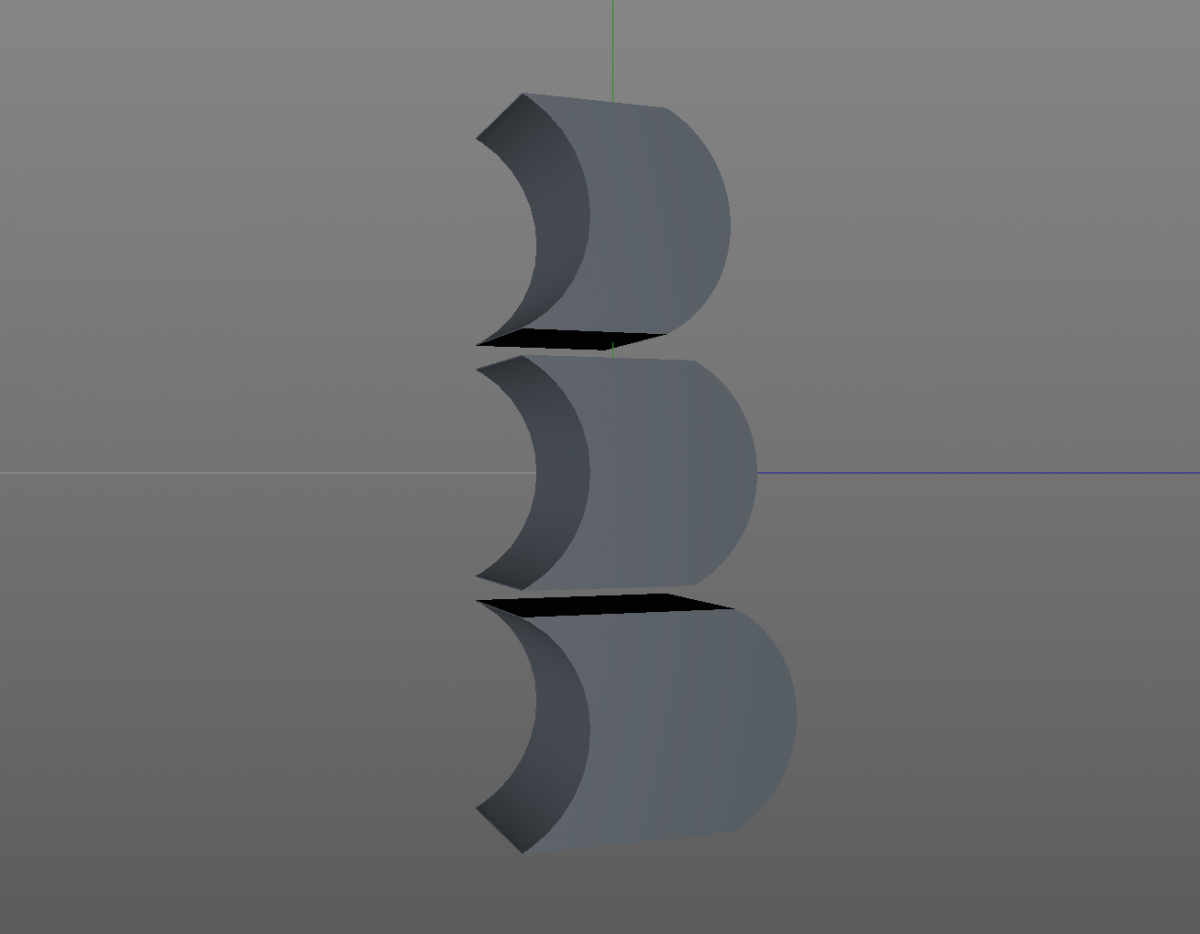

You got one laying around? Can you post a pic? Thanks, I didn't think it needed to be knurled because its capped off with the serrated washer. I think the knurled spacer is for when you leave out the washer for use with snail cams. -

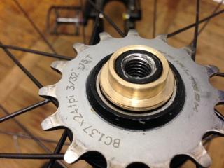

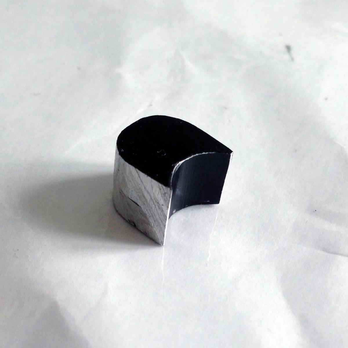

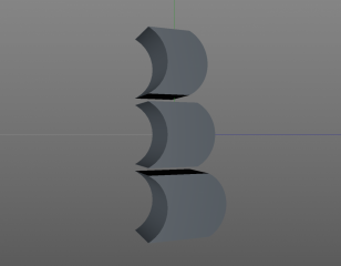

I just happened to have a friend with that tensioner and didn't want to accept the fact that it wouldn't fit. These things come out of necessity. I also ran into another necessity while installing this. Without snail cams the drive side axle would back into the dropout due to the pedal forces. I had to push a small round piece of metal into the dropout to act as a stopper. I have some trialtech chain tugs laying around. I noticed the shape of the part that slides into the dropout. So I thought different size spacers to wedge between the inside of the dropout and the axle would be a good little helper to have. The washers hold them in place nicely on my setup. Hopefully I can get these made as well... -

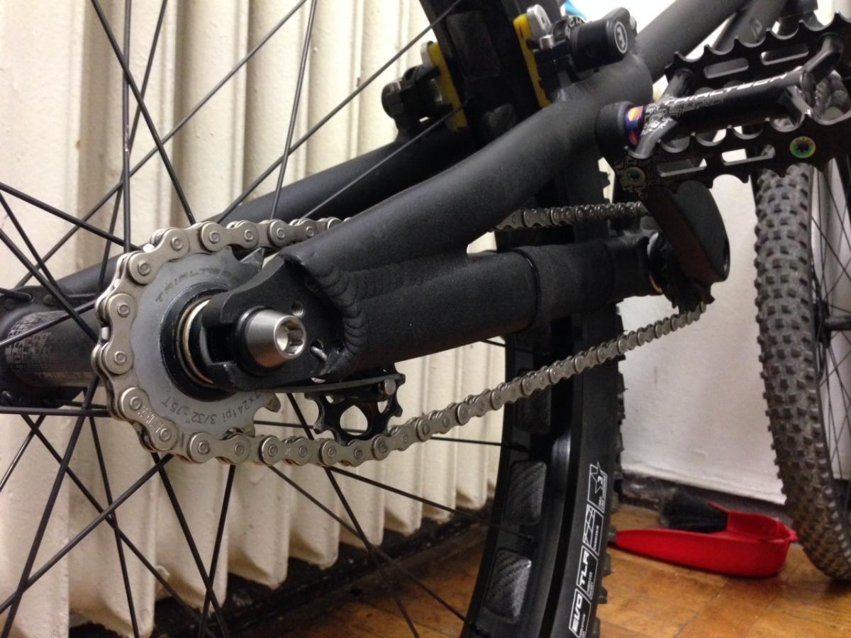

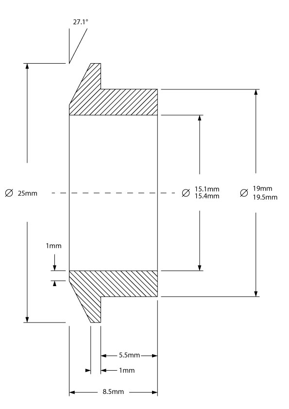

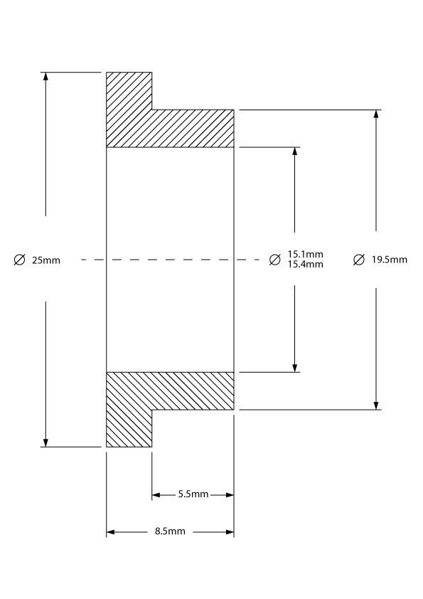

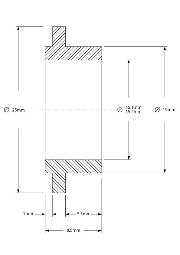

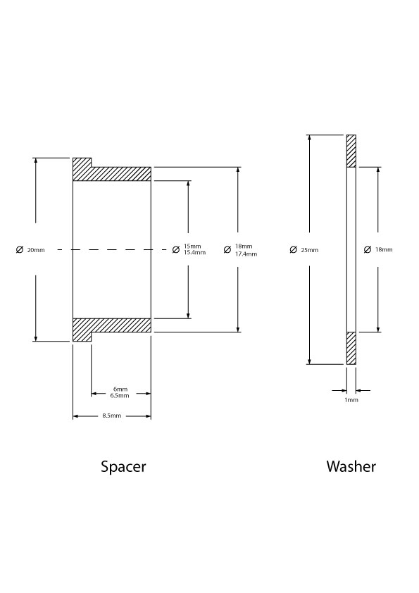

I've been having massive chain tension problems. Just no sweet spot between under and over tension. The only elegant solution I saw was the echo sprung tensioner but it doesn't fit my trialtech sport lite hub. So a friend of mine purchased a new echo tensioner and gave me his old one and I went to the drawing board to come up with a solution that would make it fit. This is what I came up with. I basically had to create a spacer that would hold the tensioner. Took me 3 designs till I came up with the final one that works. 1 2 final 3 3.1 I got a friend to make me a prototype. Brass was the only thing he had laying around. I'm not sure if thats gonna hold but the final version is gonna be steel for sure. Spacer next to the original Hub with original spacer Hub with new spacer I also had to machine open the tensioner itself to fit over the new spacer. Everything attached It worked out nicely. I used an old spoke to make a tension spring. There was just enough space on the right side to wrap the spring around the trialtech serrated M10 bolt spacer. I stuck one side of the spring in a snail cam bolt hole. I stuck one side of the spring in a snail cam bolt hole.

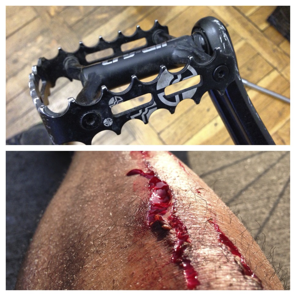

I never need shin guards as long as I have them on. I swear my pedals have never touched them. Its only when I don't have them on that I need them. Then this happens..
