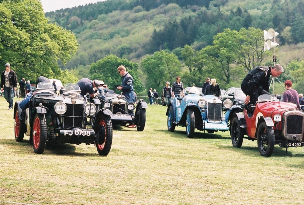

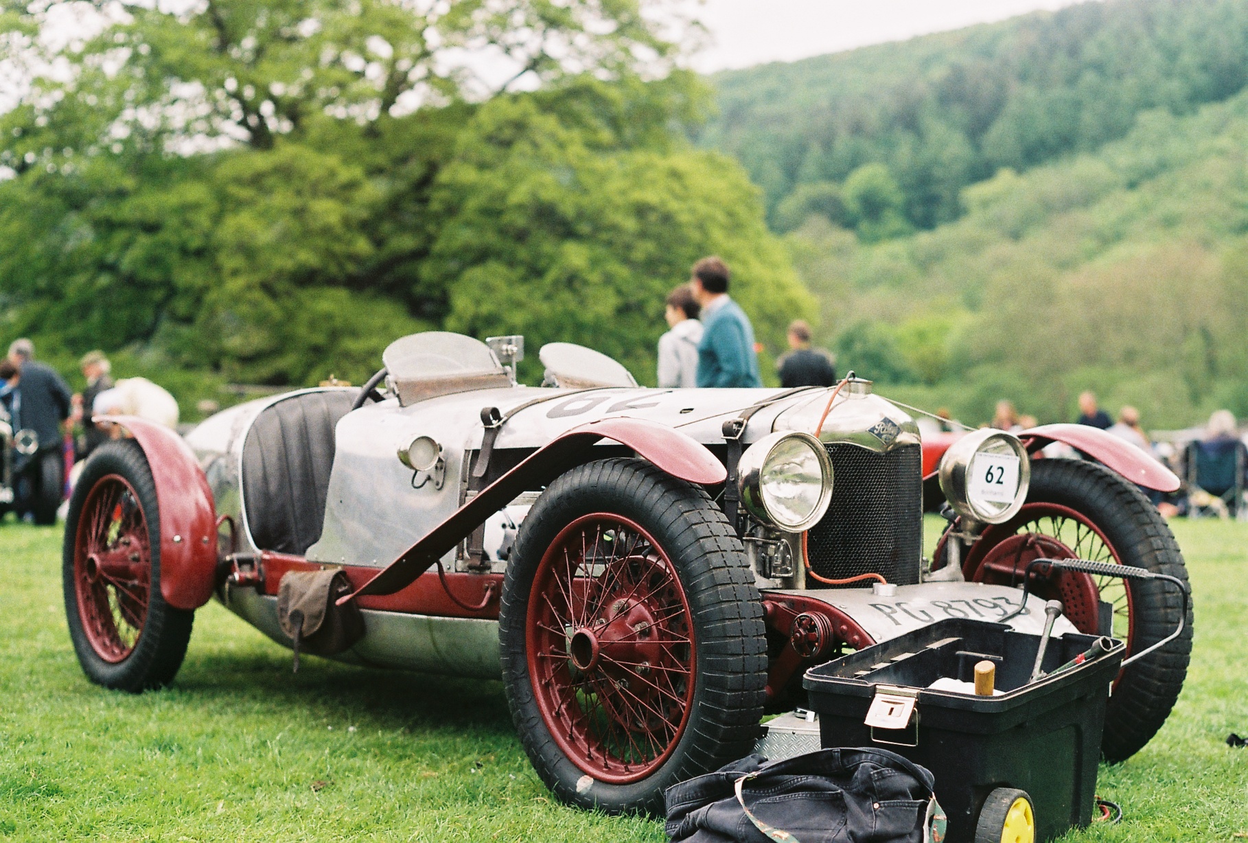

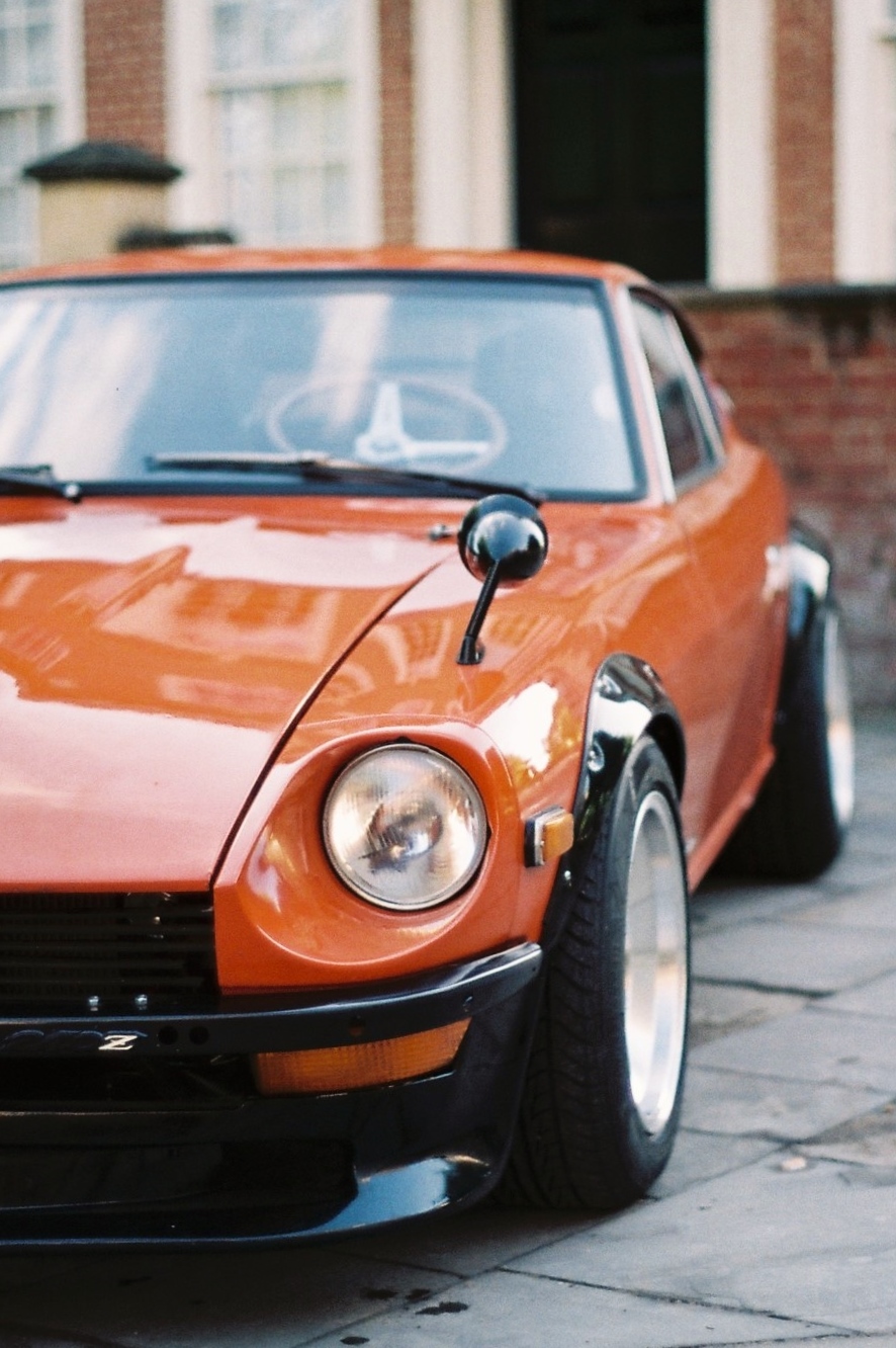

Thanks guys. They were all on a Minolta x500 with a 58mm f1.4 rokkor lense. Mike, I'm not sure if you've been to Wiscombe before, but it's well worth it if you haven't. There's always good photo opportunities.

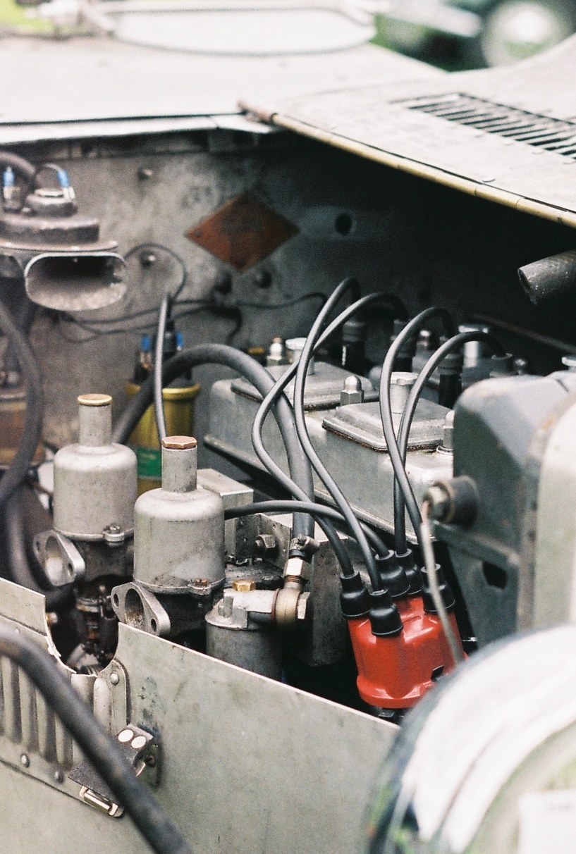

I picked up a couple of films from being developed earlier, some of shots were car related: My friend Ollys stunning Datsun 240z: And some photos from the VSCC day at Wiscombe park. I know nothing about these vintage beasts, but they're bloody enjoyable to watch attacking a tight hill-climb at full-bore!

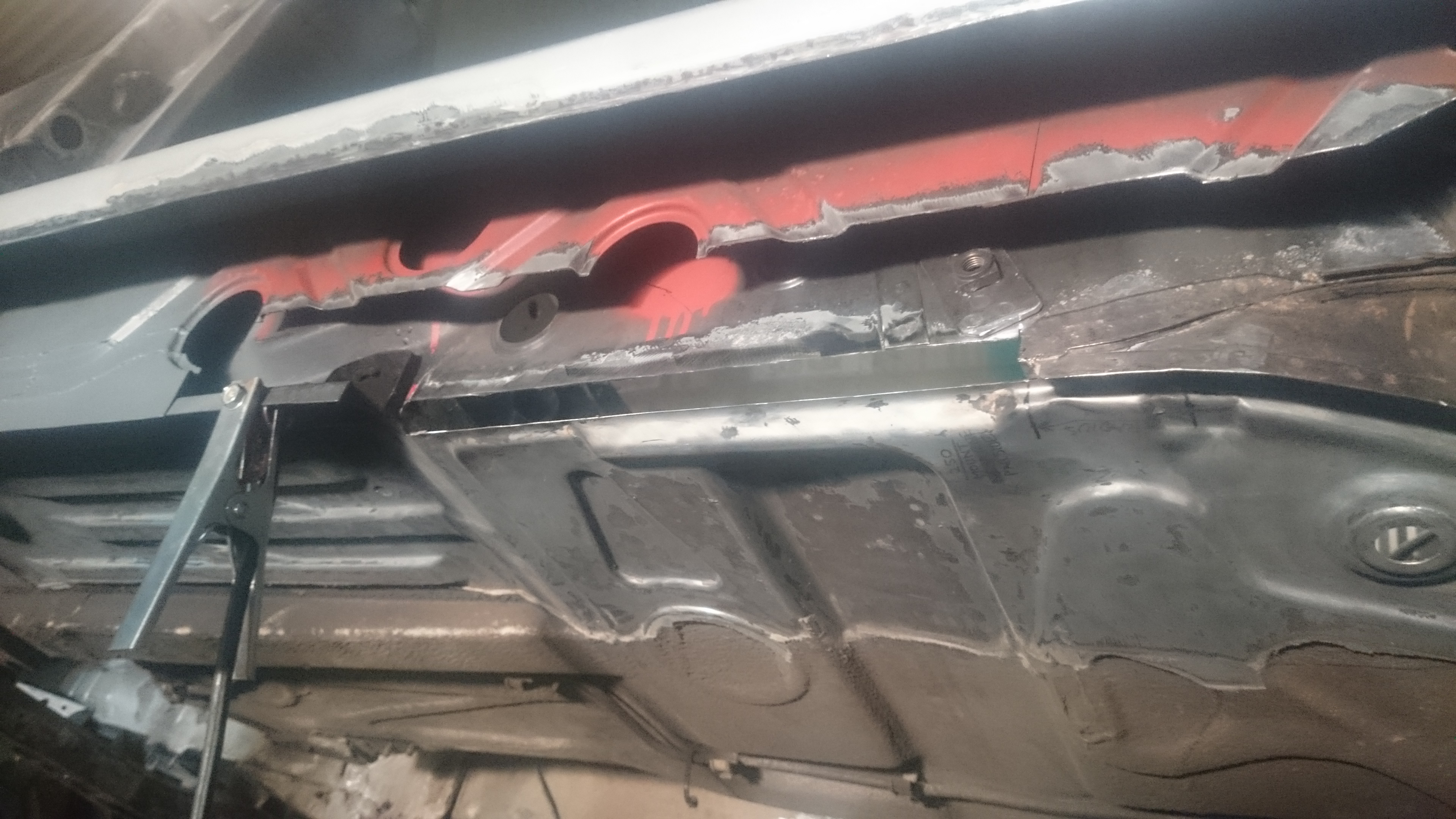

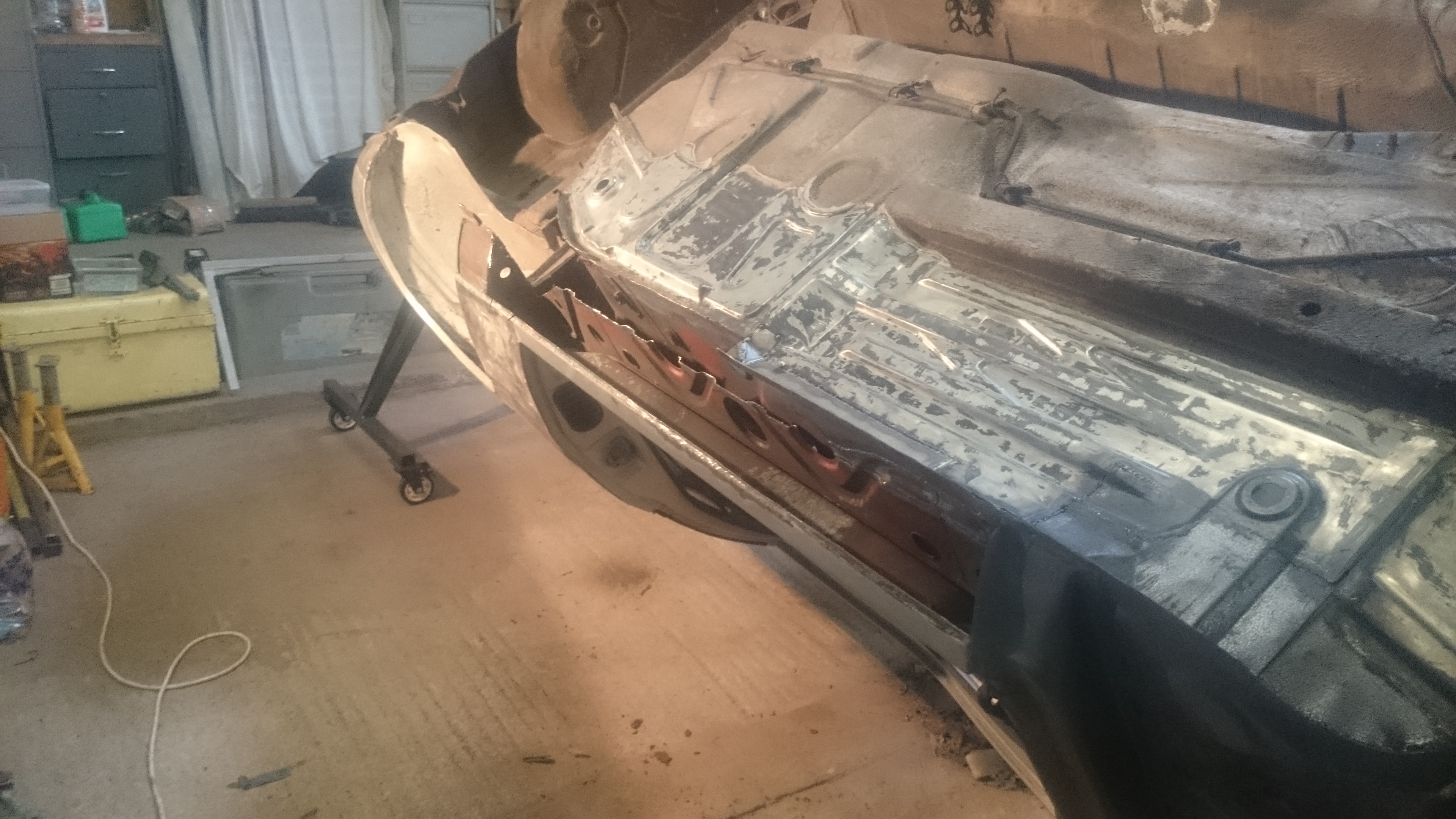

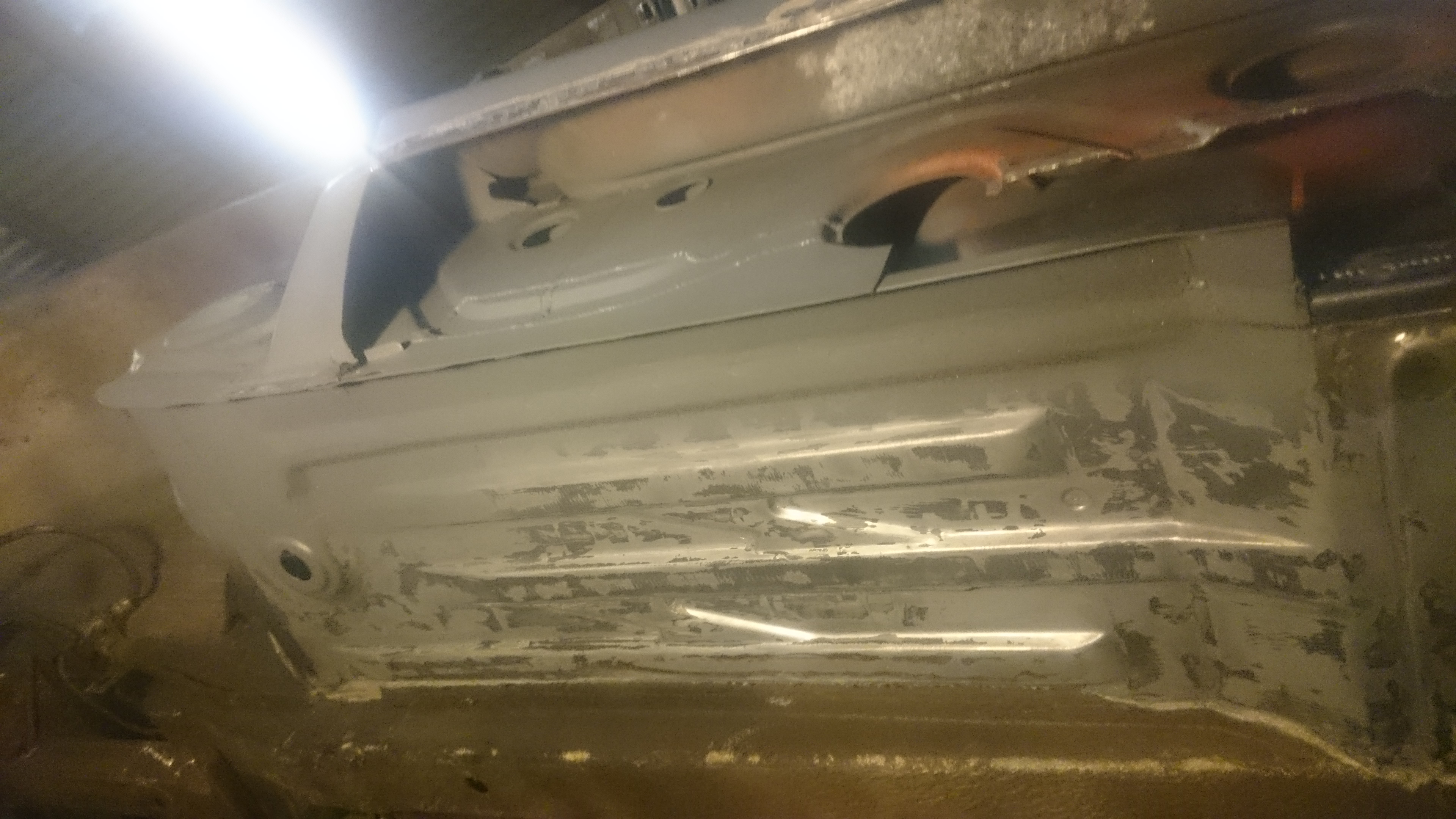

I like the interior colour Dan. I'm probably going to do mine a similar colour soon (although with a slight blue tint to it) with a view to the outside going the same colour in the long run. I can't remember when I last updated you guys on what I've been doing with the Porsche, but I've now got both sills all welded up so I'm able to finally move onto the fun modifying, rather than just undoing 30 years of neglect. Here's a few shots of the sills: Big hole number 1: Inner sill and floor edge all rebuilt: Outer sill welded on and all ground back, along with tubes to take sill stands (I need a new rear quarter panel before I can close that hole at the back up): Big hole number 2: Inner sill & outside edge of the floor, and the bottom of the a-pillar all rebuilt: And finally the outer sill welded on along with the sill stand tubes again: So now it looks like this: I'm currently cleaning up the interior to get rid of all the adhesive from the sound deadening (it's ALL gone, bitumen included) then I can decide on a driving position and mount the seat and pedal box, which will let me start on the cage. I'm looking forward to this next stage, changes are always more fun than repairs in my eyes.

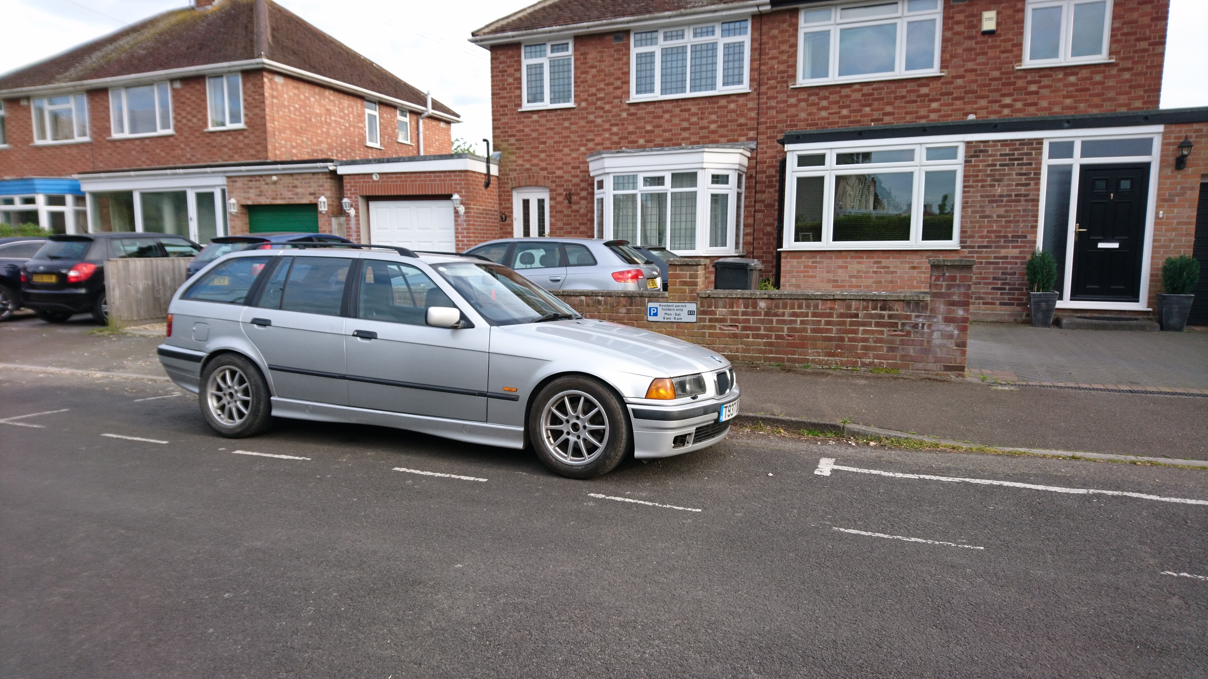

Oh yeah, my e36 (which definitely isn't going sideways anytime soon with 90bhp!) now has another 12 months MOT and a slightly lower front end.

Looking bloody good Dan, I bet it's going to be a right laugh to drive! My e36 failed it's MOT on a front damper leak, so I've got some coilovers in the post for it. Only cheap ones, but I know a few people who have had them on e36's with no complaints and I don't plan on setting them particularly low at all (probably around 40mm lower up front and 10 at the back). I still made sure to buy them from a UK retailer with a 2 year warranty though. It'll be nice to feel a bit happier about how it's looking.

Yep, water building up in sills doesn't end well. This sill looked fine on the outside, the edge of the floor had some holes, this is what the inside looked like: And that's a galvanised car!

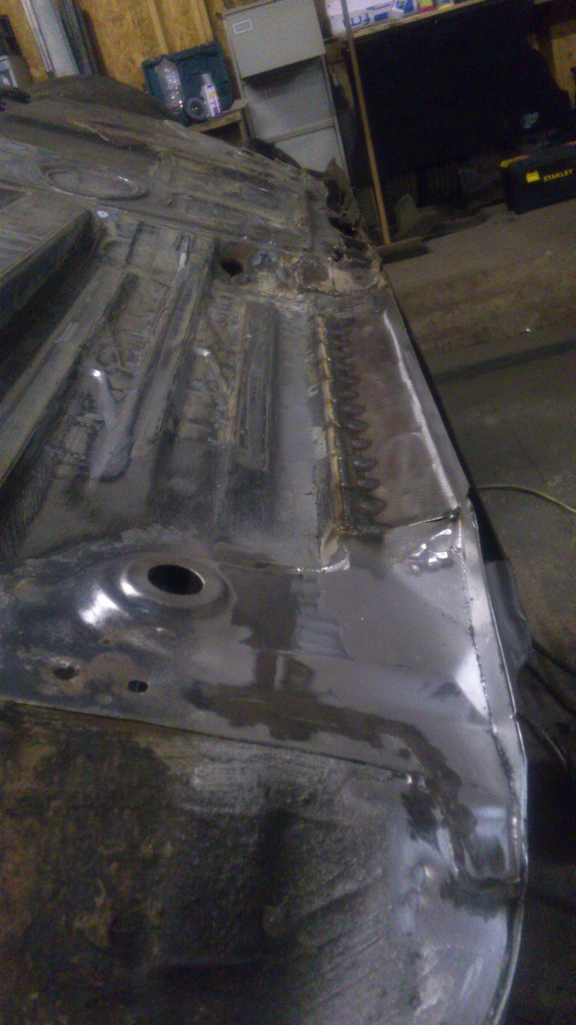

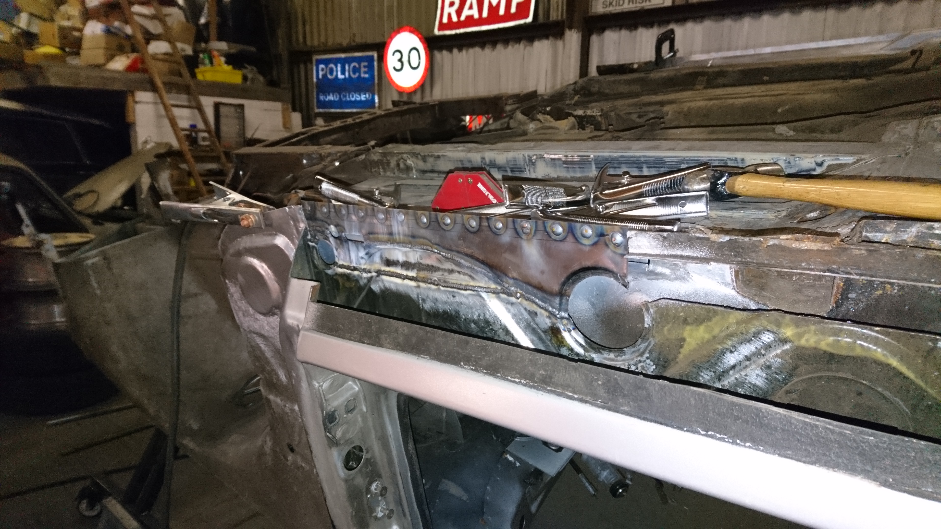

Coloured wires? On a renault?? Last time I worked on one the bell-ends had just used white for everything, making it a nightmare to fault find. Or is that just the cabin looms? I also use the a38 every day, but on a bicycle. In fact I live about half a mile away from it. It's a bloody long road! I managed to spend a couple of productive afternoons on the 924 this weekend. Now there's an even bigger hole in it than at the start of the weekend! On the bright side, solid metal has started going back in, and near enough all the rust's not cut out of the passenger side. Also, I made a sheet metal folder, because tools are good.
