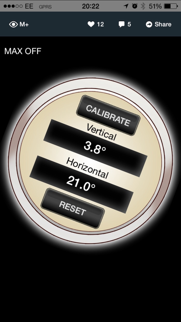

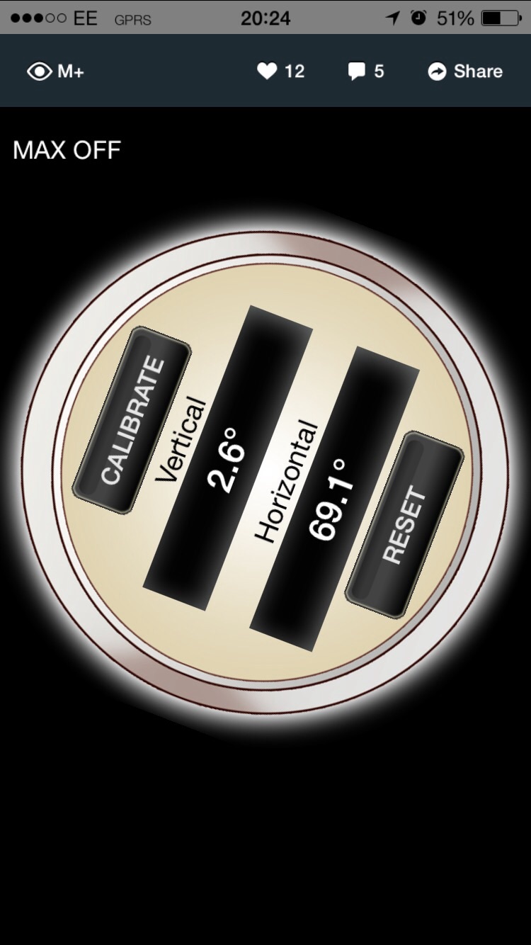

  6. Paul: 1) Centre of crankshaft pulley to oil cap is 430mm on mine 2) Left to right engine angle: 3) Front to back engine angle: Angles taken using an app on my phone, taken from the flattest part of the rocker cover I could find. I've not used the app before...hopefully it makes sense! (Ignore the vertical angles)

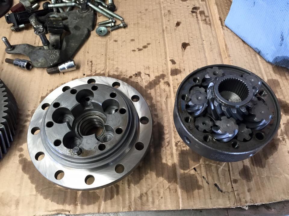

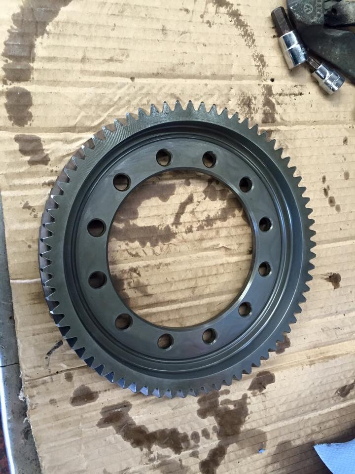

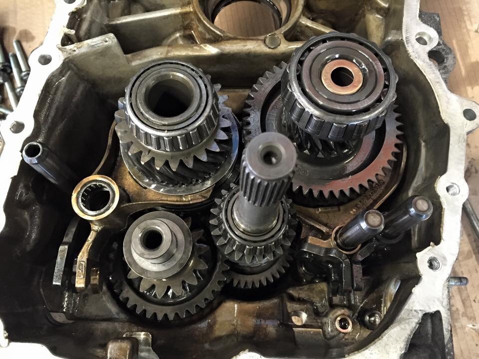

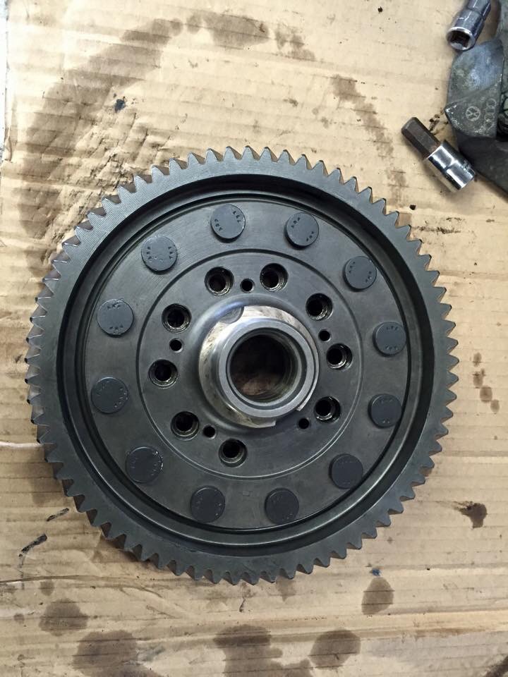

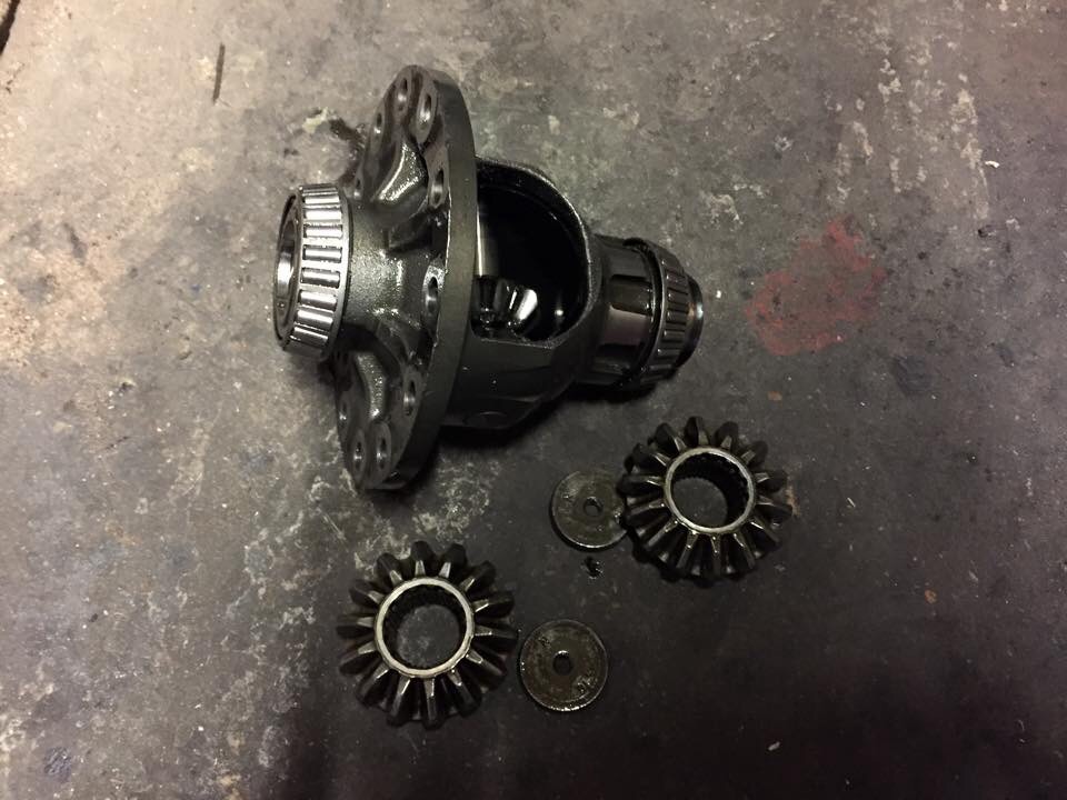

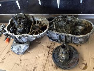

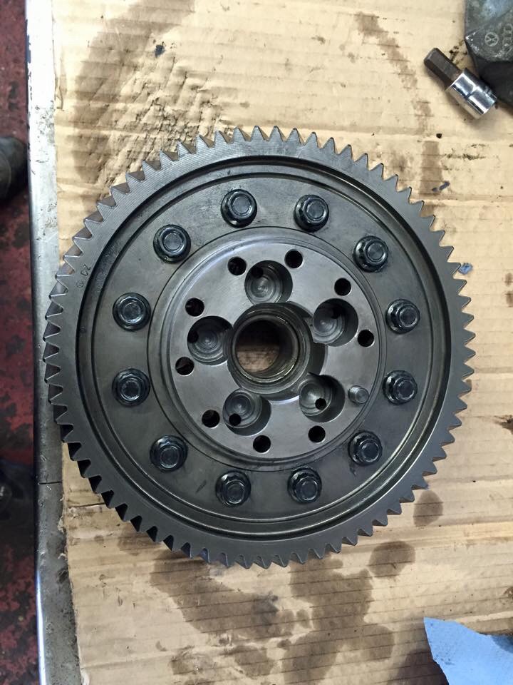

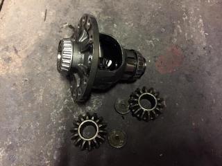

  12. Busy day today, started my LSD install. Spent an age drilling the rivets out, they were mega hard! Needed a 10 ton hydraulic press to get the studs in too...fortunately I was doing it in a friends workshop! Box split open after removing 234565 bolts. Standard open diff showing. Drilled the 12 rivets out to seperator the crown wheel, then chucked the stock diff in the bin Crown wheel cleaned up and ready to meet the new LSD LSD split open, with the top half cleaned ready to be mated to the crown wheel (look at all those metally guts!) All the nuts fitted (with the supplied lube), and torqued to spec Backside of the new LSD, showing the ridiculously expensive (£120 for 12!!!) ARP studs pressed in The guts of the VAG 02M, in all their naked glory!
