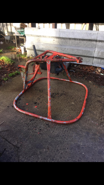

    I need a beam screed as I have a load of concreting to do on the farm and it makes for a far better quality finish than doing it by hand. We rented one last time we did some and it was great, the trouble is it was £150 for 3 days and we need one for 2 weeks and then again later this year. They are £1500 new which is absolutely ridiculous and command decent prices secondhand. They are very basic, using an off balance shaft driven by the engine to vibrate the beam, bringing air to the surface and creating a decent surface for outdoors or for further trowelling later if you want it super smooth. So I delved into my scrap bin for my finest rusty off cuts, ordered some bearings, pulleys and a belt. I found a Honda GX160 clone for £50, shoved a new carb on and gave it a service and it ticked over as good as new. Some choppy choppy, melty stick, recycled belt guard, sloppy paint, crossed fingers later and I have a menacing, vibrating, piece of wood with an engine on top! Under £100, a day to build and it seems to work when running on a solid surface, it'll get its maiden run tomorrow

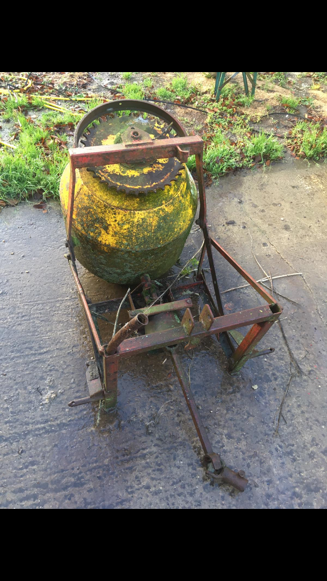

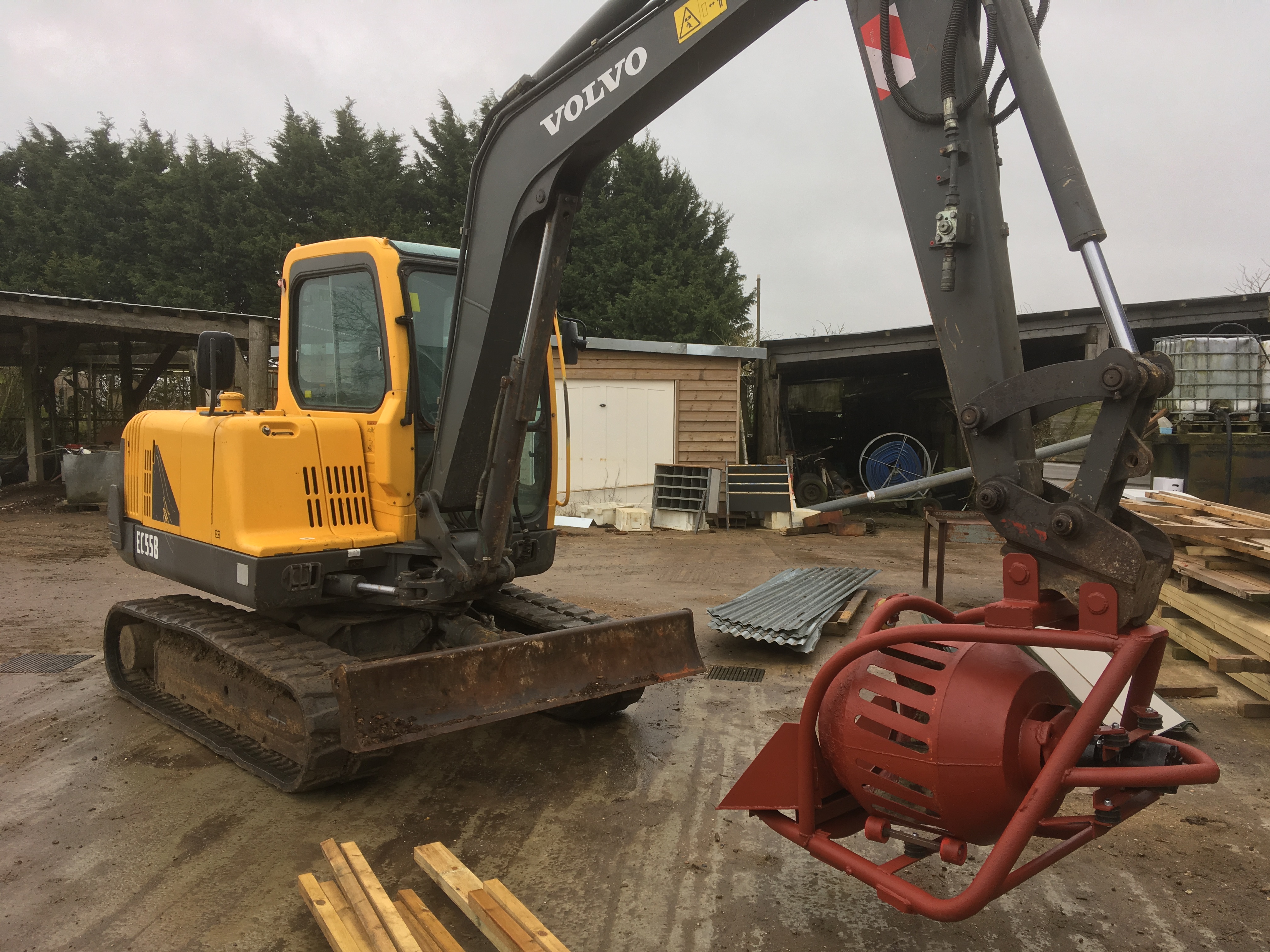

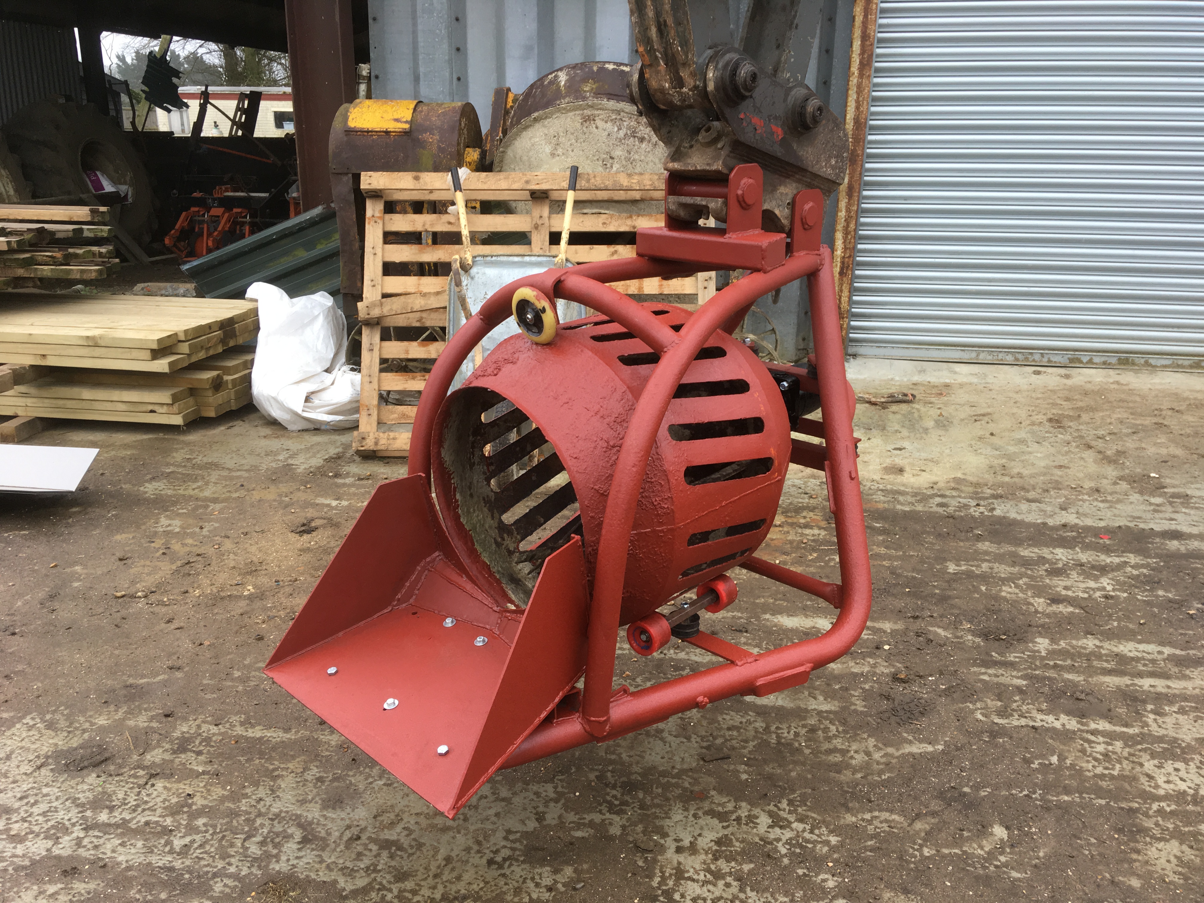

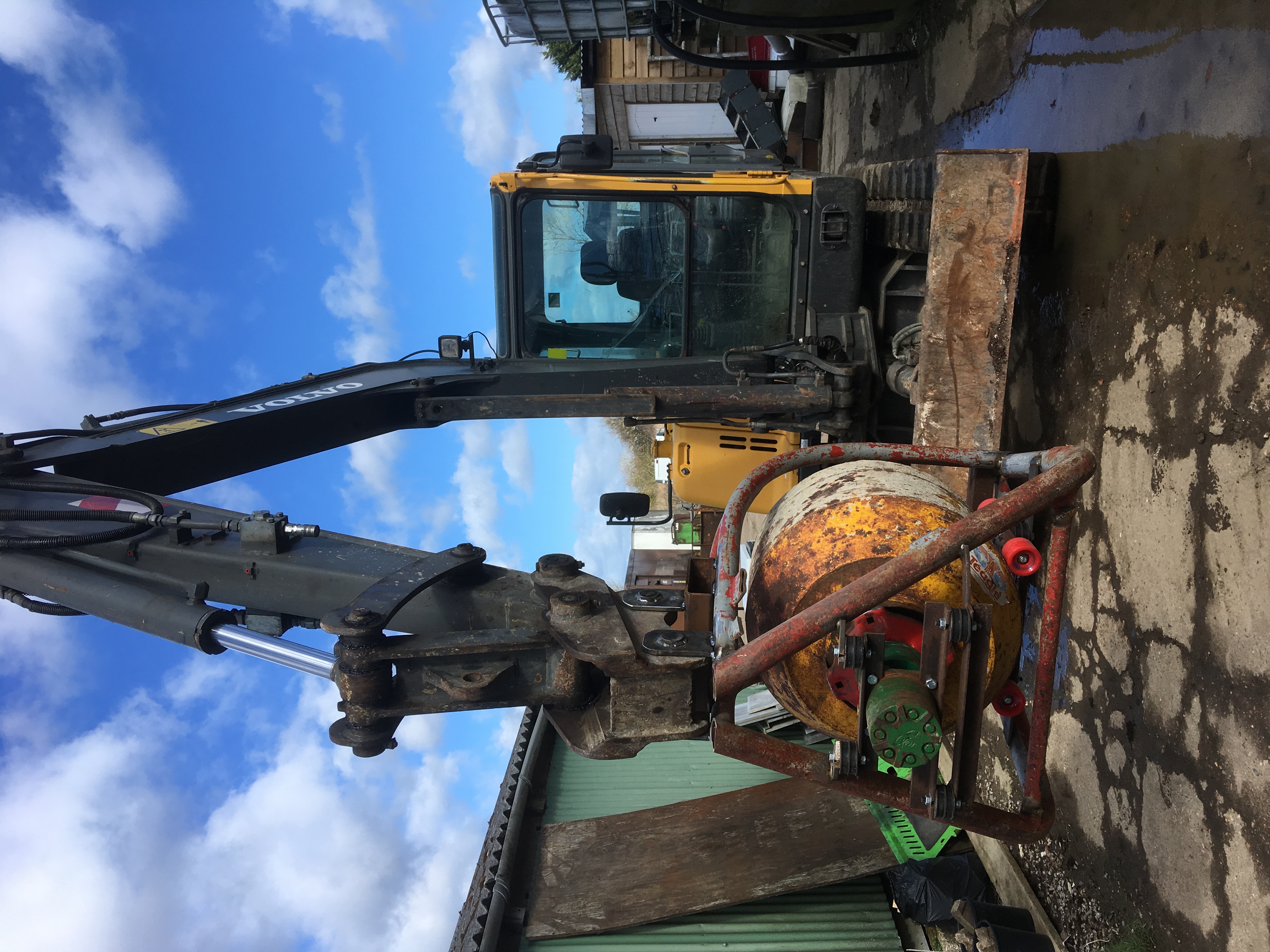

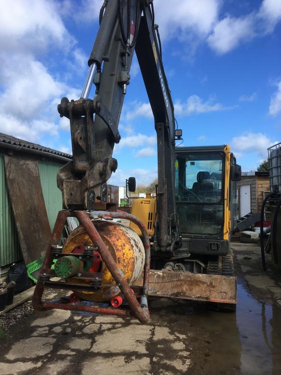

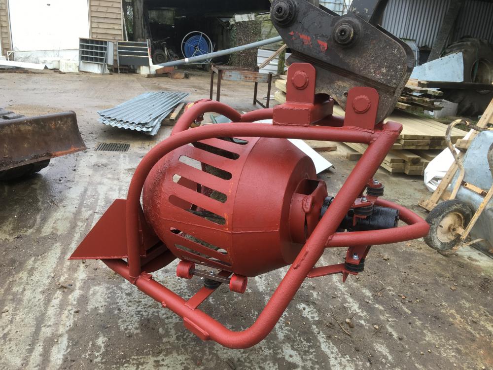

    I have had some fun making an attachment for my little digger. I have quite a lot of soil with bricks and rubble in to sort through and wanted to screen it fairly effortlessly, unfortunately they start from around £4000 and my budget wasn't going to stretch to that. So this is a soil screener built from scrap, mostly an old cement mixer and fertiliser spreader, the only new parts are the guide wheels, rubber mounts, hydraulic pump and hoses. The plan was to keep the cost at £500 all in...including labour! Landrover gearbox mounts keep the hydraulic motor and guide wheels isolated from vibration, longboard wheels for the guides and an old ram piston was perfect for the bracket pins! It's rough and ready but seems to be solid enough for my needs, the wall thickness of that tubing is pretty mighty! Unfortunately I've not had soil dry enough to test it properly but it is working pretty well with the wet stuff I've got so I have no doubt it'll work fine when dry!

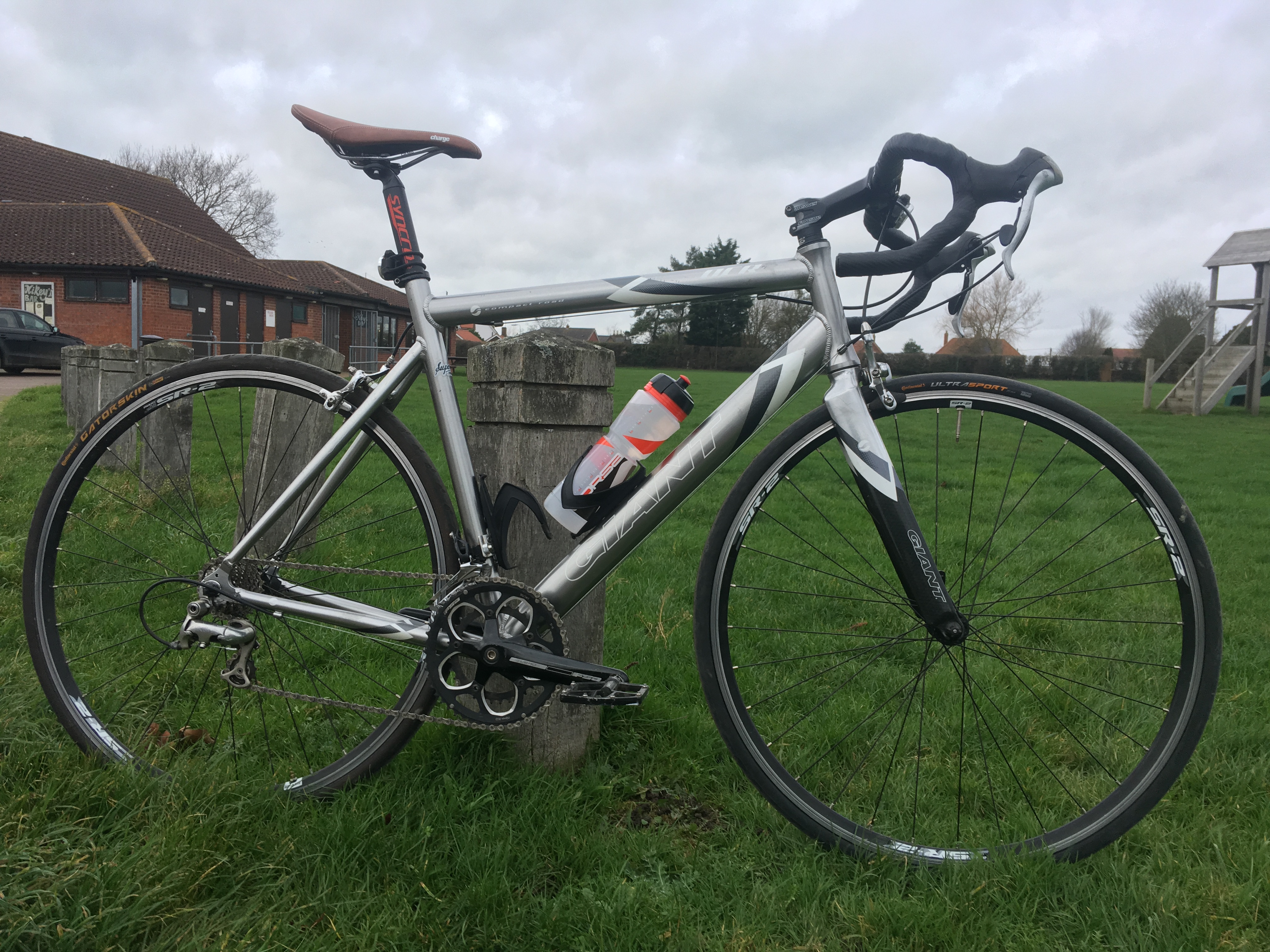

  13. I managed to get this mint condition Giant frame and carbon forks for £40 and swapped all the bits off my Raleigh Airlight along with a few new bits (105 braze on front mech, Continental front tyre as my other one was too tall and fouled the brake and an Ultegra rear brake that has just arrived). It rides so nicely, I'm very happy with it considering it has cost me a smidge over £100 to build overall and pretty much everything is new/like new Obviously not bike porn but more than adequate for the occasional rider!

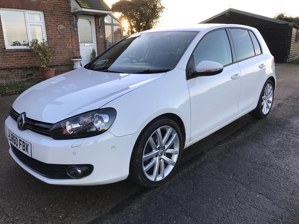

  14. I've been looking after a 05 1.9 TDI Touran for a friend whilst he travels and I've been pleasantly surprised by how capable, spacious and even though its only 100bhp it doesn't actually feel as horrendously slow as i had expected. It has done 189k and apparently has wanted for very little for the 130k he has put on it. Well worth considering and pretty cheap. Unrelated news, we got a MK6 Golf GT 2.0 TDI the other day to replace the Astra H, I know it's just a Golf but I'm always impressed by these old things as they seem to age far more gracefully than most other brands. We went with an automatic this time and it's so silky, for an everyday car for A to B I don't get why people bother with manual boxes anymore.

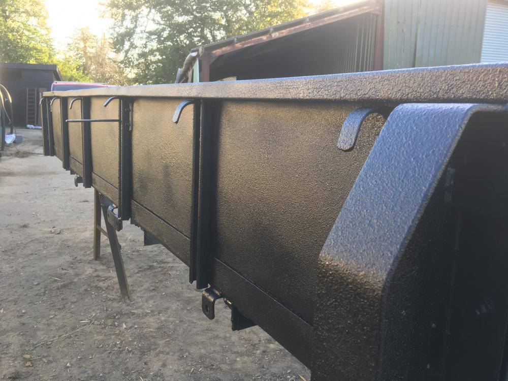

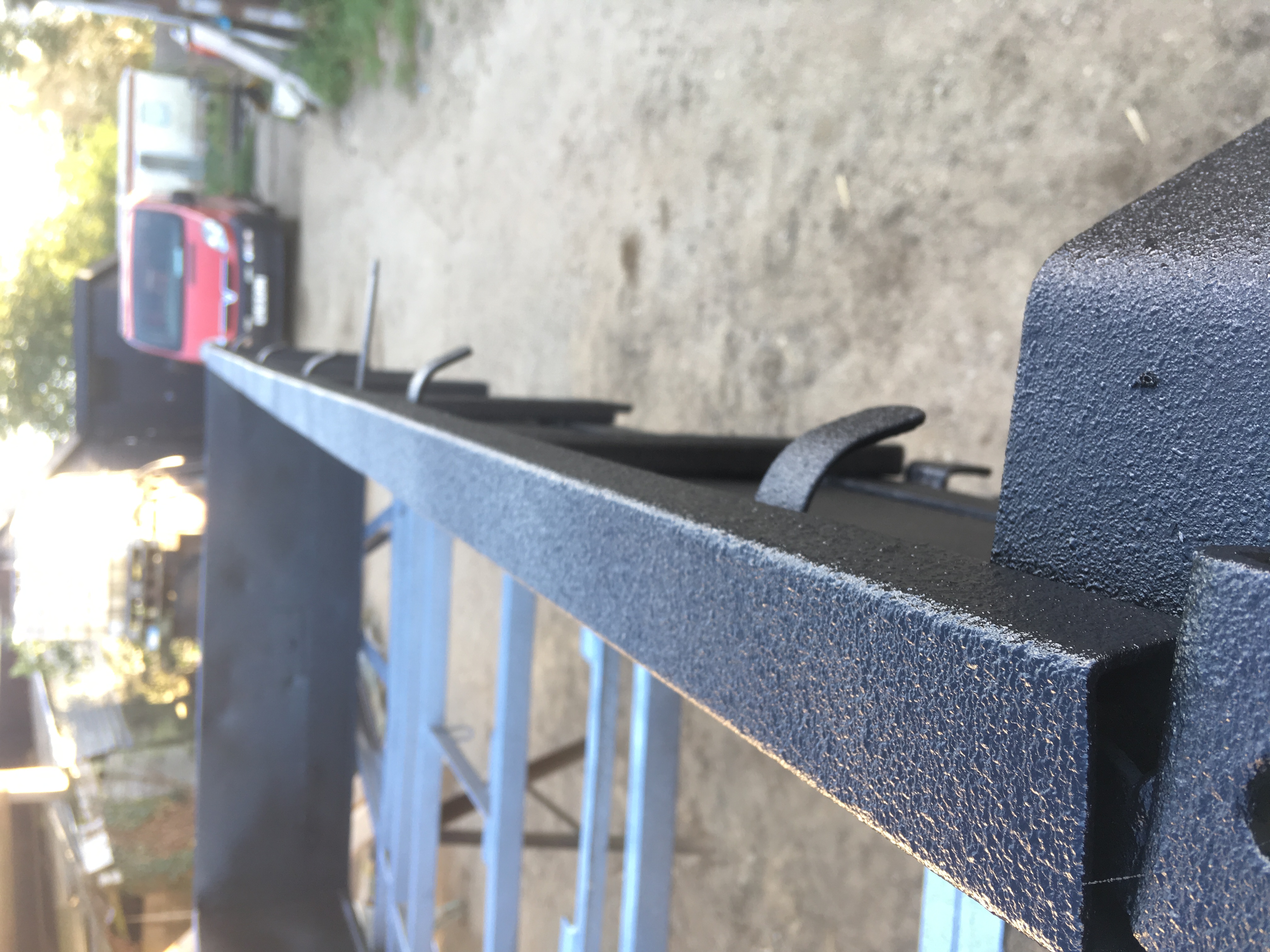

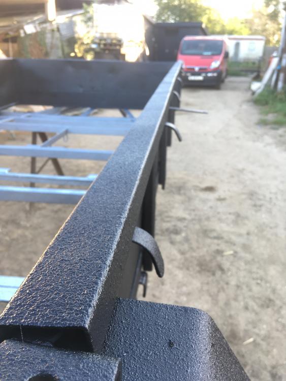

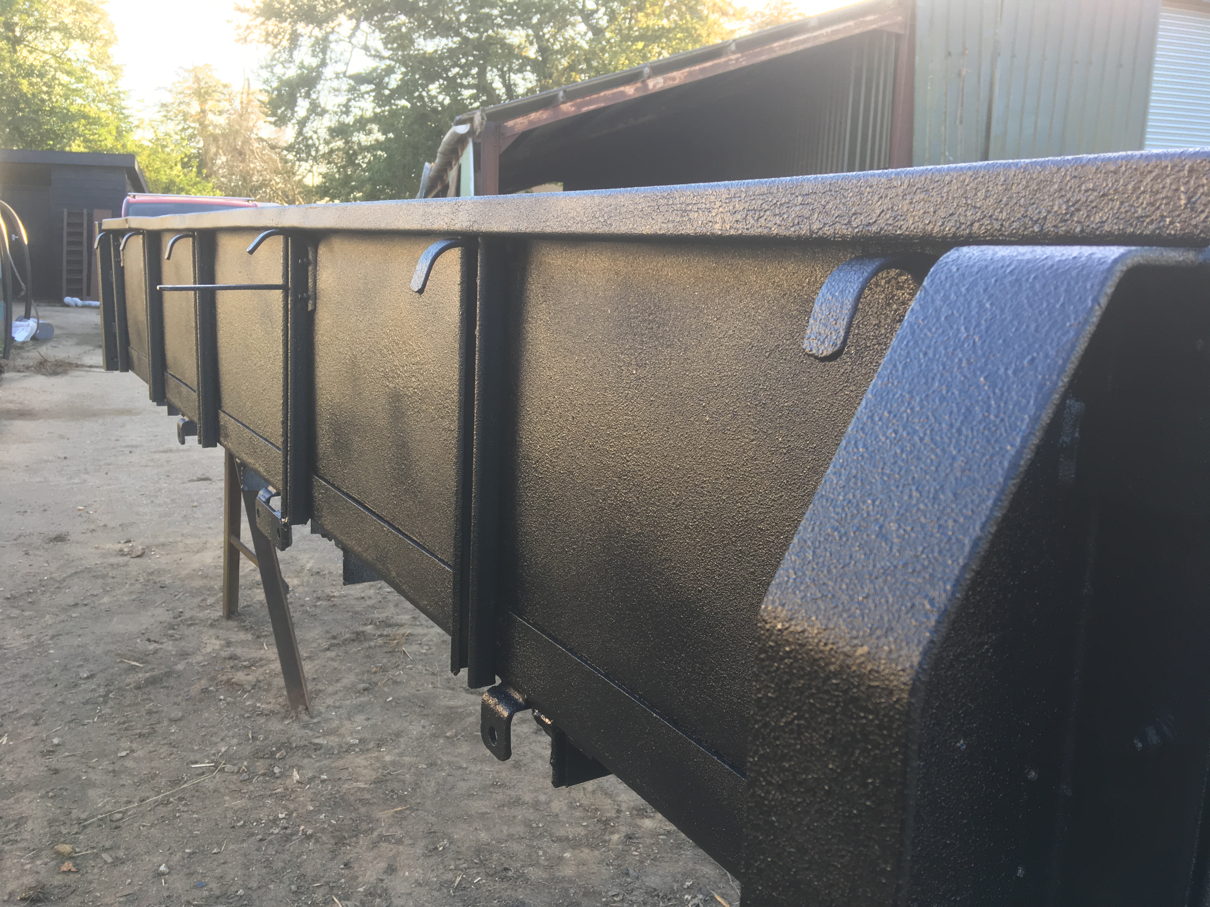

  16. Missed that advise and got it coated... No sign of shrinking, a 4 bottle pack just about did the 10x5 foot trailer inside and out! Fingers crossed tomorrow it will still look the same...
  17. I've ordered some, I didn't want to spend any more on it but I also want the sodding thing out of my workshop! Fingers crossed it works! Yesterday I tried painting red oxide on the chassis over the top of the stonechip and it didn't react at all, I don't get it?! Anyway I'm just going to blast a load of waxoyl style stuff underneath to ensure water can't get in too easily and that'll have to do, it'll only get used on local roads and most of those don't get any salt during the winter anyway!
  18. Cheers Tom, I left the red oxide a day which is what I would usually do and never had issues before. The previous paint is of unknown type, likely cheap and cheerful (or not in my case) though. I was looking at the Raptor paint, the trouble is I'm not ready for 2k paint yet as I don't have the mask as per your advice and I'm not in the position to buy one because of this bloody trailer! I assume there isn't a 1k equivalent?
  19. Not quite car related but it's for my car and it's paint, I know @Tom Booth will probably have the answer! I bought an Ifor Williams trailer recently, it's galvanised but has been painted in the past as some areas have become worn and rusted. I stripped it down, sanded back the paint to key, treated any rust with the Bilt Hamber stuff and primed treated areas with red oxide. Now because the thing is a bit beaten I thought covering it in Tetraseal stone chip would be a good idea as it'll resist wear and tear and when applied with a Schutz gun it leaves a textured finish to hide any sins. Unfortunately the stuff has reacted (crazing as it's shrunk) just about everywhere and I can't understand why as I've had success with it before. I feared that I had maybe put it on too thick, but when I experimented in other areas it didn't make a difference, I'm assuming it's too high a solvent content that is causing this. I really can't be arsed with stripping it all back again, I haven't got time and need it operational within a week. Is there any other type of paint i can slap over that won't react? Do I resort to using Hammerite as that seems to stick to just about anything? Do I need to give the stone chip some more time to fully harden before I can coat over?
