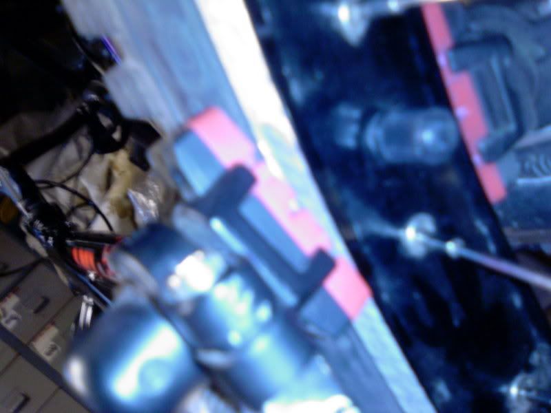

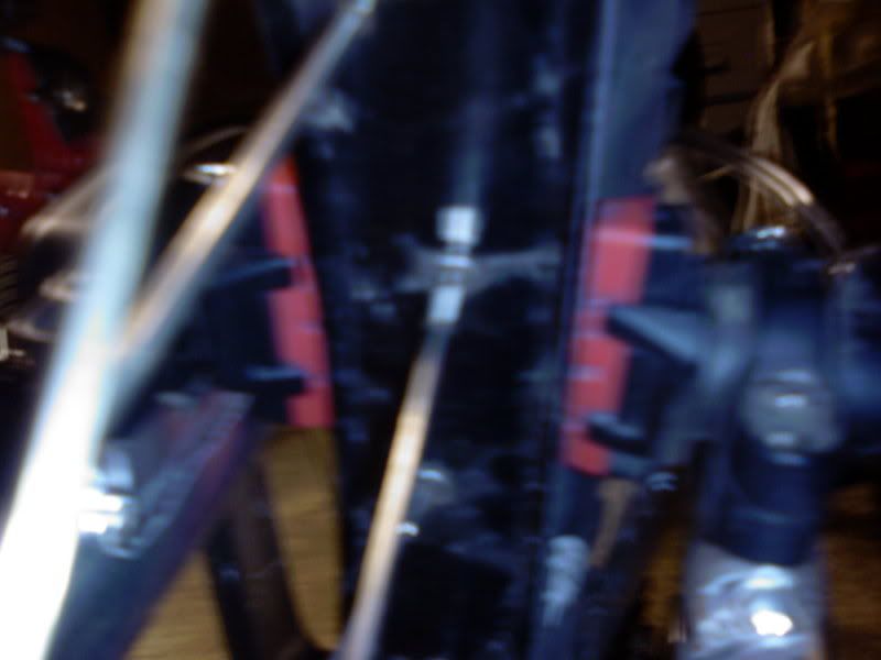

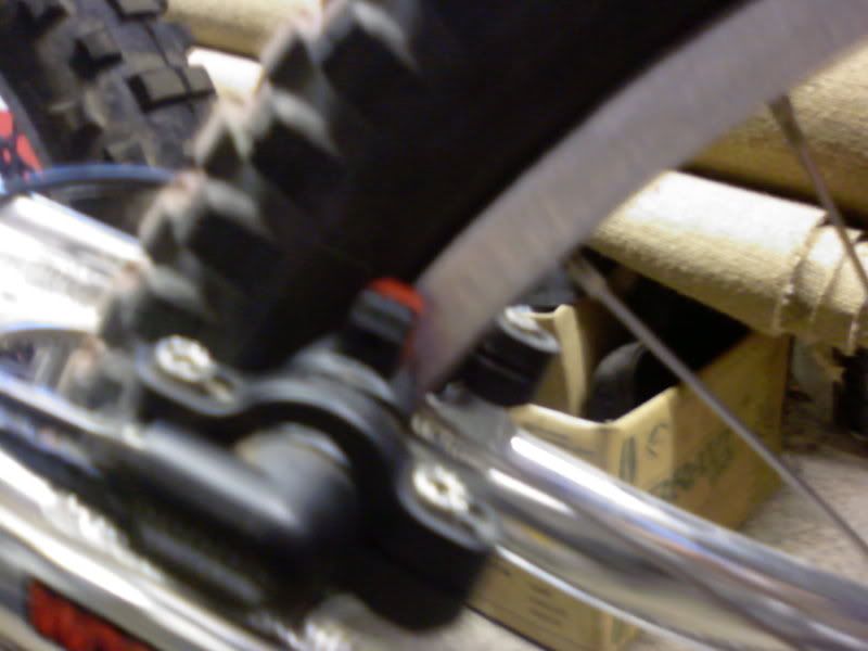

hey I've only been riding bike trials for 4 weeks had a couple minor problems along the way but now I've messed it up again and i really don't know what to do.
I got a few pictures, I'm just wandering if the best thing to do is take it a bike shop or is it an easy fix?

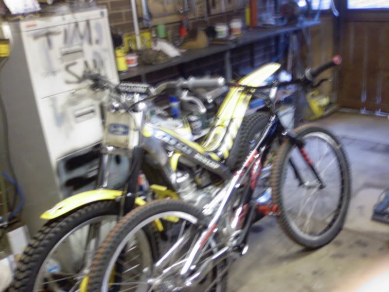

and one of my old gas gas txt200 -
http://i141.photobucket.com/albums/r42/OMSIBF/Photo-0059.jpg
sorry about the bad quality all pictures where taken on an old phone and i was cold and shivering.
just read the wiki bit and is it a lazy piston? if so is it easier and cheaper to get it fixed at a shop than doing and making a mess of it myself?

thanks. you make it sound really easy but is it really easy even for beginners? also i was told it was a lazy piston i read how to fix that on the wiki page and that didn't seem easy.
How much do you reckon it'd cost to get someone else fix it?
Its all pretty easy really just either undo the bolts on the magura and then realine the piston/pad and then you are ready to go and if it is a lazy piston then if you have a tpa then twist it to the - side then spray wd40 but just dont get it on your rim because the smallest spray is bad.
Other then that buddy it at all that hard really but when you do realine the brakes then make sure that before you do it again twist the tpa to the - sign then readjust the brake as the tpa is used really for wen your pads wear down mate.

Lazzy piston:undo the magura bolts take the affected side pad out pull lever and hold while spraying a little bit of wd40 on the cylinder then operate the lever and wipe off the cylinder put pad back in adjust ur cylinder up to the rim job done.
