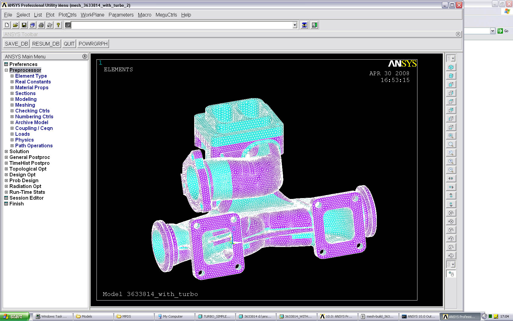

The mesh for a cyclic thermal analysis I'm currently building. The part in question is a piece of the exhaust manifold from a 50litre v16 diesel engine which puts out roughly 2000bhp. This kind of thing is a day-in, day-out occurence for me now.

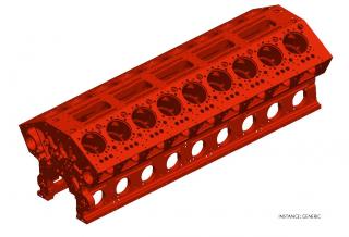

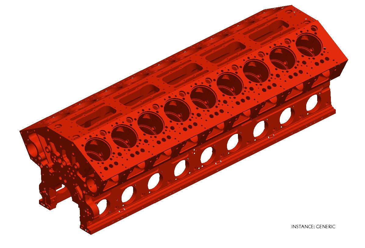

Some old work I was involved with. Had to remodel the block for our 78litre engine after changes were made to the casting molds by our supplier. I can't take credit for the whole model, but sometimes it's easier to start from scratch than work with (in this case) a poor initial model.
Sweet CAD models - Some of those engines are almost big enough for the average American pickup truck :P...
I presume they're marine or stationary engines? What company are you working for - Perkins are the only company I can think of in the UK that do engines that size?
ProE is my CAD package of choice too. You must be on a pretty serious computer to run models like that (and not spend most of your day waiting for the PC to catch up) though :).
I work for Cummins. Actually most of the engine go into mining applications, though we do do versions meant for power generation and marine apps. I'm more on the analysis side than the CAD design side (I'm the one that validates the new designs) so ProE is only really used to simplify models and build the necessary assemblies for whatever analysis I'm running. My true weapons of choice are Ansys Workbench, Ansys Classic, and FE Safe.
PC isn't too bad, but it does lack punch when dealing with complete engine schemes (dual 3ghz opterons, 8gb ram and 512mb Nvidia workstation graphics card) and for larger analyses we have a dedicated FEA server (16 processors, 128gb ram) in the building.

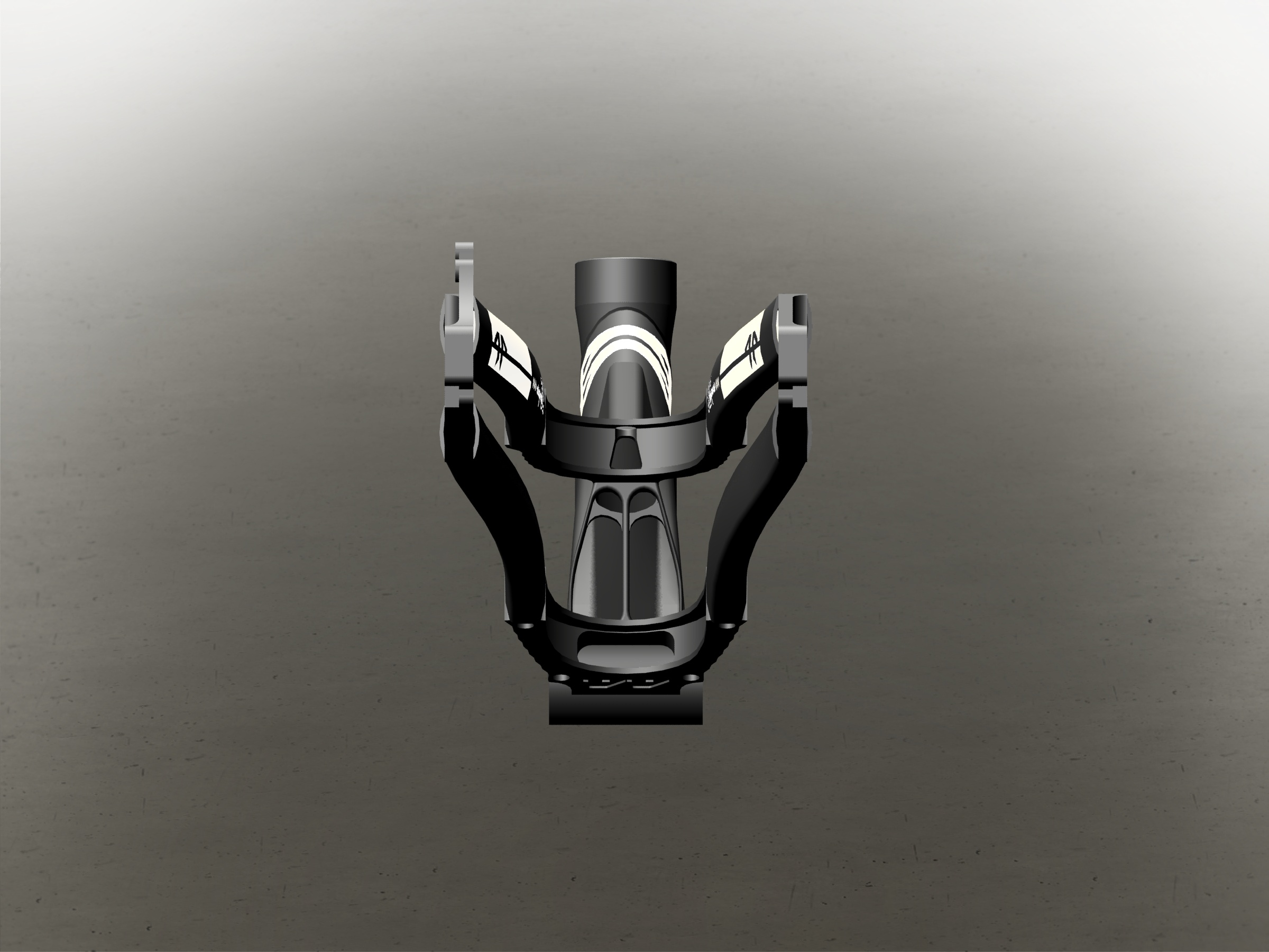

thats lush i would love a frame like that no joke if you could find somewere to make them with the options of your own choice of geo and thickness of the tubing and bracings you would be earning a lot of money
I'm building them, and am currently waiting on delivery of the last few tubes before they hit the shop floor, then onto testing, then into sales. The FEA is being run now.
If I can get the pricing right Adam will sell stock them I hope.
I'm also very into building custom geo frames for people who know the difference. They would obviously be built to order.
and she's light 1.6-1.7kg...
That's the plan anyway.
There can be rim brake mounts aswell.
