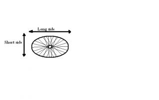

Sorry I don't understand, do you mean that you turned the wheel into an egg when building it or do you mean that you crushed your rima nd it now has a giant flatspot?
To sort out an egg shaped rim tighten all the spokes on the wide side and loosen them all on the short side.
Basically, the wheel is 'egged' as you're saying, where it is egged, the rim drops below the brake pad level, so in theory, would loosening the tension/spokes in that area and then tightening on the opposite side, pull the wheel back into place.

On the egged section (eg the high section) you need to go round in the following pattern, 1/4, 1/2, 1, 1/2, 1/4, so that's if the egg was 5 spokes long, if its say, 10 spokes long then it goes 1/4 1/4 1/2 1/2 1 1 1/2 1/2 1/4 1/4
Just keep doing that until it's round, that's how I do it anyway!
