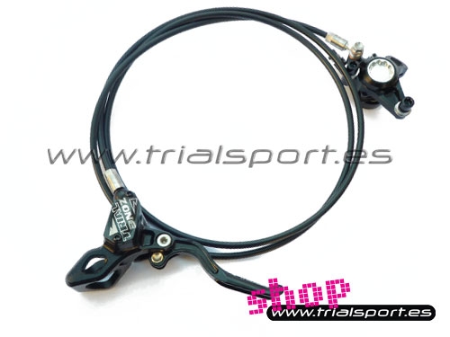

I love the look of these brakes, is it just the lever thats different or has the calliper changed too? Is it more powerful than the older style one?
Mark, how does it compare to stans magura marta because you said that was the tits, yeah?
