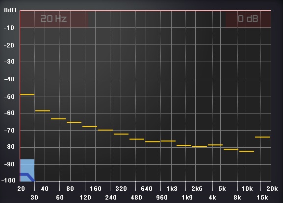

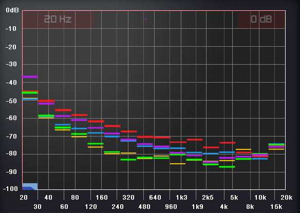

I was bored so I tried a sound analysis using an iPhone app. Put the mic on different parts of the frame. I've since built the bike back up. You only need to push on the rear wheel from the side with one finger to make it tick.
Started at the down tube next to the bb.
post-36904-0-69631600-1404671906_thumb.p

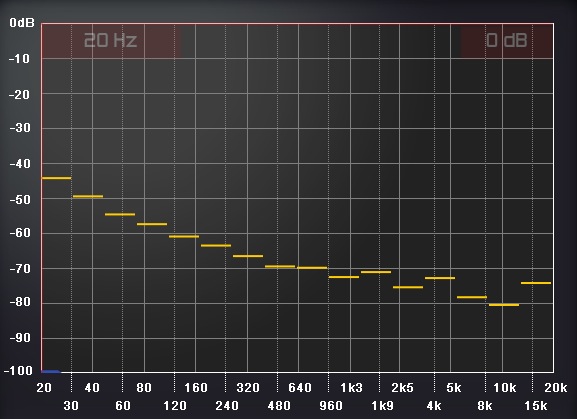

Right chain stay next to bb. Here it seem the overall frequencies are the loudest.
post-36904-0-74341900-1404671911_thumb.p

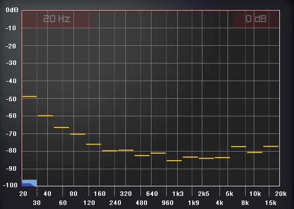

Right seat stay next to bb.
post-36904-0-36287000-1404671913_thumb.p

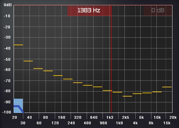

Left chain stay next to bb.
post-36904-0-44828100-1404671908_thumb.p

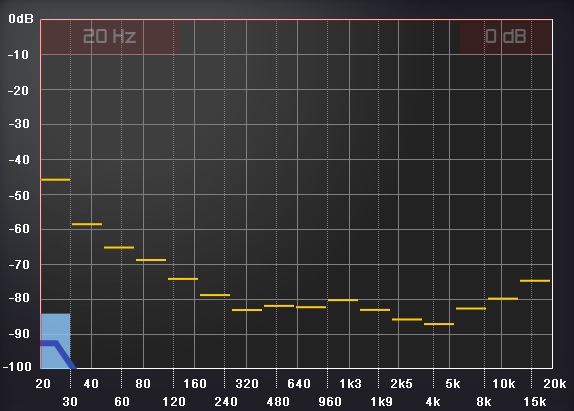

Left seat stay next to bb.
post-36904-0-12169700-1404671910_thumb.p
