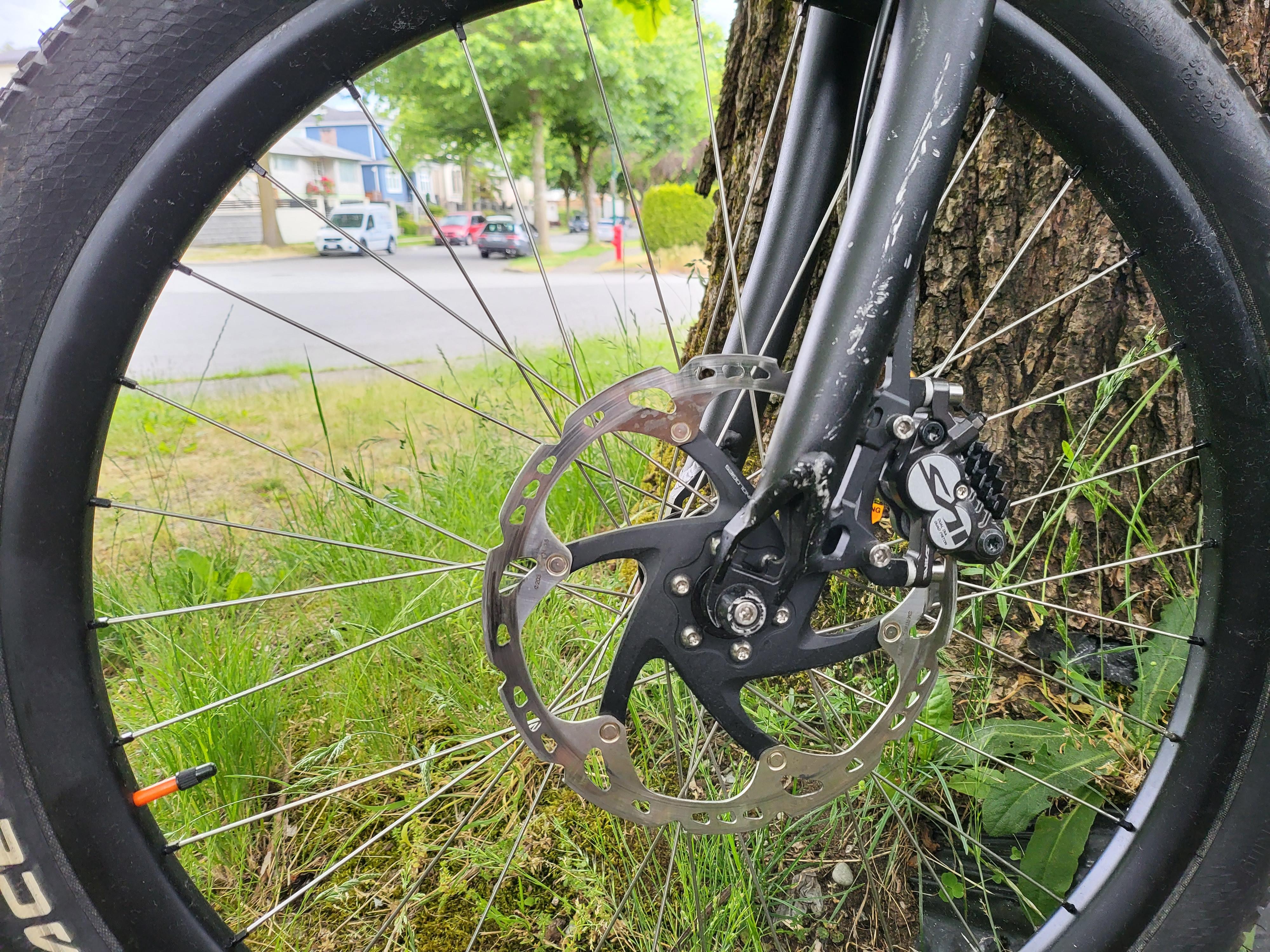

I cannot for the life of me to get the M820 Saint Brake to grab properly upfront.
I have it set with a 8 inch Icetech rotor on a Rockman Spade 26 disc fork. Yes, pads have been worn in since I dragged the brake down a hill multiple times. I am using stock pads.
Things I have tried:
- taking the rotor and pads off for cleaning with Brake cleaner spray and medical alcohol.
- bedding in the pads
The thing is: it can work pretty well when the disc is sprayed with water but as soon as the disc dries, it is back to not grabbing.
I am using stock pads but I have seen people saying great things about Saint Brake even with stock pads.
The brake is bought new, only few months old.
Any ideas for setting up?

I'm with Ali on this one, never had any good results from brake cleaners. I'll use alcohol (99% industrial stuff, not the drug store stuff w additives) if I have to clean the caliper or rotor and even that can be questionable. Flame usually does the trick - plenty of vids on youtube for that. Gas stove or a butane lighter works. From the photo you posted, it does look like something's on your rotor. When it's all working top notch the rotor should look mirror polished on the braking surface.
you are alright, the rotor seems contaminated on the picture. Sharp eyes!
Did you wipe out the surface after spraying so brake cleaner?
