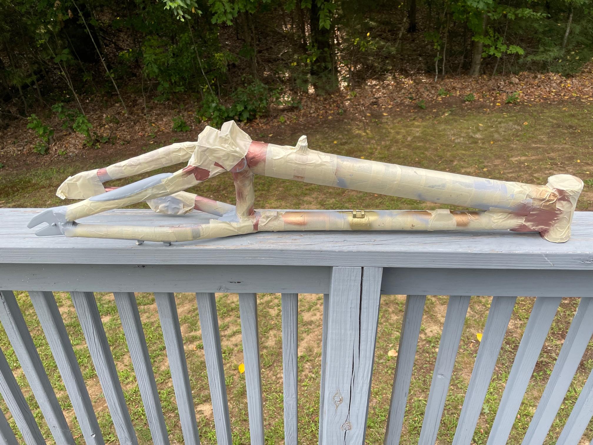

In terms of functional steps, all the above is everything that could be done with what I presently have.
As there will be a lot of waiting for parts to come, so frame will be collecting dust in the meantime, I decided to take advantage and customize the look it by painting a few small parts of the frame.
Making it my own, so to speak.
Picked head tube, seat tube, bottom bracket, bash plate mounts, rear brake mounts, and a portion of the chain stays.
Will use some metallic paint (bronze, brass copper) that I have bought for another project which is on stand by for now.
Masked the majority of the frame with painter/masking tape and applied a coat of metal primer.
Will let primer cure overnight, tomorrow will start applying paint.
Once paint complete will actually post pictures.

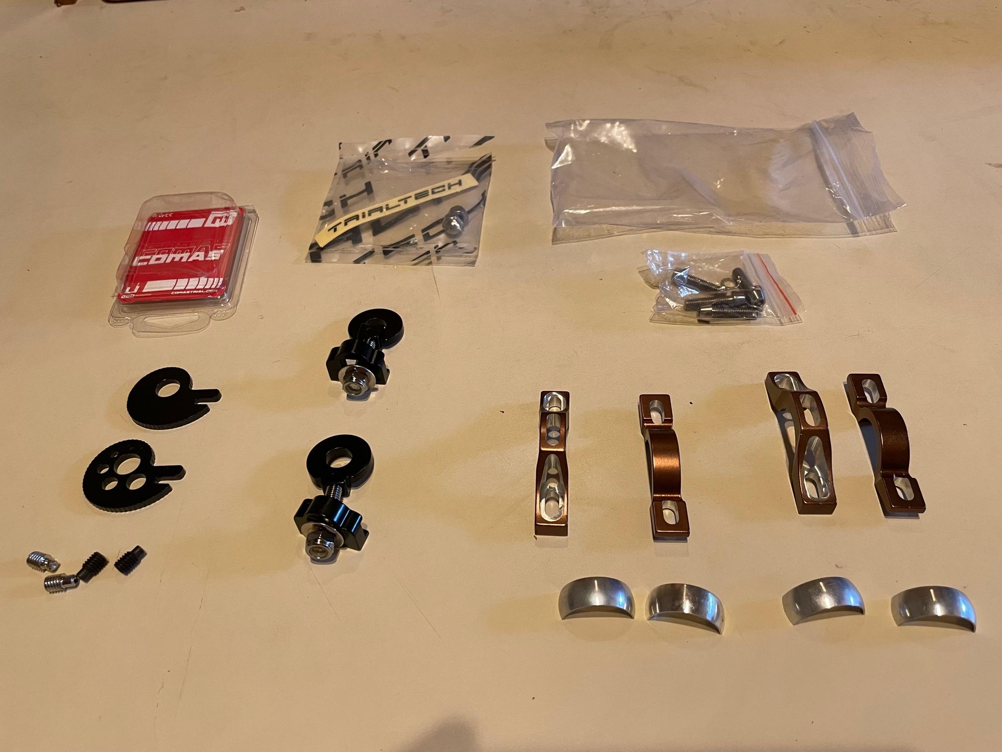

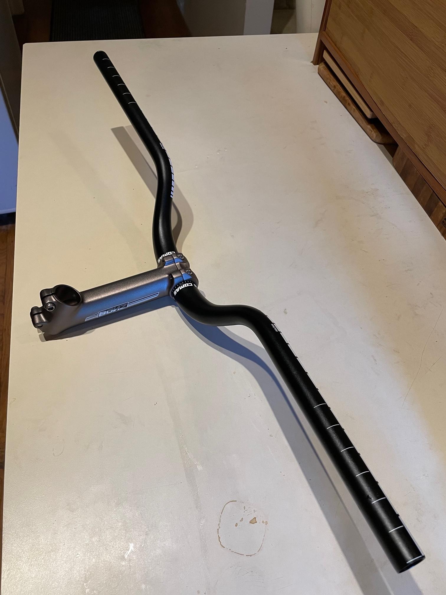

DAY 3
First batch of parts came. Took about 10 days to cross pond. Before I knew any actual specs of the frame I could only order some universal parts that would fit any bike regardless of various standards.
Sn now I have
-stem (Bonz, 150 mm)
-handlebars (Comas, 105 mm rise).
Both sizes were shots int he dark, I really don't know what is optimal, but I had to start somewhere.
-chain tensioners: ordered  both the snail cams (Comas) and the chain tugs because would like to play with both just to see how well each works.
Unfortunately the snail cam bolts I ordered are the wrong ones because I id not pay attention- it says in the description they are M6 as opposed to the M5 that most frames require- I just assumed these things are universal.
So for now having the tugs as an option is great.
-brake clamps- Echo. Once frame is fully painted I can install the Magura HS33 calipers onto the frame

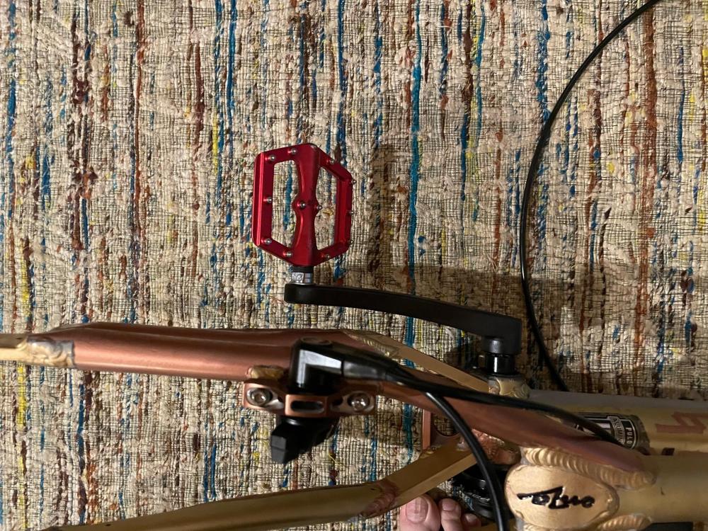

Cranks, front freewheel, bottom bracket.
Down tube not fully painted but I could not resist, had to test everything for fitting, especially that I was worried that the 128 mm BB will be to narrow and it might not clear the chainstays.
First of all, I could not believe how tight the ISIS spline tolerances are, the crank arms needed a lit of coaxing to engage the BB splines deep enough to allow the bolts to catch the BB axle threads, and once that happened, threading the bolts into the axle took more effort than I remember being needed for the other splined BB I used in the past. Build a few bikes using SRAM GXP and proprietary White Industries BB, all splined, and putting everything together is a breeze. Not with ISIS I guess, but it did get in.
To my relief, the cranks cleared the chainstays.
To my annoyance, I initially thought they cleared them too much, and started worrying about chain line. I was in fact ready to order a second, narrower BB (was thinking 108 mm). However, one gentle soul on this forum (aener- thank you again!) pointed out that the extra clearance is good and might be needed to clear the HS33 calipers, and that chainline will be fine. Once I read that I put calipers on, and lo and behold, 128 mm actually felt really good choice.
I will probably leave everything on now that it's on, and deal with the extra tape masking for the last painting day.

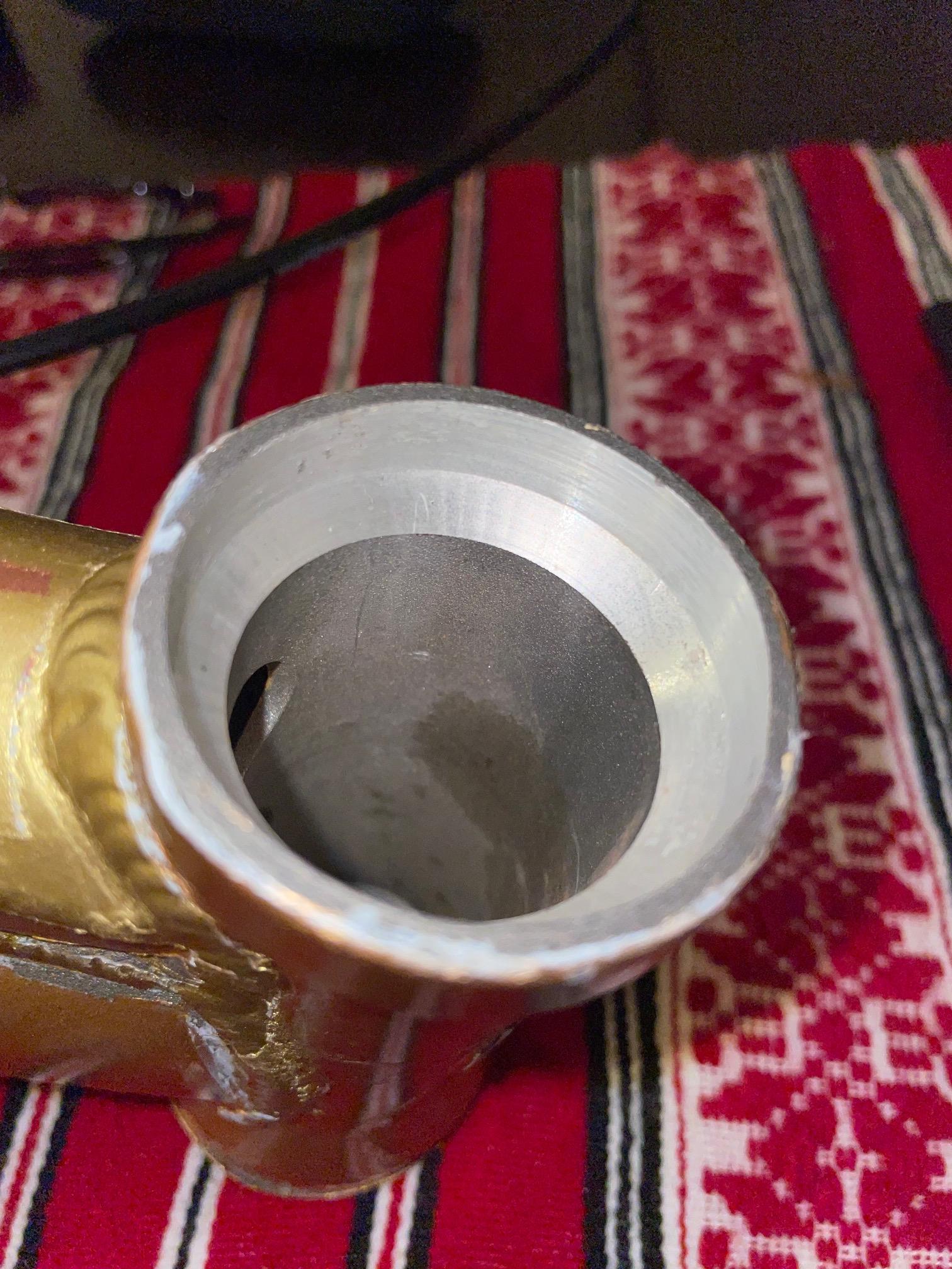

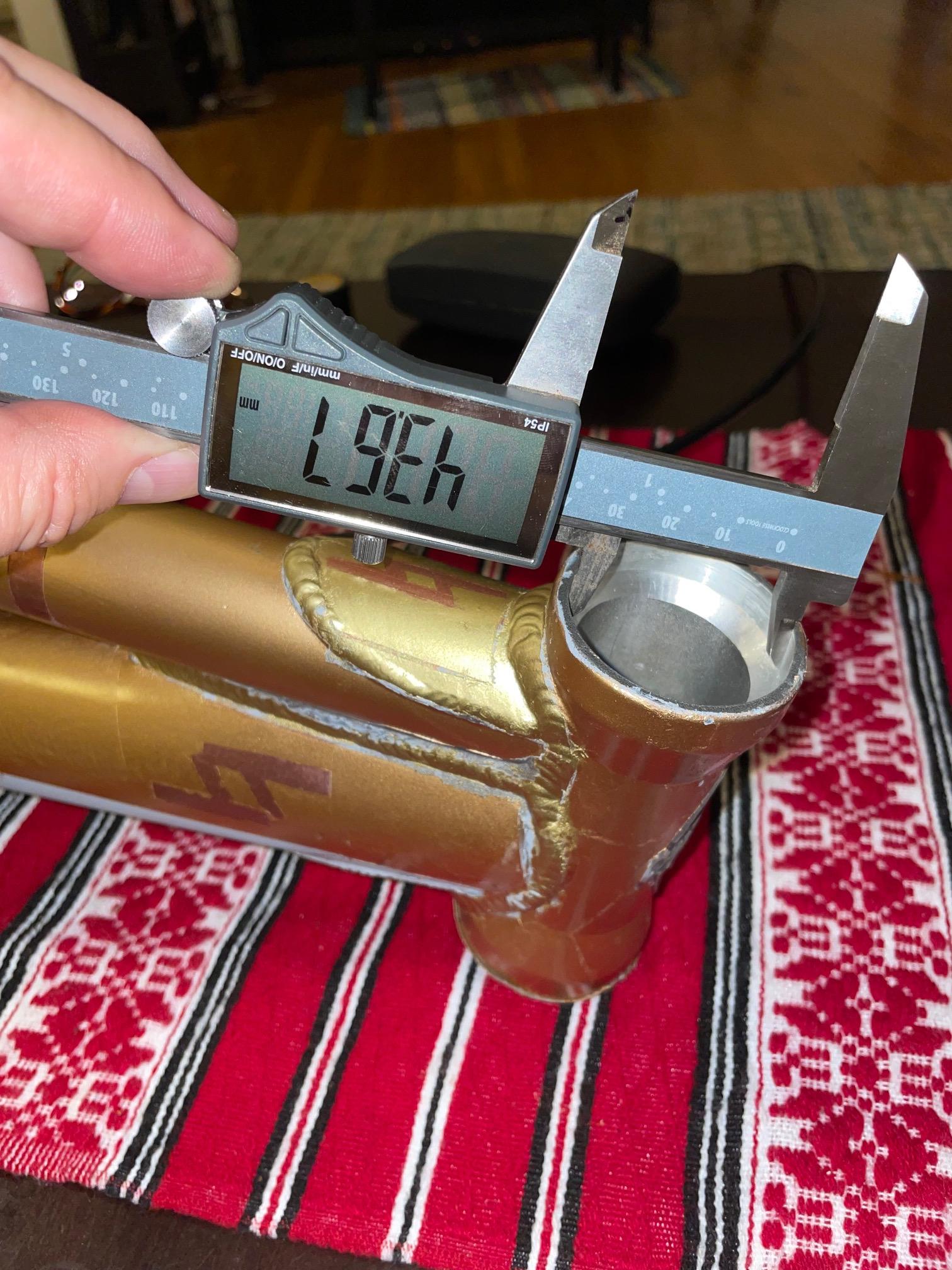

This is a bit of a mystery for now- I have never seen such a headset before on any bike I have built before.
The head tube is milled internally at 45 degrees as all integrated head tubes are. But the only integrated headset standards I know ask for 41.8 or maybe 42 mm outside diameter for the bearings.
This head tube has an internal diameter of almost 44 mm. If you ignore the 45 degree milling you would automatically think internal cups/zero stack headset, those are 44 mm amongst other sizes.
But then all zero stack/internal cups headtubes I've seen are straight inside, not milled as if for a bearing.
For now I will wait for the fork to come (will be here shortly) and use the 2 spare 41.8/42 mm bearings I have laying around to see how that looks like, I am pretty convinced it will work poorly as I will be back at square one trying to figure this out.
I will also start a separate thread dedicated just to this issue, in hope many more people might see that one, rather than these lines buried deep into this already stuffy thread.
Just in case anybody is curious, I included a couple of pictures= sorry for the upside down caliper reading.

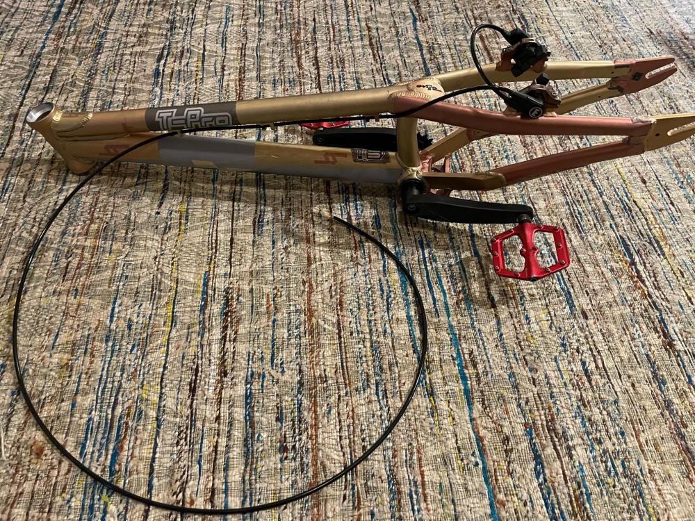

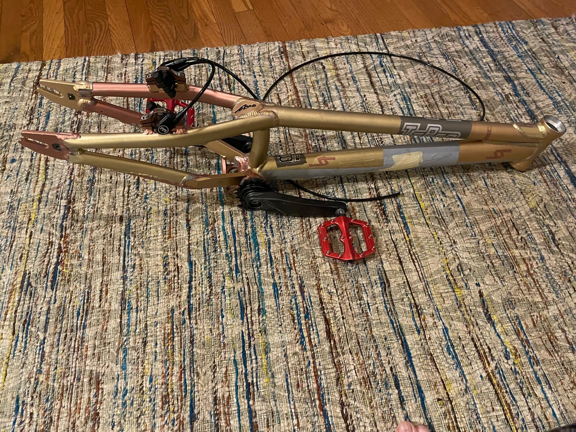

DAY 6
Primer came- frame fully painted.
Does not look anywhere near professionally painted but it was my first time painting a frame (first time painting any metal implement really) and the scope of the endeavor was multifaceted.
One, wanted to personalize the bike-check.
Two, wanted to learn how to paint a frame. Partly checked- the most important thing I learned is that I need how to learn to have patience until things dry fully. I was impatient at times- clear coat over paint too soon, peel masking tape too soon, etc and it shows.
Three, needed to test the three metallic paints I used (copper, brass, bronze). Check, but with surprising results. I expected to like the copper the most, I don't. But the bronze really grew on me. Unfortunately it got the least use on the frame.
I have a Campagnolo Athema groupset I pulled from my road bike (replaced with Record) and I bought a steel road frame to build using that groupset. I will need to paint the frame, and I was thinking of using a combination of the same colors as in the Onza. Seeing the results, I will have to reconsider the whole paint scheme.
Ordered a bunch of stuff from Tarty.
Besides the rim, hub, spokes and sprocket already mentioned: chain (3/32), grips, rim tape, inner tubes, 19" tire (Maxxis Creepy Crawler), brake lever, aftermarket Hs33 pads (at Tarty's recommendation -Coustellier 8mm- as they mentioned over the phone that for only 6 pounds they can grind the rim for me but stock Magura pads are not a good idea with that).
Once all this stuff comes and it's on, provided the headset won't give me much grief, the only thing needed for the bike to be complete is a front wheel.

Ritchey headset came today, I already had the headset press out in waiting.
Once I checked a few cup dimensions by digital caliper, it went right in.
My worries were unfounded, both cups sit flush.
But there is a reason for it, and I had an inkling it might fit based on drawings found on Ritchey website- the entire height of the cups is 10 mm, out of which about 2 mm is the lip (sitting outside the head tube), and the beveled part (the one in contact with the head tube chamfer) is another 2-3 mm, so the straight part had to be less then 6 mm.

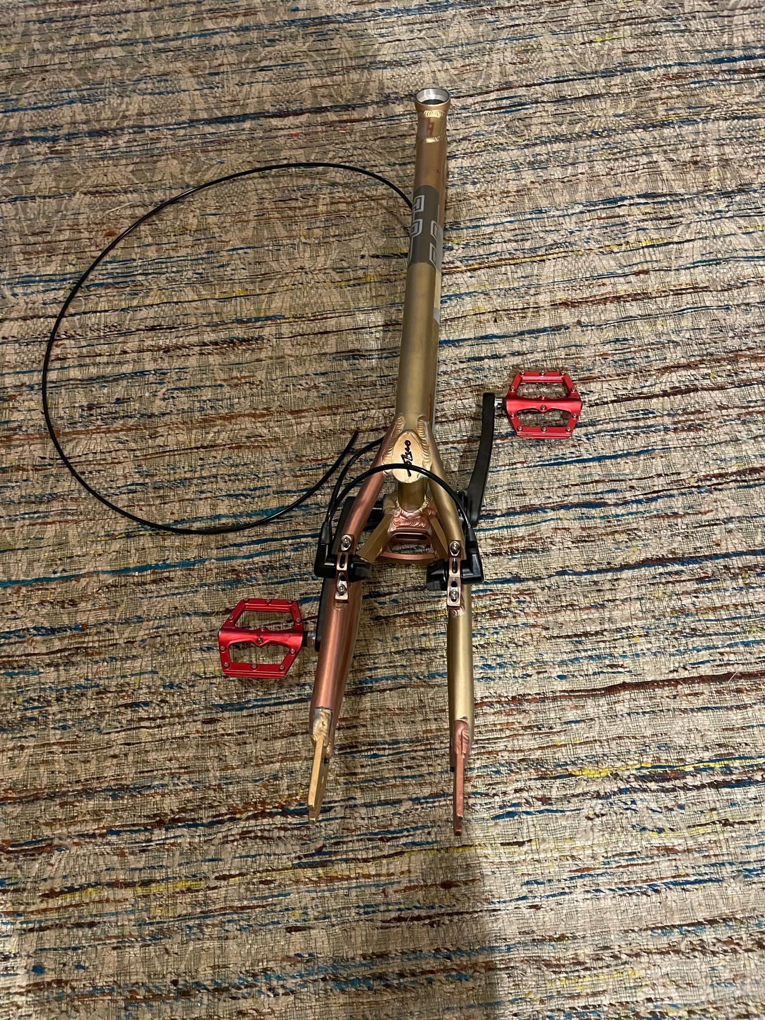

Day 8
Had to travel for work Monday and Tuesday, and as Murphy's law has it, the shipment from Tarty got to my house on Monday and sat in the rain for 2 days in front of the door...
However, Tuesday evening when I got home, I was really excited to open it up! Rear wheel stuff (rim- preground by Tarty- tahnk you!, tire, spokes, hub, tube), grips, rim brake pads, rear brake lever, chain.
Got right into building the rear wheel and soon enough it was on the frame, pads went in replacing the stick Magura ones, brake lever and grips went onto the handlebars.
