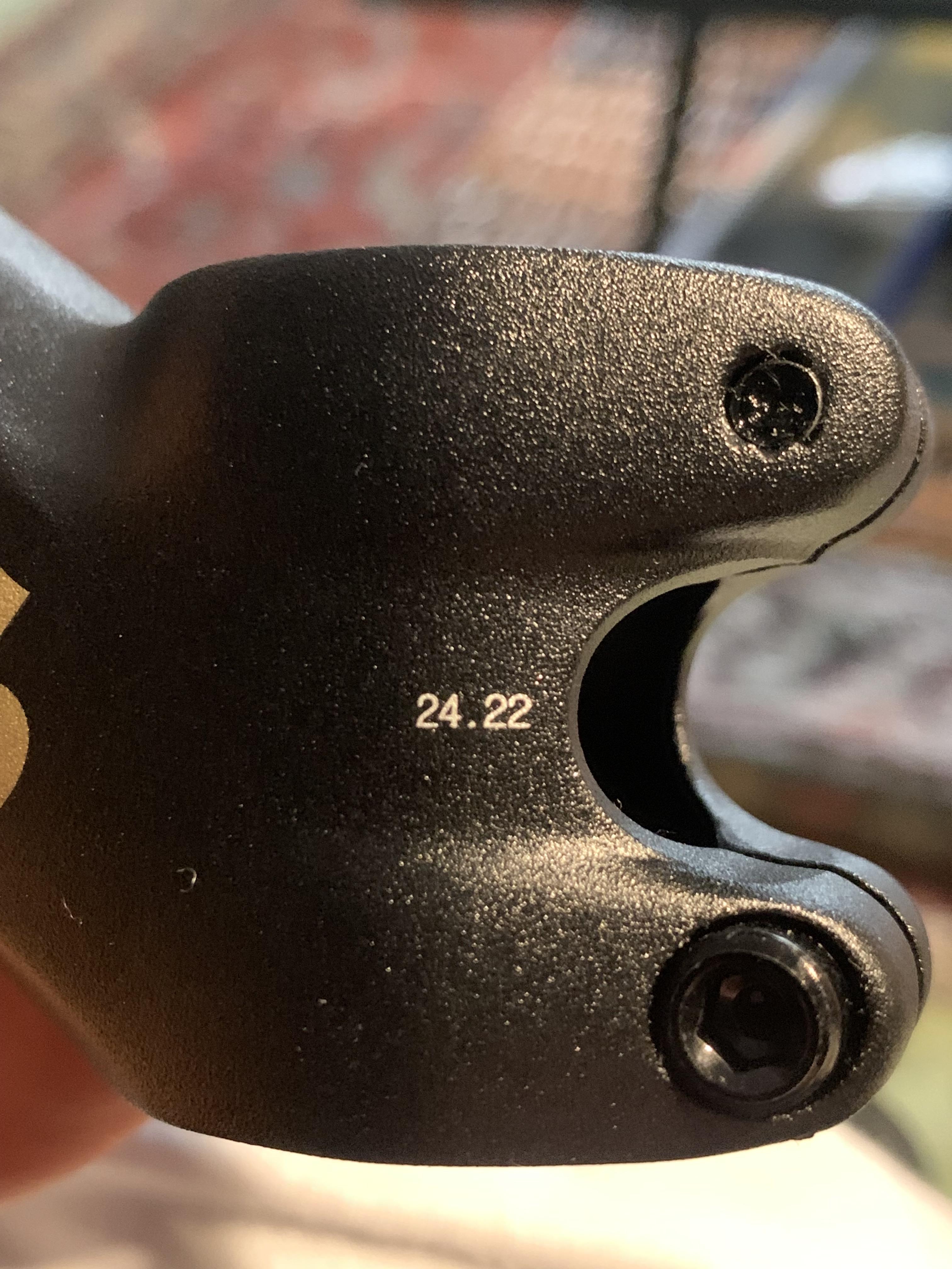

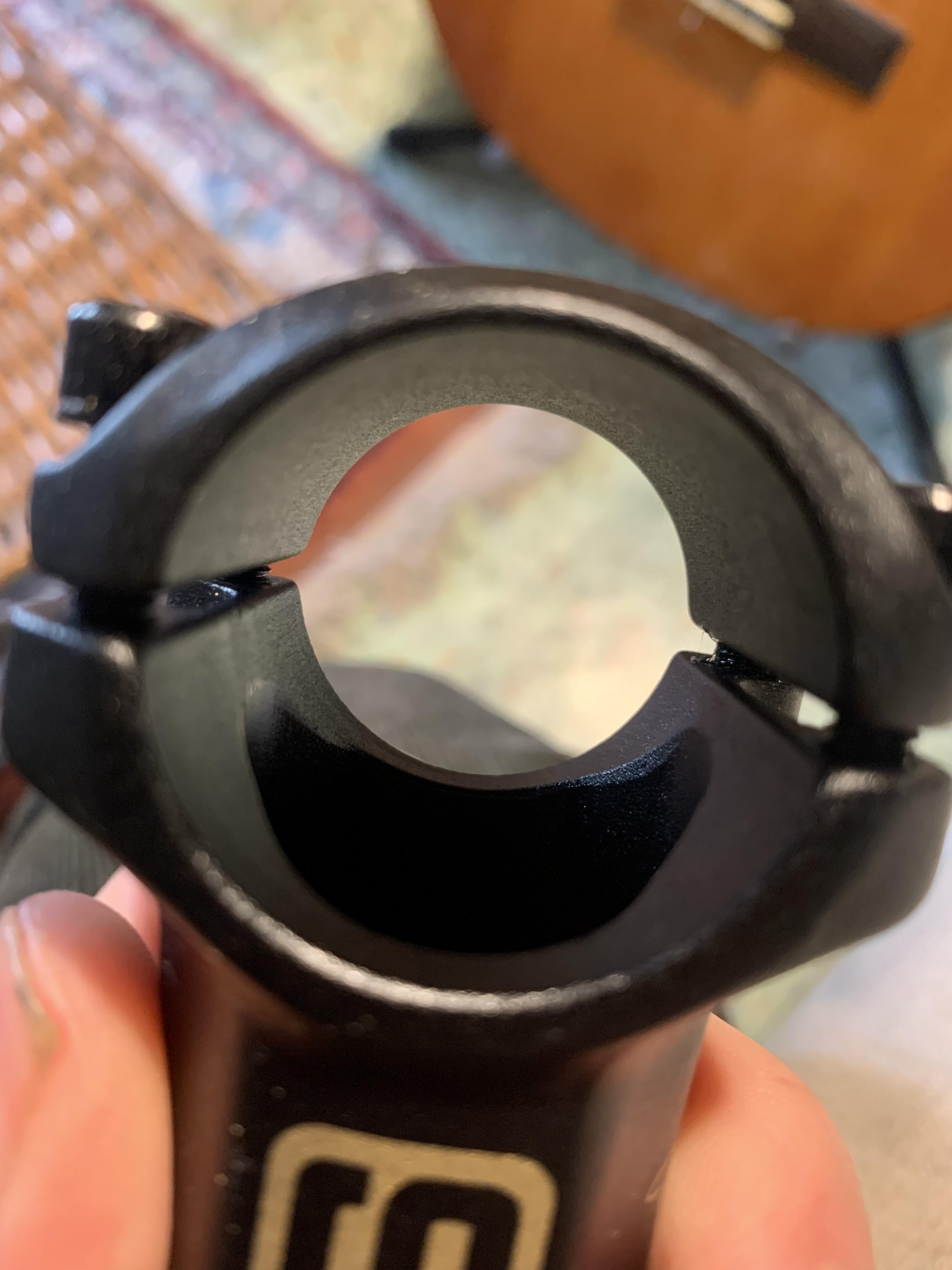

Hi,
Just to say that I was surprised to see that the recommended stem for the respective sqlab trials  handlebars does not have the 46mm minimum clamping area that the company specifies. When I measured it is only 40 mm. My classic trialtech stem is 45/46mm so now it stays. Seems like a wider (in this case) clamping area would be better... doesn't it?
That's honestly hilarious. I'm pretty sure Trialtech is the widest out there nowadays. I'd pay more attention to the torque spec of the clamp and make sure there are no hard edges on the inside of the clamp. Companies love catch 22s to get out of warranty claims.
I agree with you. The max torque is 6 Nm while the max torque that the handlebars admit is 8 Nm. Besides the inside there are no hard edges (fortunately). What do you mean when you say 22s?
