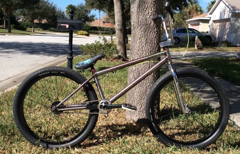

Yeah, good point. People seem to finally be figuring how how to make a 24 BMX that doesn't ride like a cruiser.  The new cruiser coming from Tribute looks pretty interesting in this regard with its 14" chainstays.
