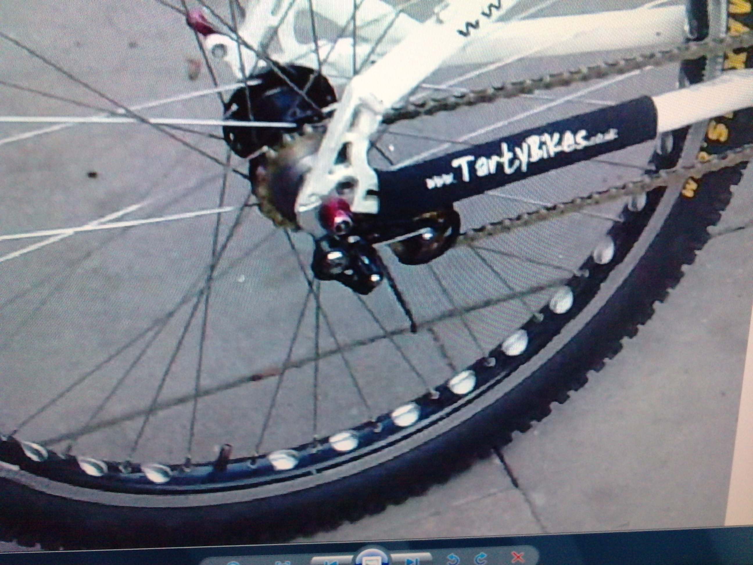

  23. I once drilled out my halo combat rear wheel using a 20mm hole saw. I didnt bother de builing the rim as such all i did was got my rim which was is a double skined rim took the tyre and inertube off marked out the centre of the rim( 44mm divided by two ) gave me 22mm to the center . Then i measuerd from the center of the spoke nipple to the center of the next spoke nipple and dot punched and tiny divit into the rim to mark it out . I then used a 5 mm drill bit to go through the rim as a pilot hole. using a 20mm hole saw i then drilled out the rim in between every spoke apart from where the valve sits and the join in the rim. Mine came out perfect with no weakness to the rim what so ever . Just make sure you get all the metal shavings out of the rim before fitting the tyre and tube as these will puncture the tyre every time you ride. IM guessing that you can drill out any rim as long as its double skined. Single wall rims wont be as strong to start with so i would advise against this . But good luck with it .
