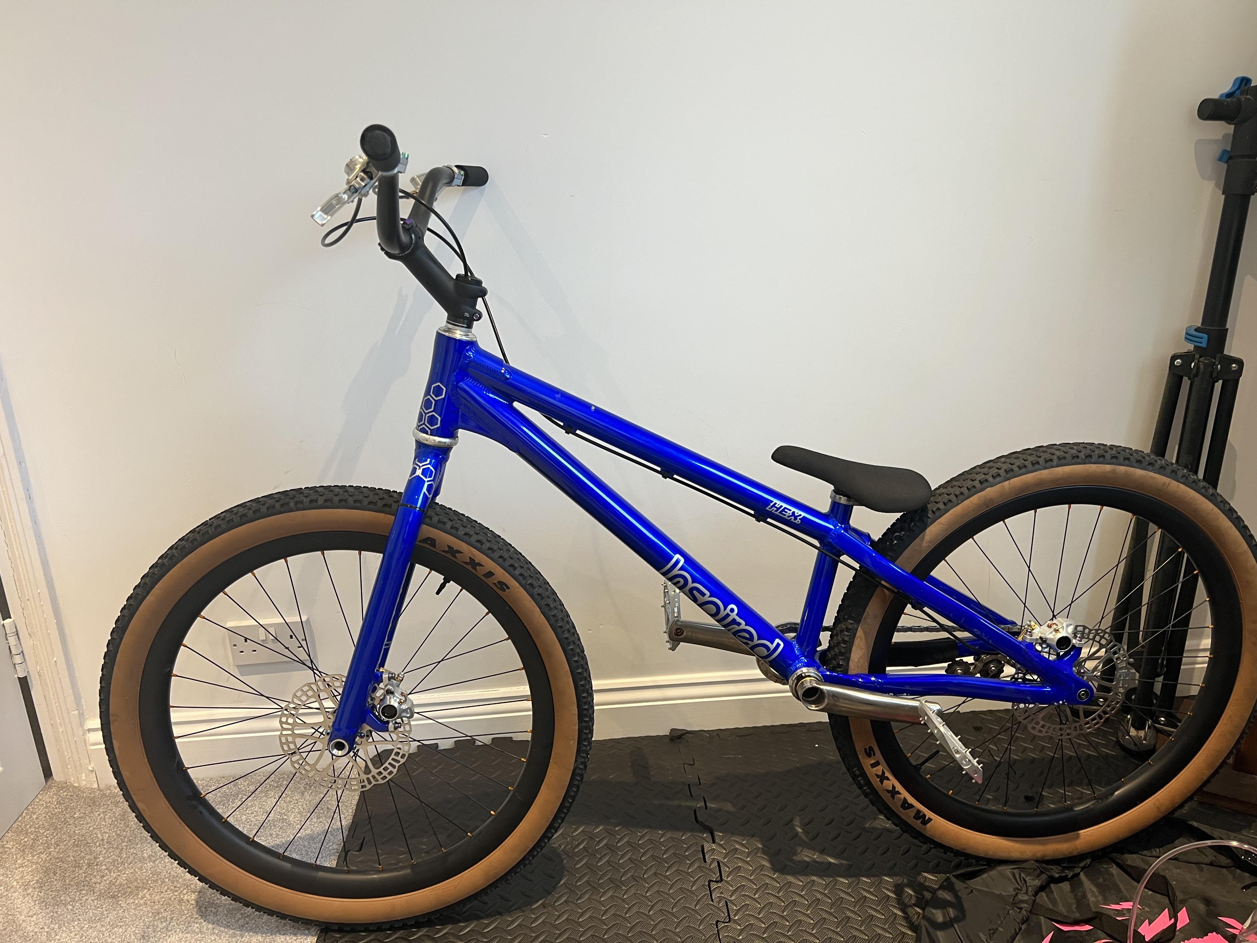

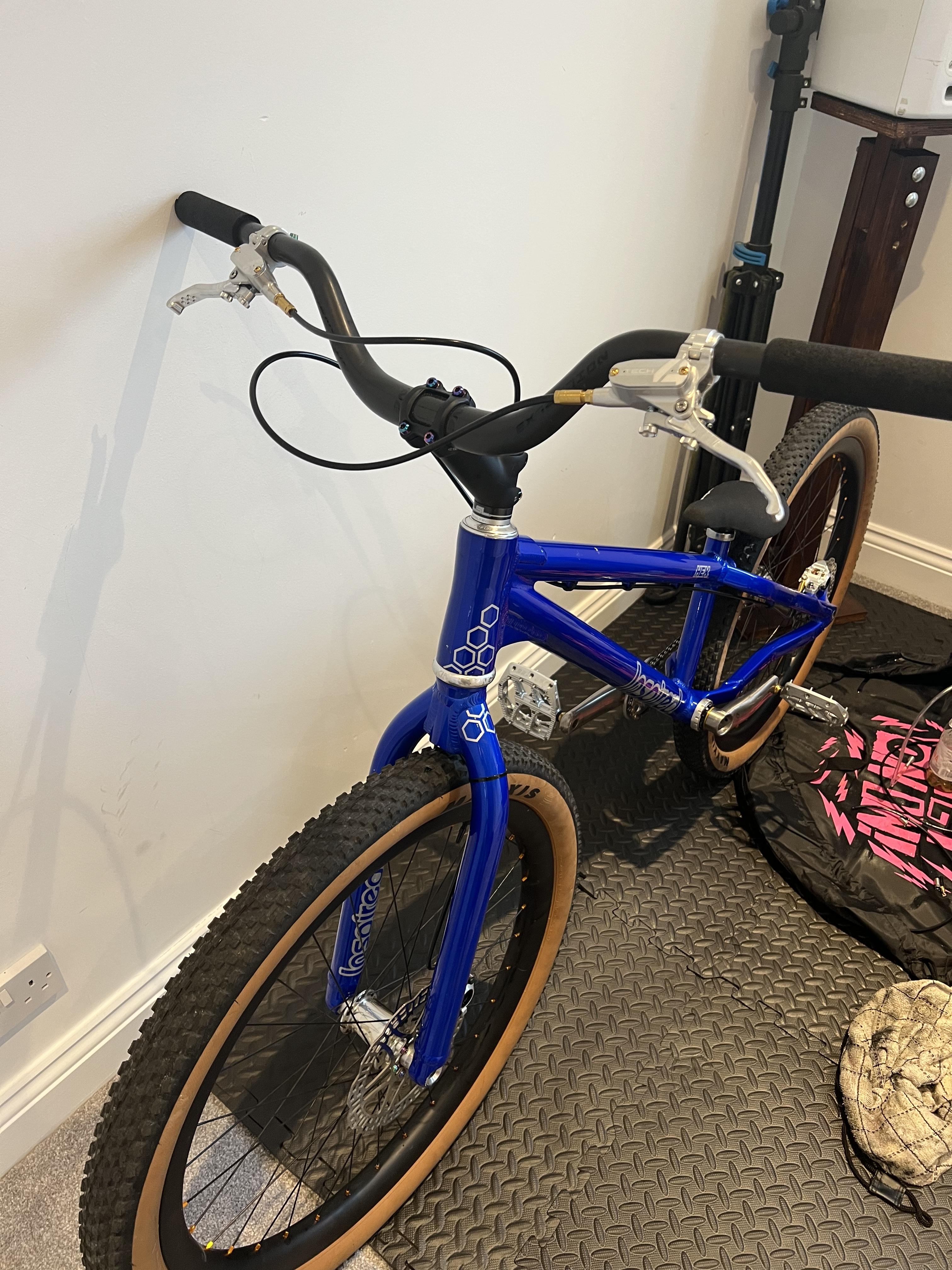

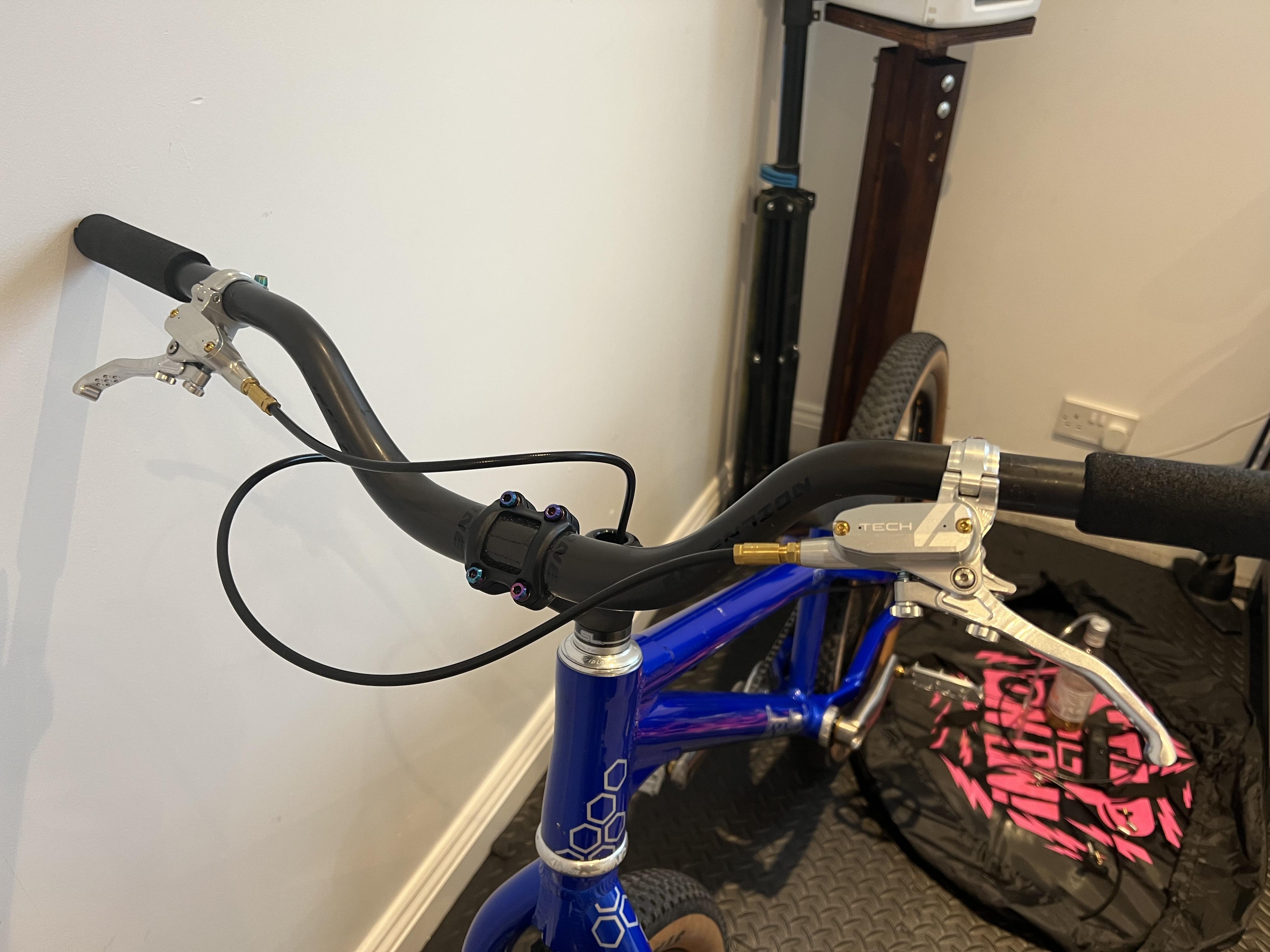

Bought a set of tech 4 E4s and got a pair of trial zone calipers, some titanium bling and jitsie pads. Bit of an arse of a job I must say! Lever feel is really nice, I like the lower profile of the reservoir too.

Been out for a ride, these are absolutely superb. Bit of tinkering with getting the pads square and all of the squish has gone. Was doing a side by side comparison with my mates hex of almost identical spec, he’s running the same calipers, pads + rotors but with tech 3 levers.. both of us couldn’t believe the power of the tech 4 set up especially given they’re not even properly bedded in.
Very very happy
