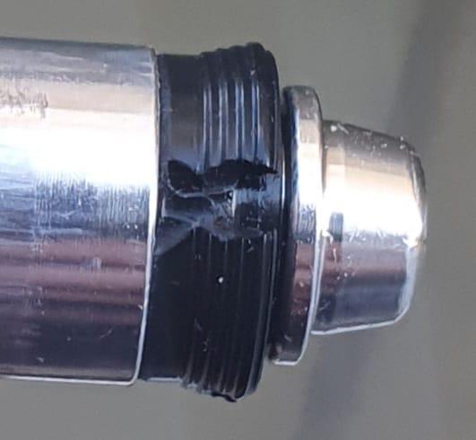

Bore looks ok, only thing we can think of right now is that the seals are slowly getting damaged every time they pass the bleed port up until a point where they can't take the pressure any more and just fail.
Bore looks ok initially but he's going to get an endoscope down there later. I made a mistake earlier, the bike didn't come from Tarty in the end because it was bought at the time when everyone was having major stock issues.
Not sure, I'll ask my mate to take a look and get back to you.
So what causes a seal to blow like this (and in two places) after a very low speed over the bars crash? The lever being pushed in to quickly?
It's a mates lever that it's happened to, he bought the bike from Tarty last year I believe, I'll pass the message on.
Confirmed blown seal on piston in lever. It wasn't even a hard or fast crash, just a slow over the bars. These plastic MT levers are rubbish. I'm personally switching to Hayes Dominions before this happens to my set.
Thanks, possibly just needs more attention when bleeding then, either that or damaged seal on main piston?
Thanks man, any idea exactly what fails inside when they take a knock?
Not mine but a mate went over the bars earlier and now his back brake doesn't work at all, lever to bar with zero resistance. No visible damage on the outside, no oil leaking anywhere, everything done up tight etc. Tried a fast bleed then a full bleed but exactly the same. We've decided he probably needs a new lever because the internals are not serviceable but does anyone have any idea what could have happened as I'm curious? He's going to take it apart but hasn't as of yet. I'm wondering how an internal part got damaged so badly without any significant visible damage. Aso I assume nowhere sells the actual master cylinder without the HC3 lever blade? Not having to buy the blade would take a chunk out of the £98. Aso anyone know if an MT5 lever would work with an MT7 caliper?
