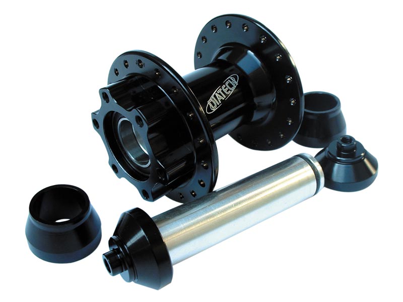

if its a 20mm bolt through hub it'll look like this:
you can dmr revolver 20mm bolt through but a standard dmr revolver comes without a quick release and 2 M5 bolts that keep the wheel in.
either way it sounds like you've stripped the threads but i find that hard to believe cos the bolt should screw quite far into the hub to stop this, unless there shorter bolts your using? post a pic if you want cos i dunno exactly what you mean...
but dmr should be able to sort you out with replacement parts if you ring them.
